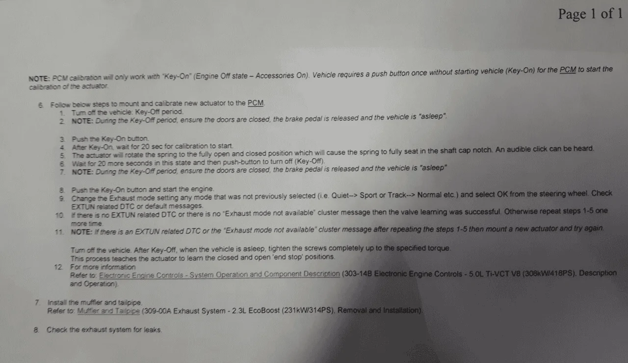

I've been lucky and never had to do it, but here it is :
I know it has helped some, but not others ...
Good luck !
WD :like:

Thanks I’ll try that when I get home

I tried to do it but never heard any valve movement. and wouldnt do what its supposed to do. But after driving it and then trying the modes it then worked in every mode.
