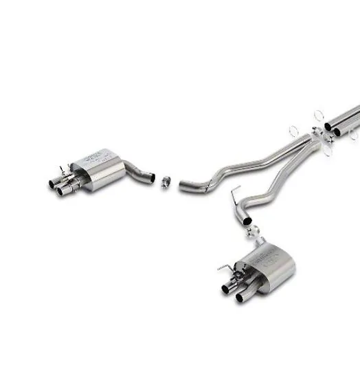

All things aside, just have the shop take a page out of the FP GT350 cat back. just weld on some same diameter bent pipes that can get the exhaust into each housing. this would help prevent any melting or complications leaving exhaust cut too short.
So you will at least have exhaust coming directly thru each tip cover.
Also maybe do high temp black VHT paint on the piping and the GT500 tip brackets to hide it better.

yeah they should just add fabricated bent pipes welded to enter each tip.
Did you also get the gap fixed above the valance? it looks like clips might not be fully seated?
