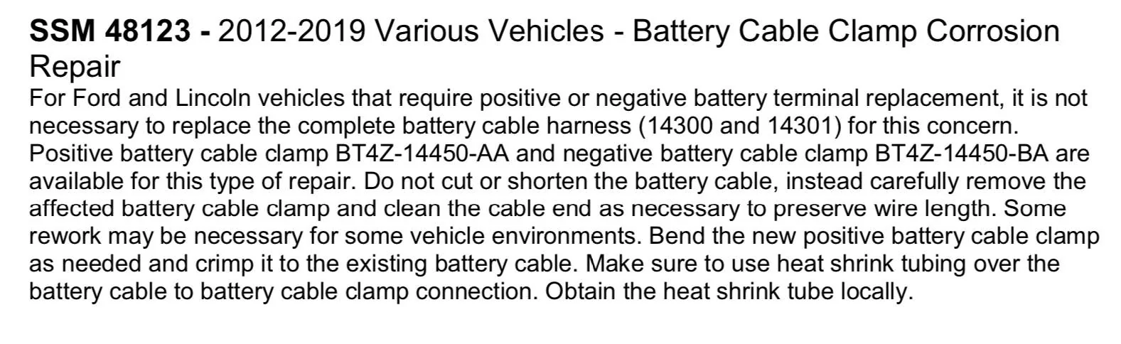

Cobra Jet
Feb 12, 2015
771
17,559
19,992
Ford does know about the issue, see attached SSM 48123, applicable to 2012-2019 vehicles:
