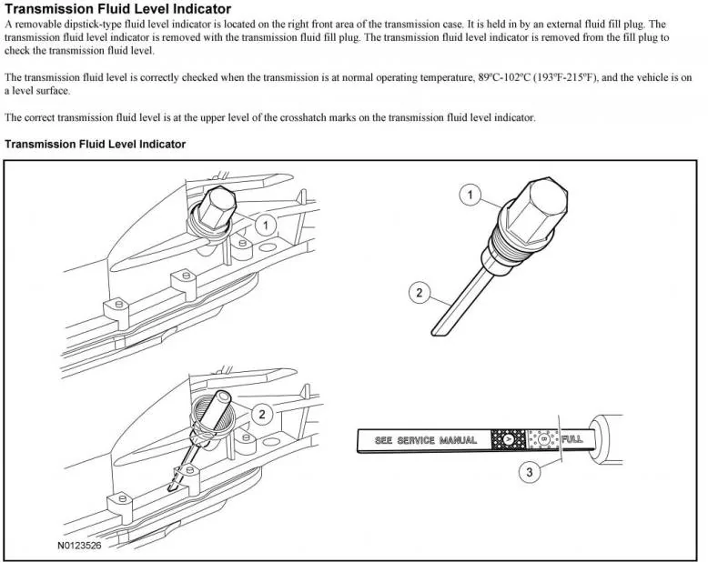

You either say you would like to see it while they are performing the check in the shop. Or you have them physically bring you the dip stick. When my dealer performed mine they actually brought it out to me without asking. If they refuse to both of these then take it somewhere else. Do NOT let them show you a picture.

its a little one in the case, but its still a dipstick.
that being said, if damn near contemplated cutting a hole in the passenger side trans tunnel to reach the damn thing lol. Ford really seemed to have fucked themselves by both not adding a real dipstick, and shipping them with low fluid.

There is absolutely a dip stick. It's just attached to the fill cap. If there wasn't a dipstick how would anyone verify the level is correct?!

Ended up swinging by the auto shop that does my inspections and other small work I don't want to do and had them check it and it was a quart low. They are good dudes, even took me into the garage under the lift and showed me the dipstick. It was just under the 5. They added a quart and it was right on the 4 mark. So far not having the weird issues but it's only a couple miles from my house so not a great test. We were shooting the shit about how many of these have been 1-2 quarts low. One of the mechanics worked at the Chevy dealer and he said even the new C8s are shipping 2qt low. So I guess it's not just Ford.
They took pictures of everything and printed out the dipstick part of Ford's manual and showed everything in detail. Even took a pic of the jug of oil showing it was the right fluid and done to the letter of the Ford spec. They told me I should try to get reimbursed by Ford for the work. I didn't even know that was a thing and if it is, I don't know how to even start that.
