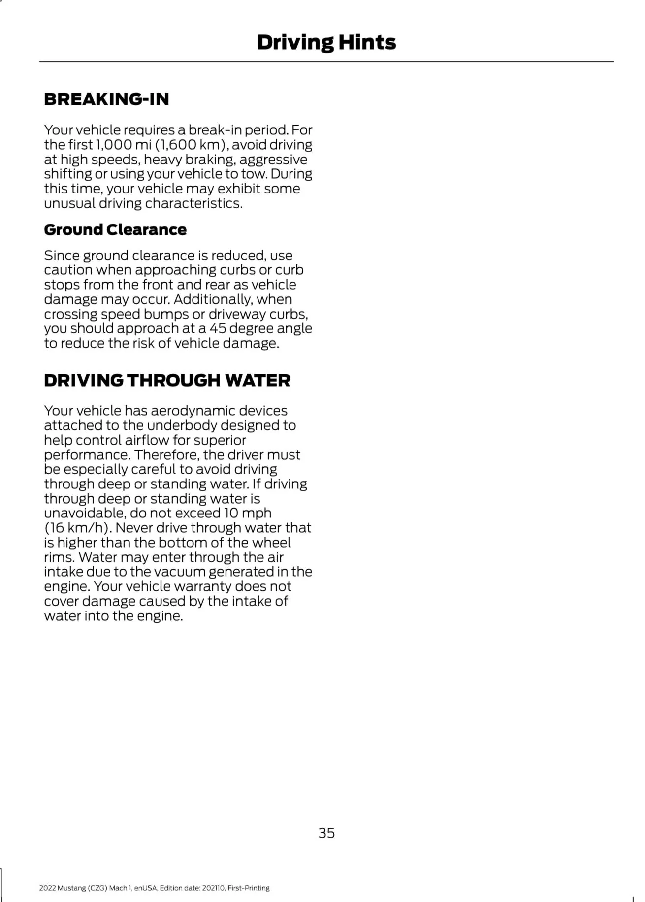

MPGainer
Apr 7, 2023
Philadelphia
2022 Mach 1, 2014 Porsche 911 50th
It doesn’t say don’t use Track mode specifically, but Ford is clearly suggesting to take it easy for 1,000 miles.
