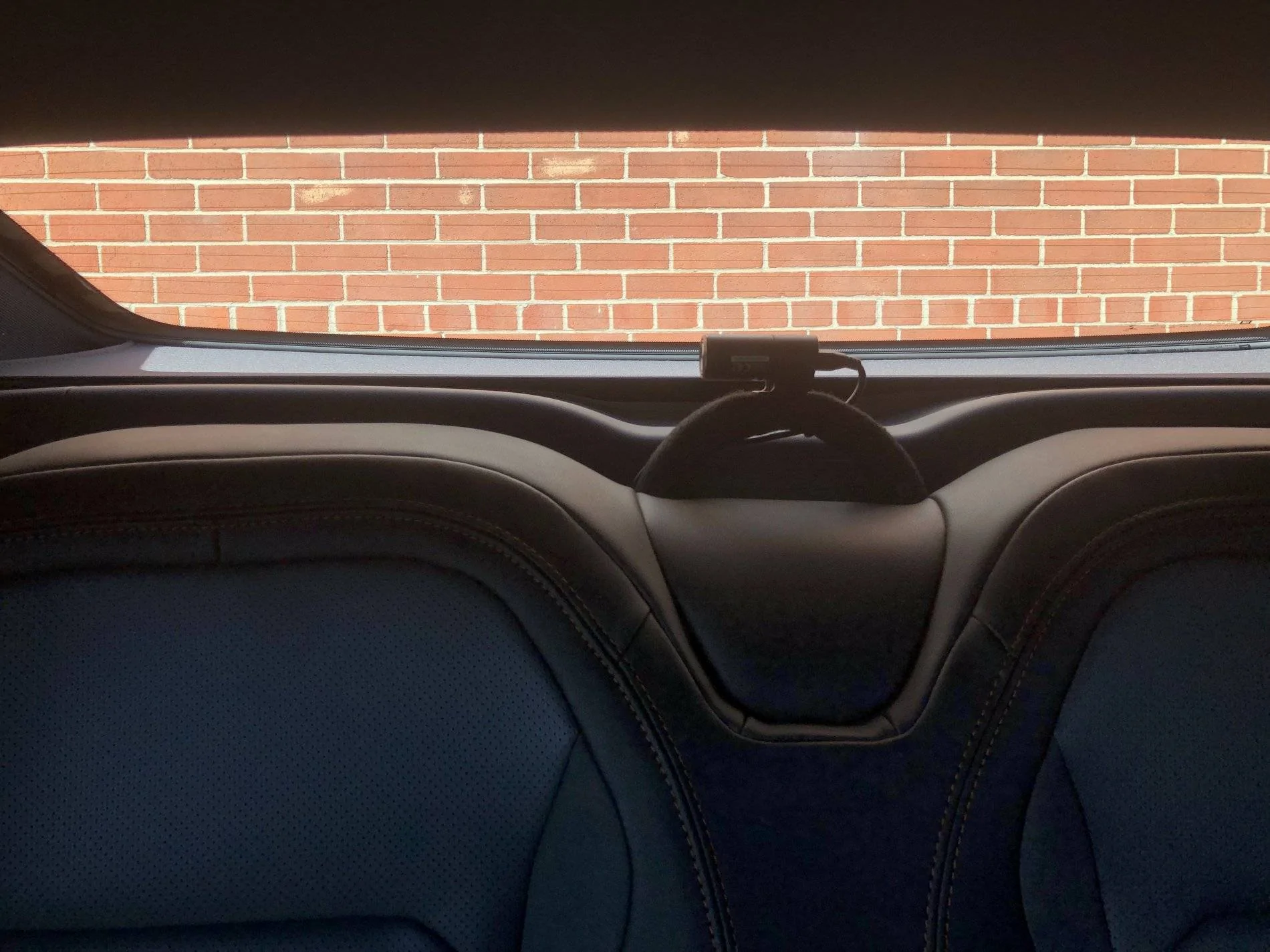

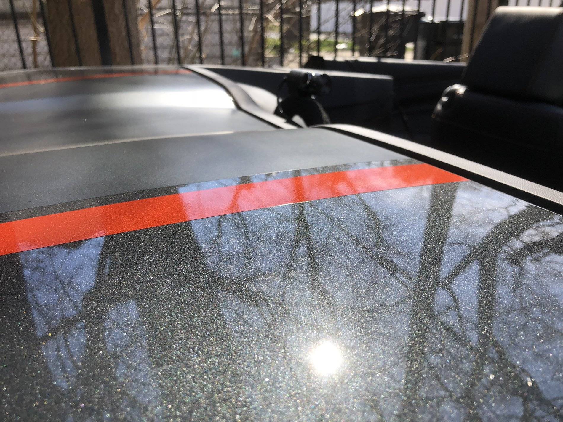

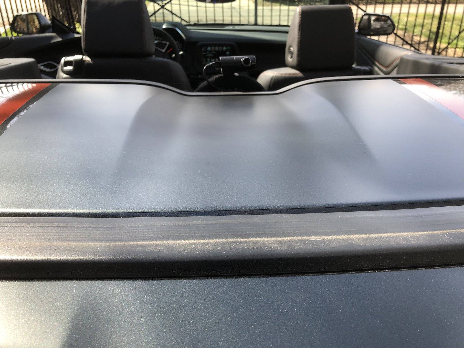

Where do you have the front camera plugged in for power? It looks like a long run to snake the cord all the way down to the 12v cigarette power down below the center console.
If you get a dash cam hardwire kit, you can tap into the passenger footwell fuse box. Make sure to match the kit power plug type (mini-USB, micro-USB, etc.) with your camera. I tapped into the SYNC fuse (#32), as I wanted the camera to stay powered when the car is parked.
