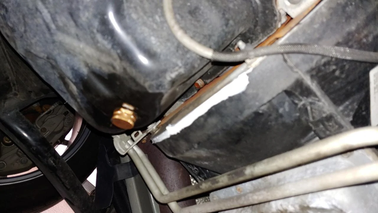

So I banged on the exhaust with my palm under the mid pipe and still heard a rattling noise. It turns out the inspection plate / flex plate area of the 6R80 is rattling its ass off. That HAS to be causing me some false knock so unless someone has some better idea I'm going to stick some dynamat across where they meet and heat it up into place I guess. It's a bad rattle - check this video out.
If anyone has any thoughts about why this is happening and how to fix it - please let me know. This is my first auto trans car but that rattling can't be normal.

Someone made a suggestion that I use some black RTV to shim up the gap and stop the vibration. That would probably work fine and be easier to remove than the dynamat pieces I had already stuck to it before I got that suggestion lol... but the good news is I don't notice this vibration anymore. Onto the next rattle and buzz now I guess!

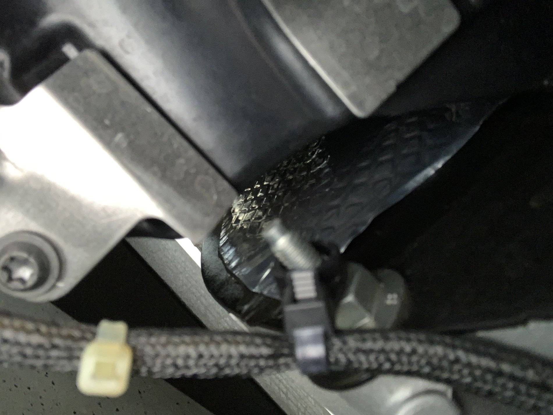

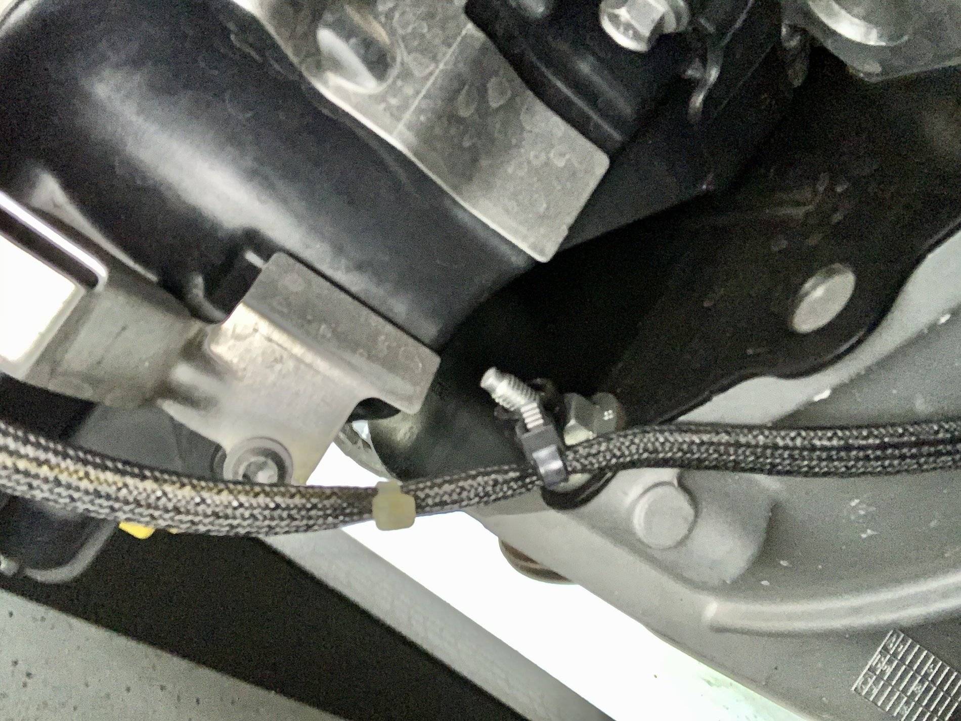

Fixed this on my car today.
There only appears to be two bolts on the upper sides that hold the plate on, which also hold brackets for hoses/wiring. The rattle comes from the lower middle portion from it vibrating on the trans housing. I put a flat head screwdriver in and bent it outward a little pulling it away from the trans housing and that fixed it. I still put a bead of silicone in there as well though for good measure. No vibrations or noise anymore.
Please excuse my blurryness and dirtyness lol. I squeezed a bead of silicone in the gap and then pushed/spread it with my finger which is why it looks the way it does.
