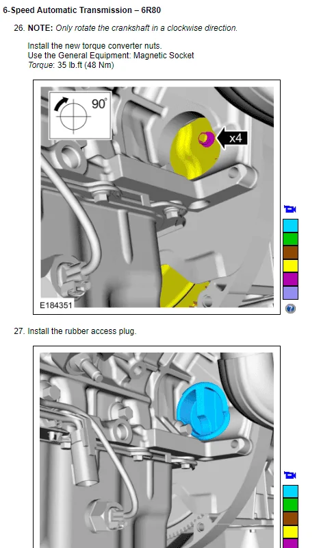

Technically they are nuts.
I recommend removing the bottom plate cover for the transmission and using your fingers to start the nuts there. Then rotate the plate so the nuts show through the access hole where you can torque it to spec. There are 4 nuts in total.
Torque spec is 35 lb.ft
Only rotate the crankshaft clockwise
Here is the snippet from the service manual (I found this in engine installation section).
