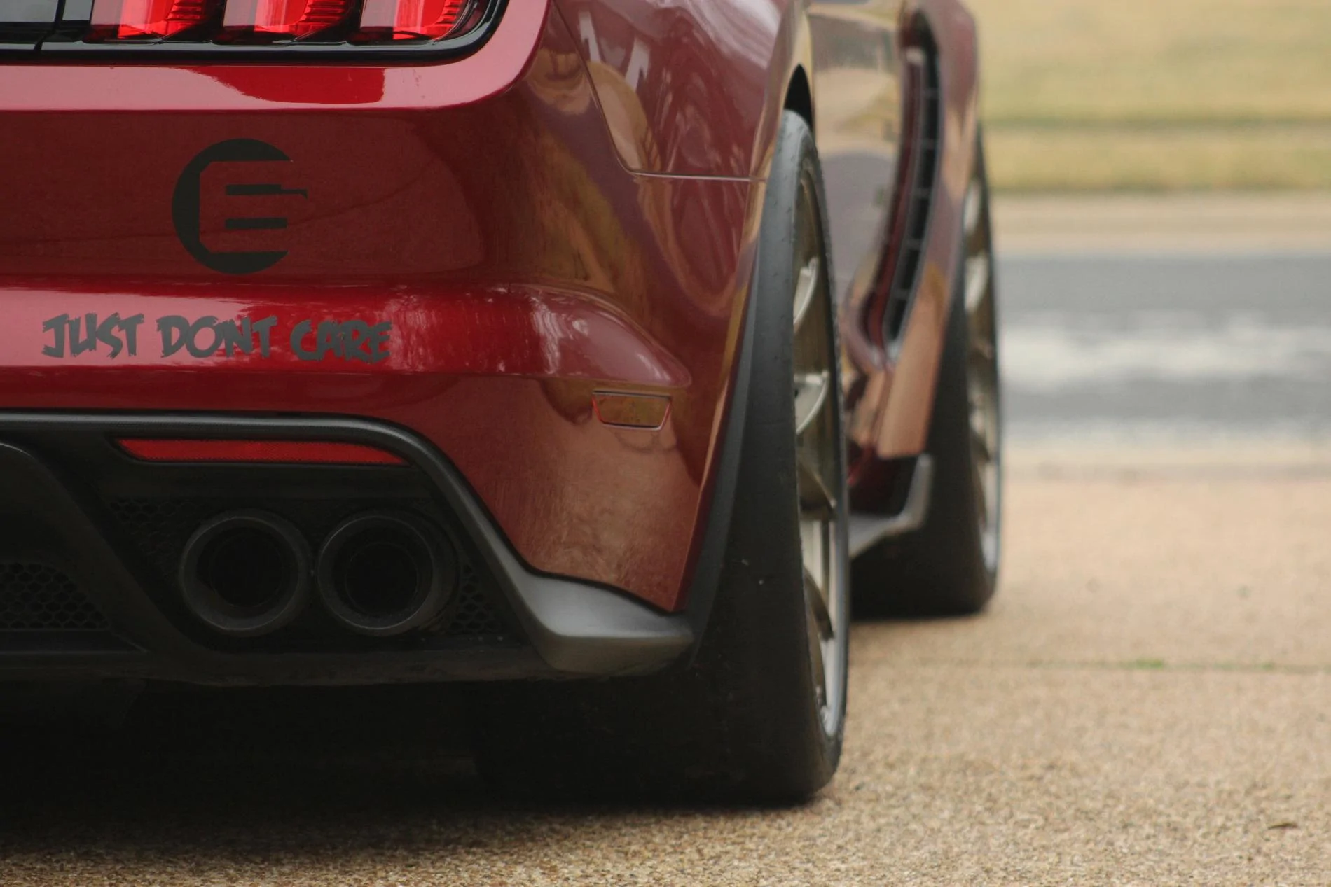

Are you saying that this picture is not with factory alignment?
honeybadger
Just don't care
Apr 20, 2016
63
4,122
7,498
COTA
Kevin
'17 GT350
About 95% confident that's with a degree or more negative camber. For reference, here's mine on 19x11 and Hoosier 315s at -2.5. Hoosier 315s are VERY wide tires.

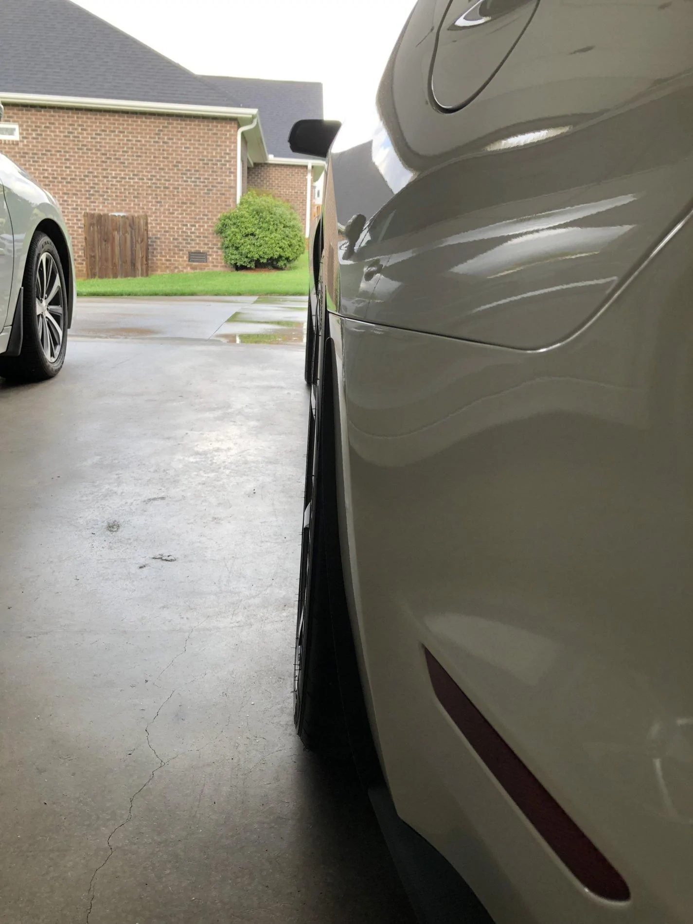

are those sve r350 wheels???
Completely stock alignment. Nothing but a wheel swap
...and lowering springs. The tread of my 305's on R-Spec widths and offsets tuck in nicely with the extra added camber from the lowering springs in my mind.

2017 GT350 Oxford/Blue
Yeah, it's on springs. I stand corrected. Still don't think the wheels would stick out past the fender.
