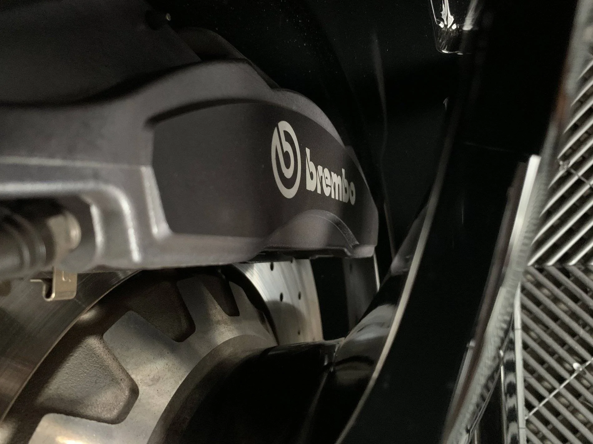

The caliper clearance is tight.... and likely at some point a rock will scratch the barrel because of that... HOWEVER... unless you are cleaning the barrels of your wheels, the brake dust is going to hide all that anyway. My calipers look worse from the heat on track than they do from any scratching from the rocks, so I don't really care about that aspect.
Depending on what you want to do with the car and how picky you are about that kind of stuff you may or may not be happy with the wheels.

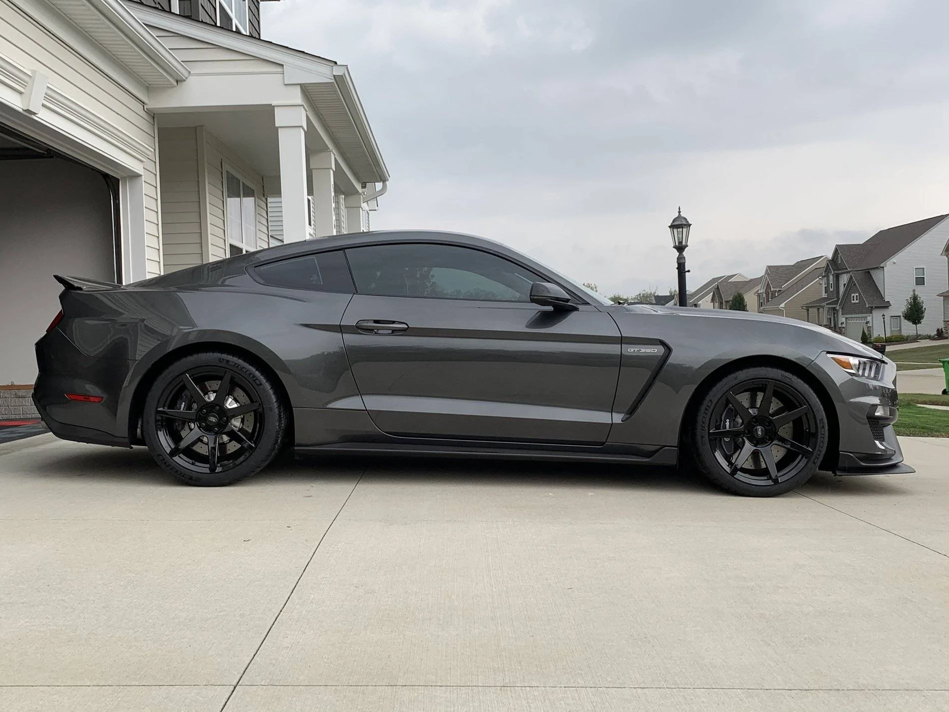

I had the 7-spoke ones on my 16 for around 11000 miles and never had any issues with them with just street and highway use.
Caliper clearance was tight, but I liked the way they looked on the car.

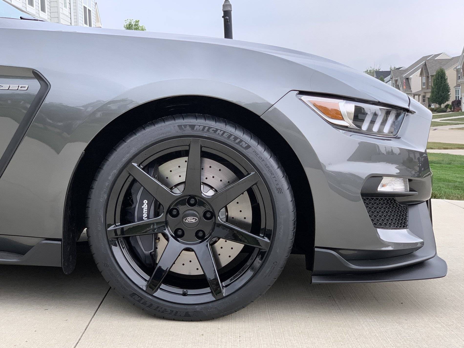

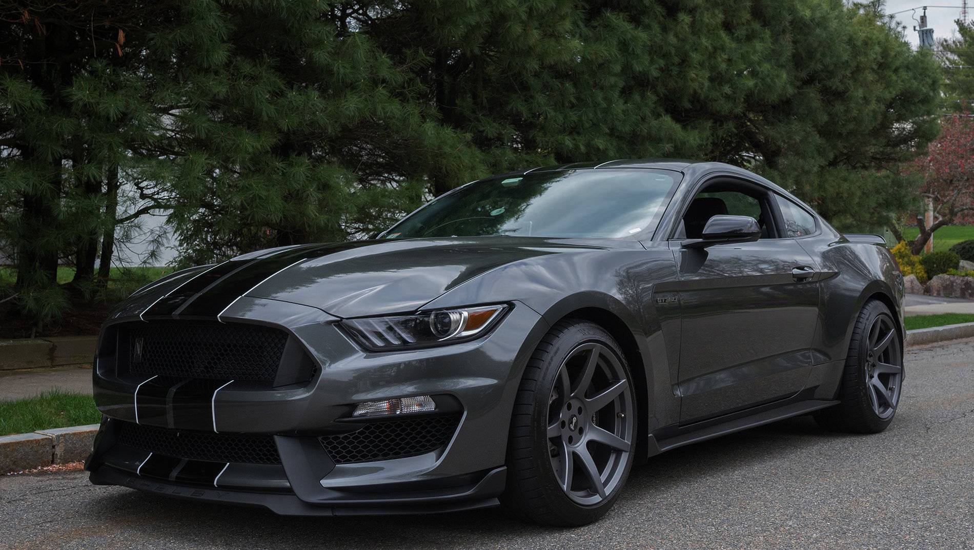

I also owned a set for 10k miles, and I did get one rock stuck on my track pack with 6gr wheels. But I got the same problem with my cf wheel on my R, so....
I recommend the 6GR wheels. I think they look better than the other fully forged wheels, just being so concave... I tracked them too, no issues. I love the look:

I had them and would not recommend them. You will have a caliper clearance of about the width of a credit card. Rocks will get in there and will chew up your calipers and wheels.
They are cheap and if you dont mind what comes along with a cheap wheel, then you will have no regrets.
+1
And, I'm the guy that bought the 6GR's from Tomster! My CF's are wrapped up in felt-lined wheel bags all safe and sound. I wanted an affordable replica to use as a street replacement. Tom was very clear that the caliper clearance is razor-thin - he wasn't embellishing. I have noticed small pebbles sometimes get lodged in between the caliper and the wheel barrel, but so far I have had good luck with them and I regularly check all four when I am raising the car up on the lift.
I even went as far as reaching out to the Project 6GR people via email and the owner called me directly to discuss my concerns and reassure me they would stand behind their product in the event the barrel gouging damages the wheels. It was a very positive experience, and I respect what Project6GR is trying to do.
That said, would I do business with Tomster again? Absolutely, without a doubt, great guy. Would I buy these wheels again? Probably not.
