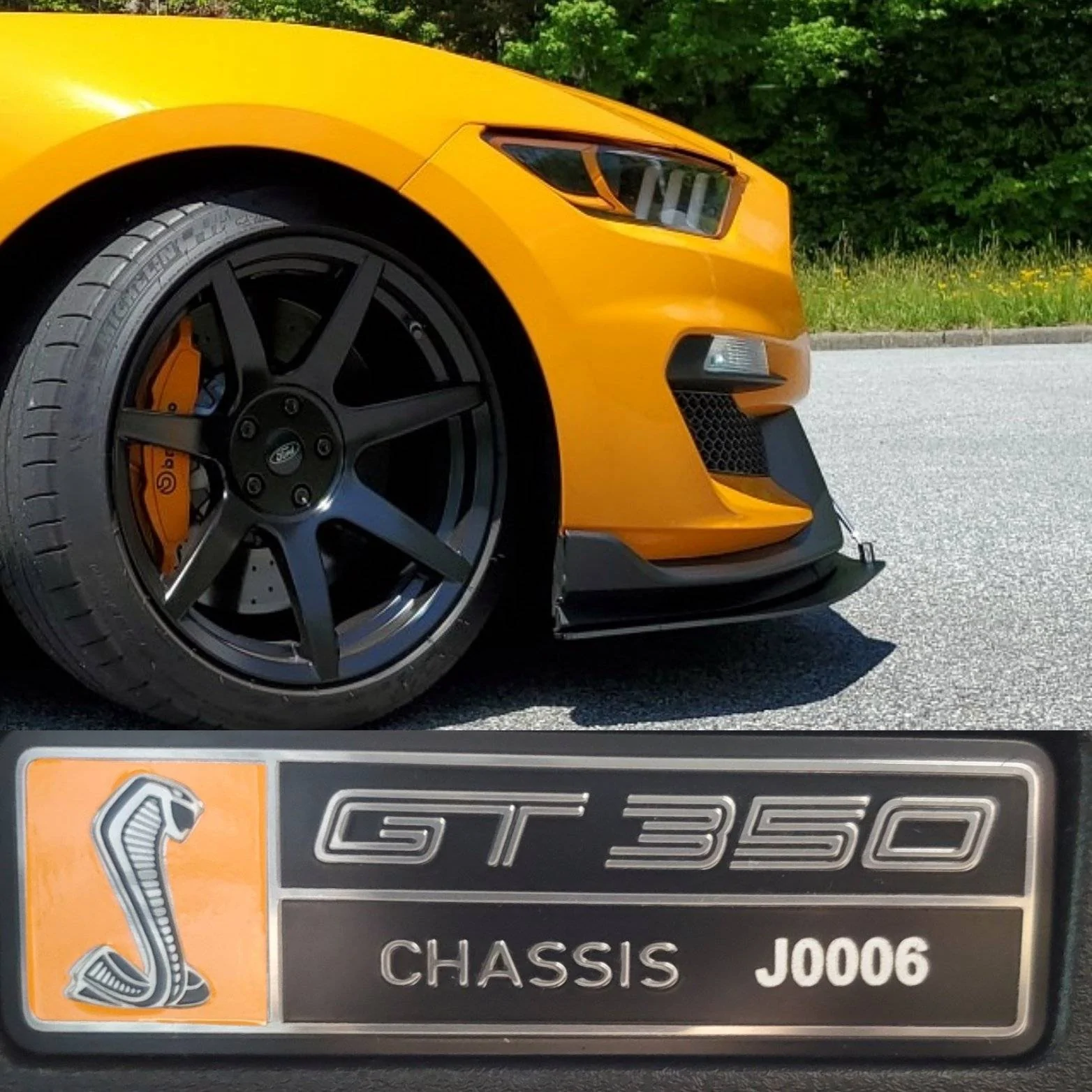

8500 miles on my Project 6GR Seven's and I haven't had any rock issues at all. Not much less clearance than the factory wheels to be honest. To me it all depends on your budget. At the time I could have either gone with a set of 19" signature wheels, or get the Project 6GR's and get the car restriped, locked down with Steeda bracing, lowered and tightened with the Ford Racing springs and Swaybars, and do a number of other interior and exterior touches to make my car stand out.
I also was a big fan of the super deep concave faces front and rear on the Project 6GR R-Spec wheels so that's the way I went. I do want to change up the lugnuts on mine to a different design, but otherwise very happy with the satin black finish and even re-striped my car in satin black stripes to match the wheels.
Caliper spacing and side profile
You can really see the concavity front and rear in this picture
Another pic showing the concavity prior to me re-striping the car
splitters by Kyle Mavis, on Flickr
I also liked having the ability to switch back to the Ford center caps as the red logo center caps that the wheels came with clashed with my car.

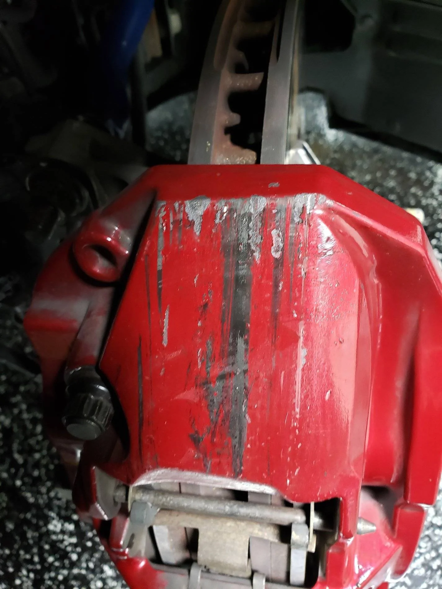

No arguments if folks don't mind the scratches. Hell, I don't. Just wanted to make sure the air is clear. The 6GRs WILL cause issues eventually. It's part of the deal. If that's no problem for you, awesome. But important that we don't hide the problem as a community.
That's terrible luck. Again I've driving mine on North Atlanta Metro city streets and the north Georgia mountain roads for over a year and 8,000 miles and have 0 damage. I'm not saying the potential isn't there, but I've seen the gravel issue with stock wheels and other 19" aftermarket units. Moving to 20" wheels seems to be the only surefire way to eliminate the potential for this to happen.
That being said I still would gladly own a set of SIgnature wheels if the budget allowed it.

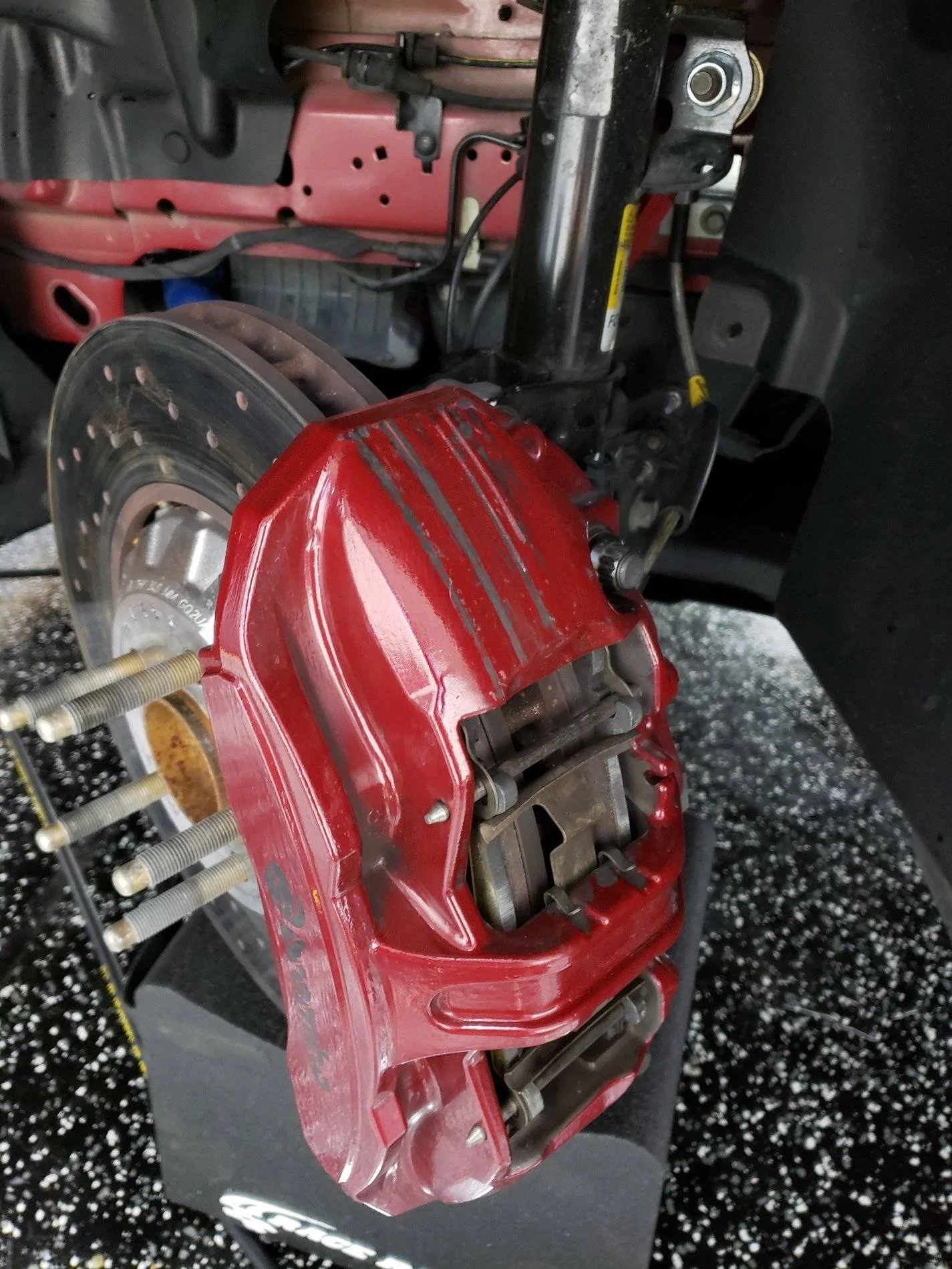

They've done it to me twice. My original calipers were also scratched. No way around it given enough time or the right weather/conditions. It mostly superficial, so will depend on one's tolerance to wear and tear, IMHO. No harm, no foul for me, though.
FWIW, the Signature Wheels in 19x11 have given me zero issues. Just a couple rubber marks.
curious, was this on hoosiers? I almost wonder if you just had more deflection in the wheel with slicks maybe? did the barrel of the wheel look as bad?
Nope. MPSS during winter/rain days before I moved to proper wets. And barrels are scraped, too. I'll grab some pics this weekend.
seeing the pics of the wheels on your car is what helped me decide to get the 6GR Seven wheels.
I also love the concave look they bring.
I was a little misinformed though, I thought they helped alleviate the caliper clearance issues.
I don’t like spending a lot of money on wheels. I’d rather put the money towards going faster, stopping shorter. But I’m concerned about the caliper clearance.
Just last week I had my new Michelin PSP 4s installed on my 6R sevens !!! Guess it’s too late now to look for a set with more caliper clearance.
