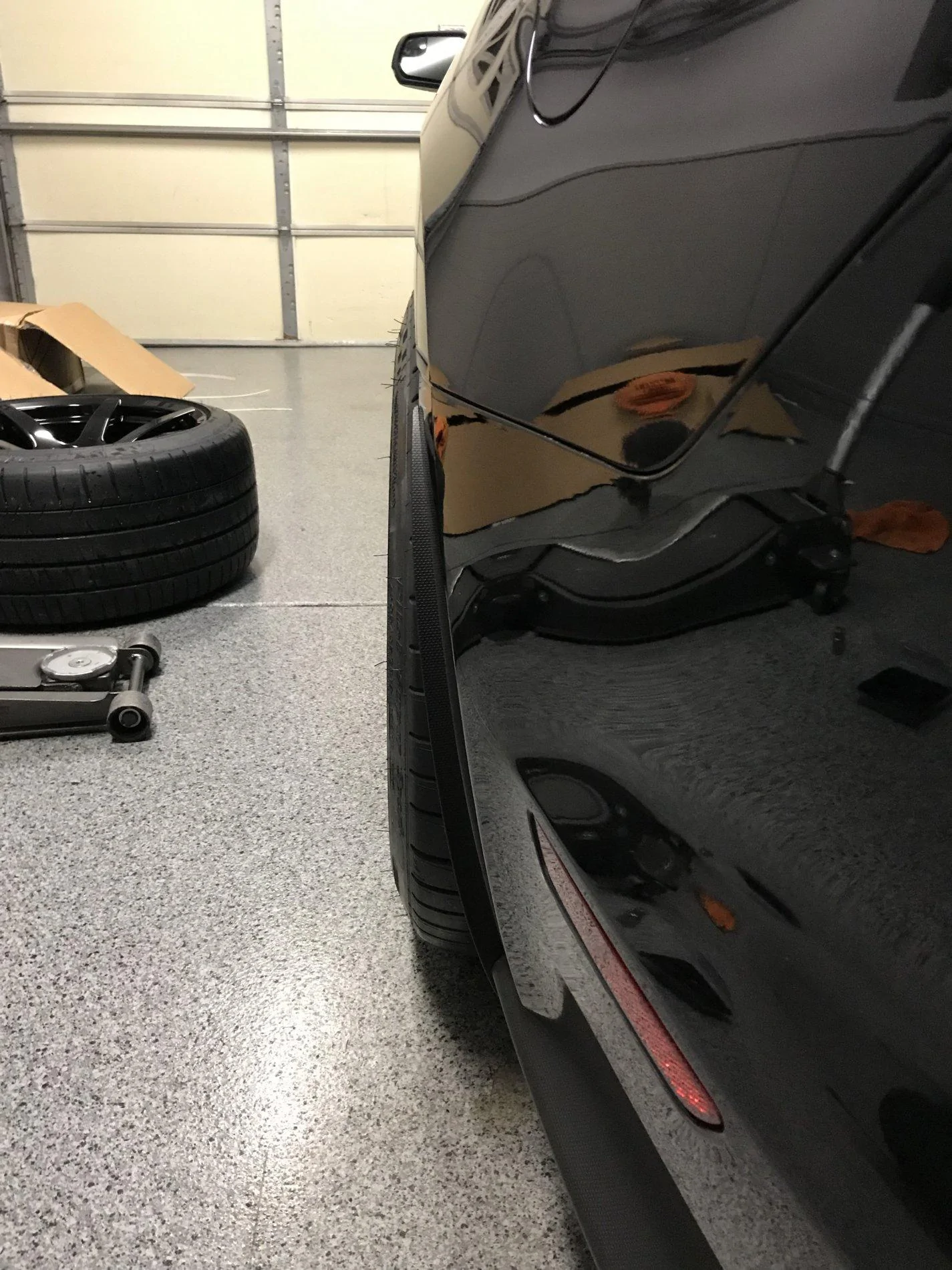

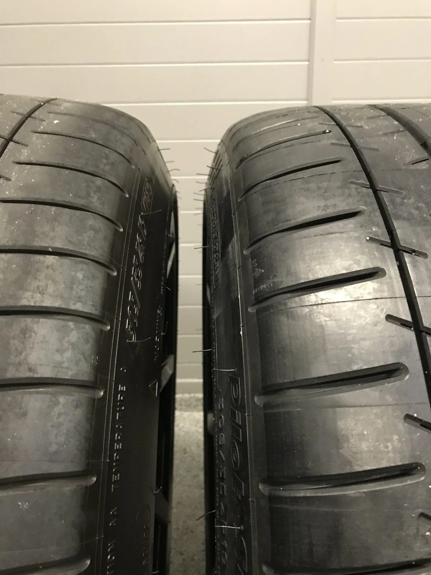

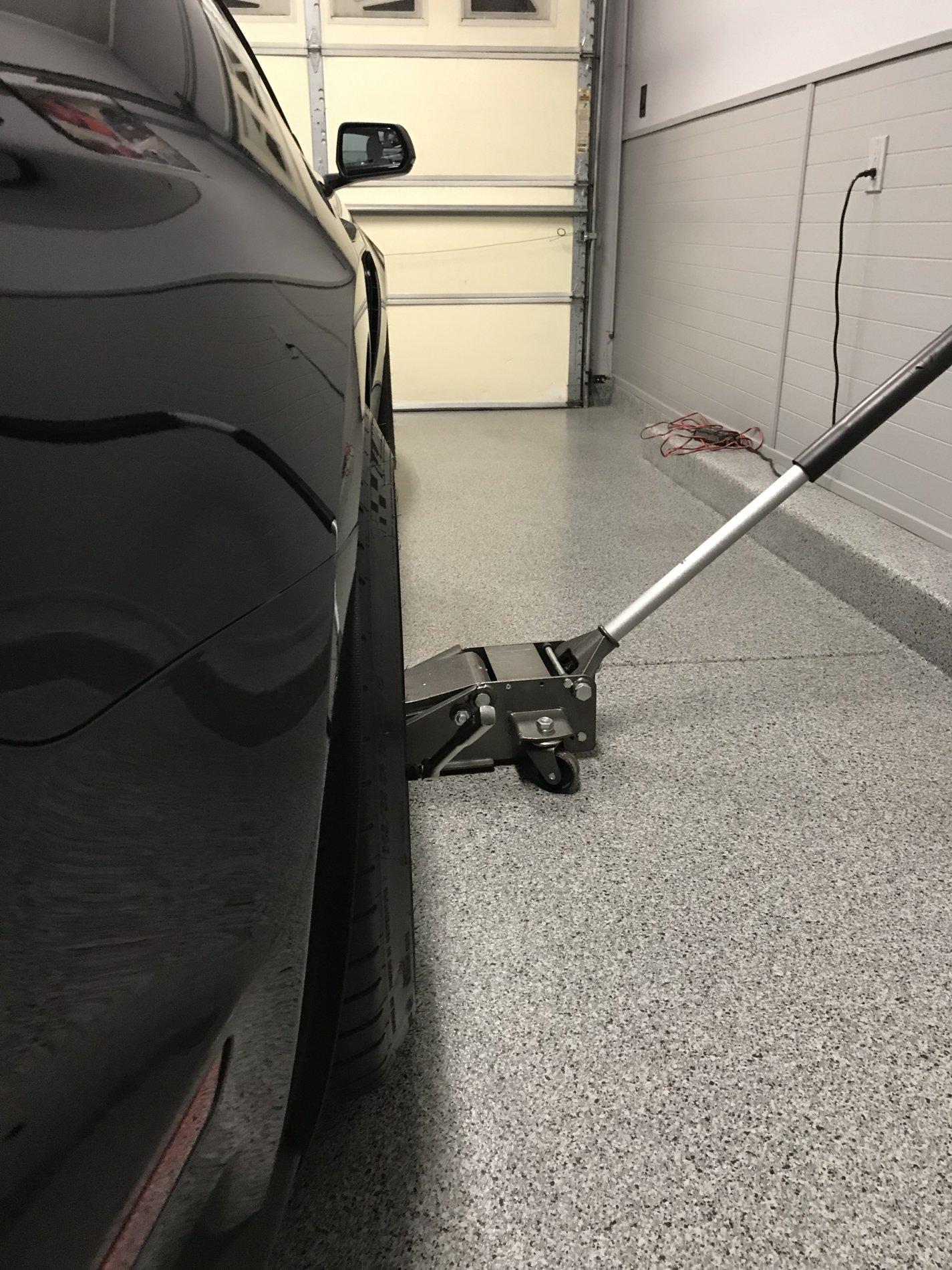

I have 6gr 7spoke wheels on my Gt350. 19x11 & 19x11.5” rear. I was never happy with the rear stance. The rear wheels stick out too much in my opinion. Recently I purchased 19x11 50mm offset for the rear thinking the half inch difference would tuck the wheel flush even with the rear fender. While the tire is stretched less I don’t think there is any difference between 11 and 11.5” where the end of the wheel face ends up.
This is the 11” wide with Michelin super sport 305s
this is the 11.5” wheel with the same tire
side by side tire stretch difference between two wheels

Well, that didn't help at all! Your tires, when they're mounted on 11" ET50 rims, actually poke out a bit further than if they were mounted on the 11.5" ET55's (the ones that poked out too far).
Here's how it works: reducing the rim width by 0.5" from 11.5 to 11.0 only moves the tire beads closer together. The tread width doesn't change. If you measure across the sidewall bulge, a tire on a 0.5" narrower rim is only 0.2" narrower. That's 0.100" on the outside and the same on the inside. However, reducing the offset by 5mm from 55mm to 50mm shifts the whole tire outward 5mm, which is 0.200". In other words, the change from 11.5 ET55 to 11.0 ET50 actually pushed the outer sidewall OUT by about 0.100".
The factory 11" rear rim is ET62. It sits 1/2" further in (and it clears the brakes and struts, etc). However, most of the aftermarket wheel makers have elected to make 11" "rear" rims in ET50, just like 6GR. If you really want to solve the poke, you might need a custom rim that's the same as factory or you'll have to switch to factory rims.
Update: the "GT350/GT350R Specific" 11" SVE R350 rear rims are ET60. That's why alan0614's pictures look so good.

That makes more sense. I wish the guy from N4sm would have explained that to me. I told him I was looking for flush fit. I was under the assumption that the half inch less would be closer to the fender.
