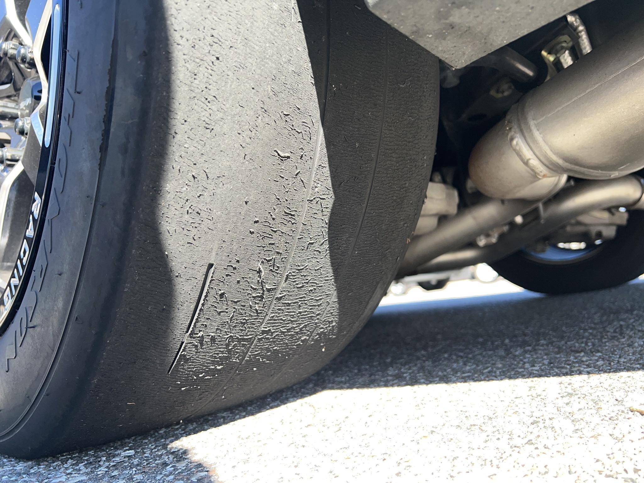

The et street R ball up rubber like this on the street
The dws06+ have a ton of tread blocks and deep tread, I guess they just kind give the tread a bit of flex which helps them not spin somehow, along with them being designed to withstand lower temperatures. Im on general gmax right now, havent tried them in the winter yet though. The DA was probably negative in these runs atleast -500 probably maybe -1000 max. Going WOT at as low of a speed as I can hook at in 3rd in these conditions, probably ideally around 40
