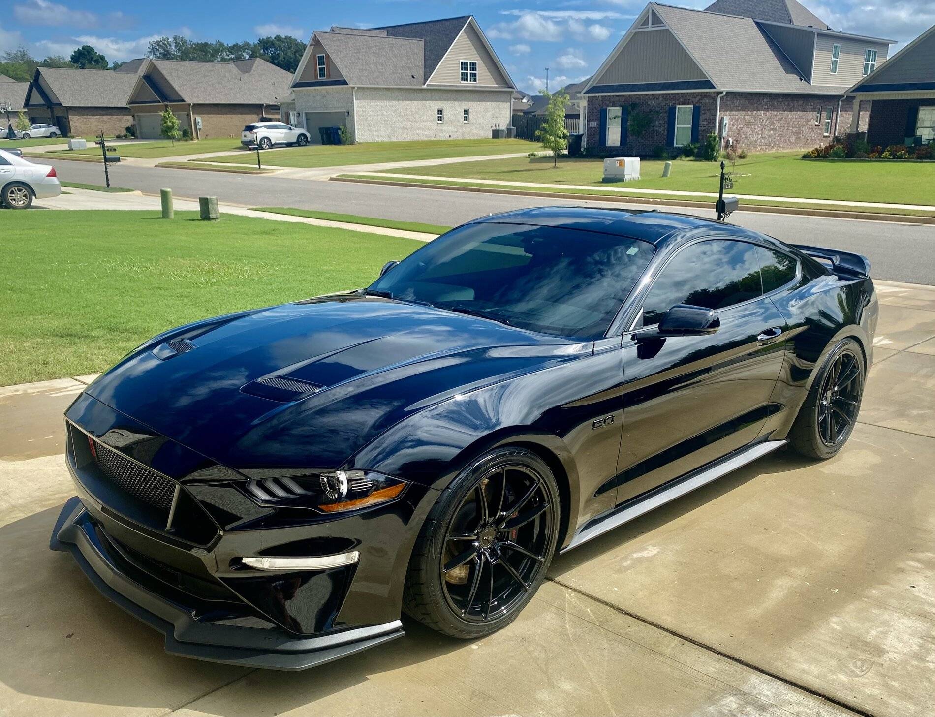

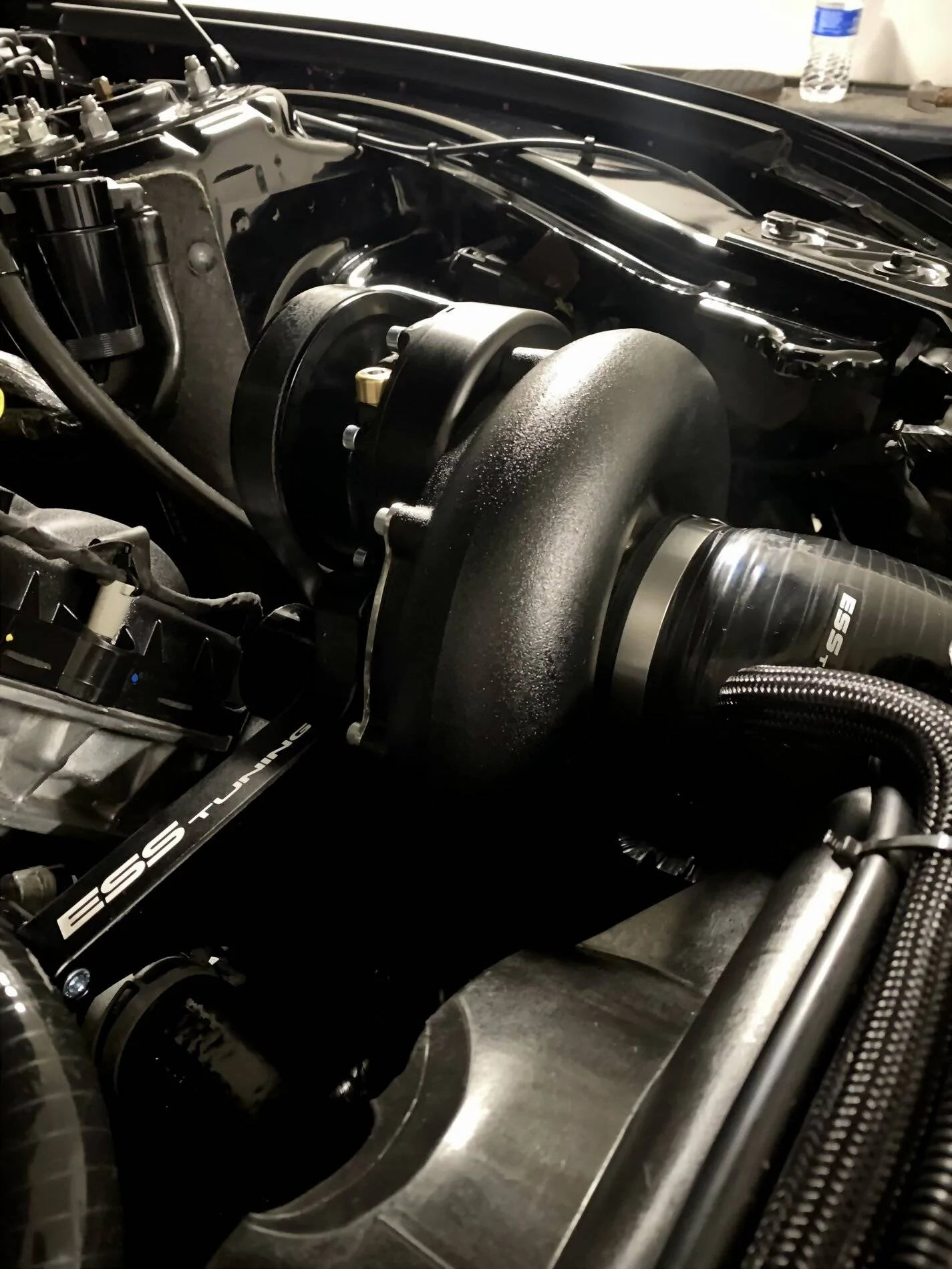

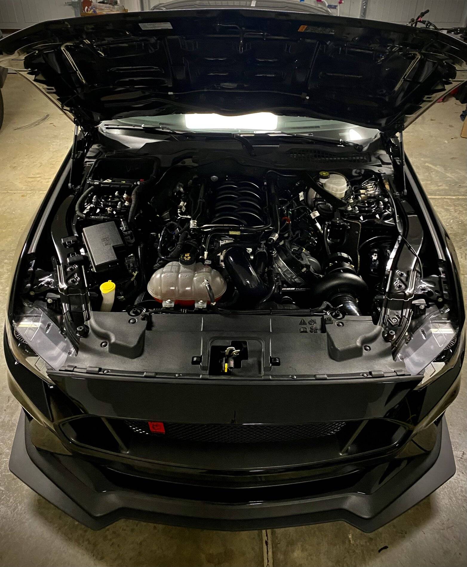

2018 10r80 premium PP1 car full weight 60-130 run on 20” wheels tires. DA 800ft
mods
Tuned by OZ tuning
ESS supercharger G3 7.5 psi pulley 93 octane
LTH longtube catted
GT350 manifold
Bullitt 87mm TB

She’s scooting for not being on E! How are you liking that ess kit? Their performance seems great for the price.

Love it, it was super simple to install. I did the bap and injectors the night before. Fed ex drop the kit off at 11am the next day Andy he car was driving by 3pm.

Do they happen to make crank supports for them? I’m looking to get out of my odin and into maybe a D1X or an ESS kit. Looking for 1000+whp potential but like the fact prochargers have crank supports.

The kit is run off the stock crank unlike a procharger so no need for a crank support.

Yeah it runs off the inner pulley instead of adding a whole new pulley to your crank but there’s still some stress on the crank that way just like my odin kit.

Don’t see how it’s anymore stress than stock still uses the factory tensioner. But I’m not the one to give an official answer on that.

The belt tension is the same or close, but requires much more power to turn. Every setup (NA, centri, PD, turbos) has snapped a crank. I looked for trends but the only one I found was making more power snapped cranks.

It rips!

Wow I’m impressed. That thing moves
