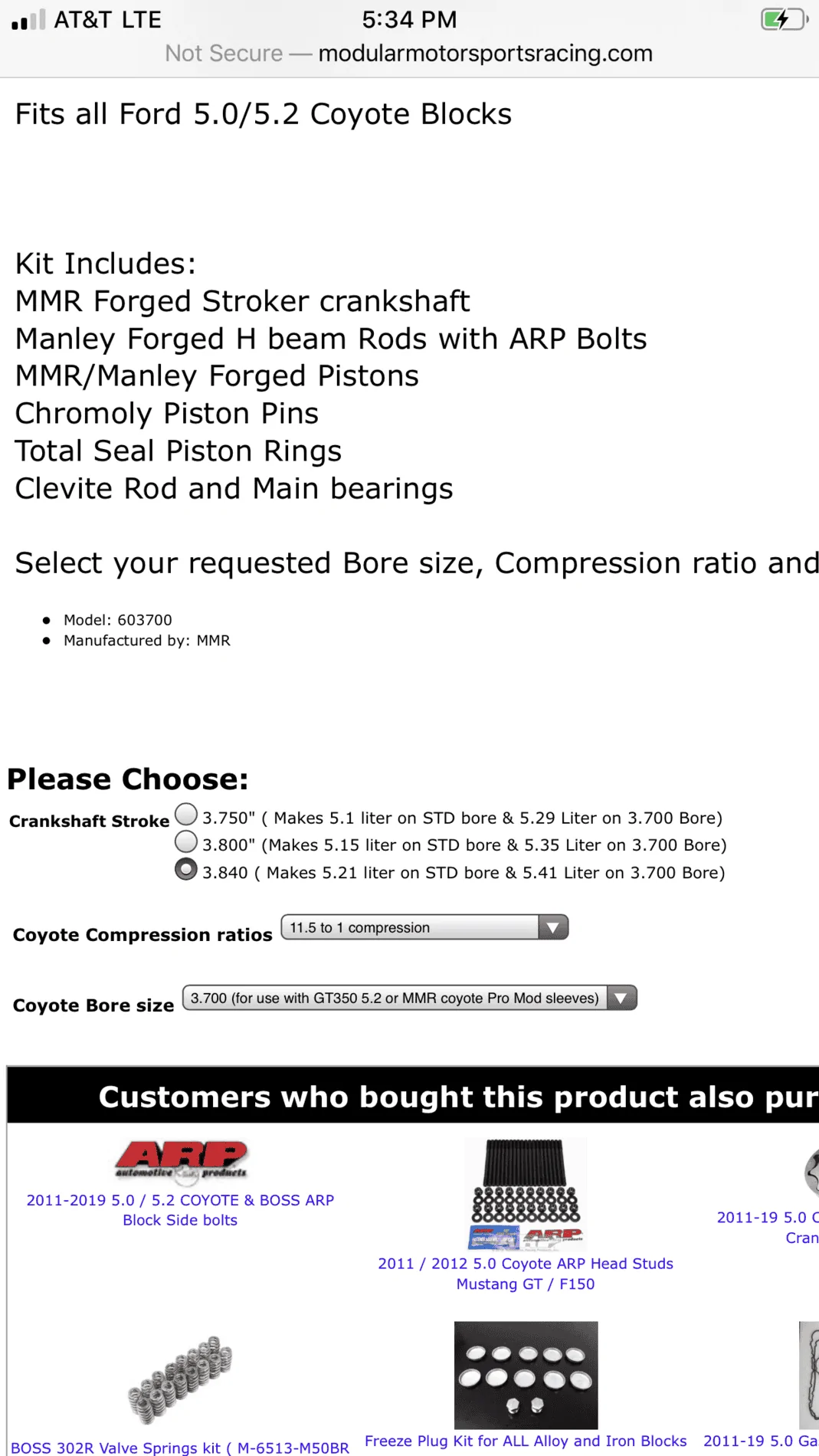

I am planning a “spare “ short block for my 18 and I came across this
I don’t see the the correct bore pistons offered for the 18’s but If you start off with a predator block(has the same deck surface with required knock sensors bosses )and you get a “5.4” !!
Add ARP main studs and you can get a badass block for under $6K.
http://www.modularmotorsportsracing...n_page=product_info&cPath=84&products_id=1056
