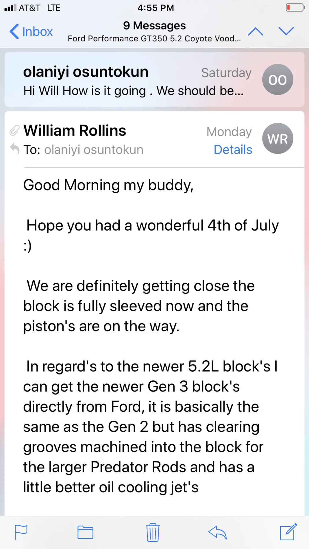

Will@RPG built the short block now in my Hellion TT car starting with the Gen 2 /5.2 block(M52A)
Also has GT 350 heads and the ford racing 5.2 cams (coyote firing order )
Not sure if it’s the same as the predator block since Ford performance now sell the the “Gen 3”(M52B)
The Gen 2 also used the longer 12 mm head bolts like the predator (I used the 11-12 Coyote ARP head studs )

That’s what I too thought but it appears the only difference is as below per my engine builder
