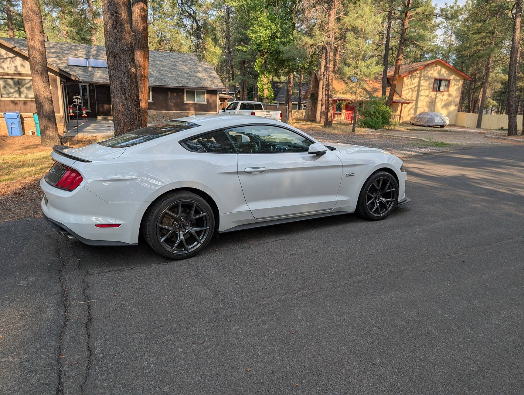

Car arrived yesterday.......LET IT BEGIN!!!!!!!!
Nice!!! You're looking at maybe a few hundred at most with those options/color. It s a perfect GT cruiser just the way it sits, LOL. Dozens of Mustang shows and thousands of Mustang cars and still haven t seen another one.
