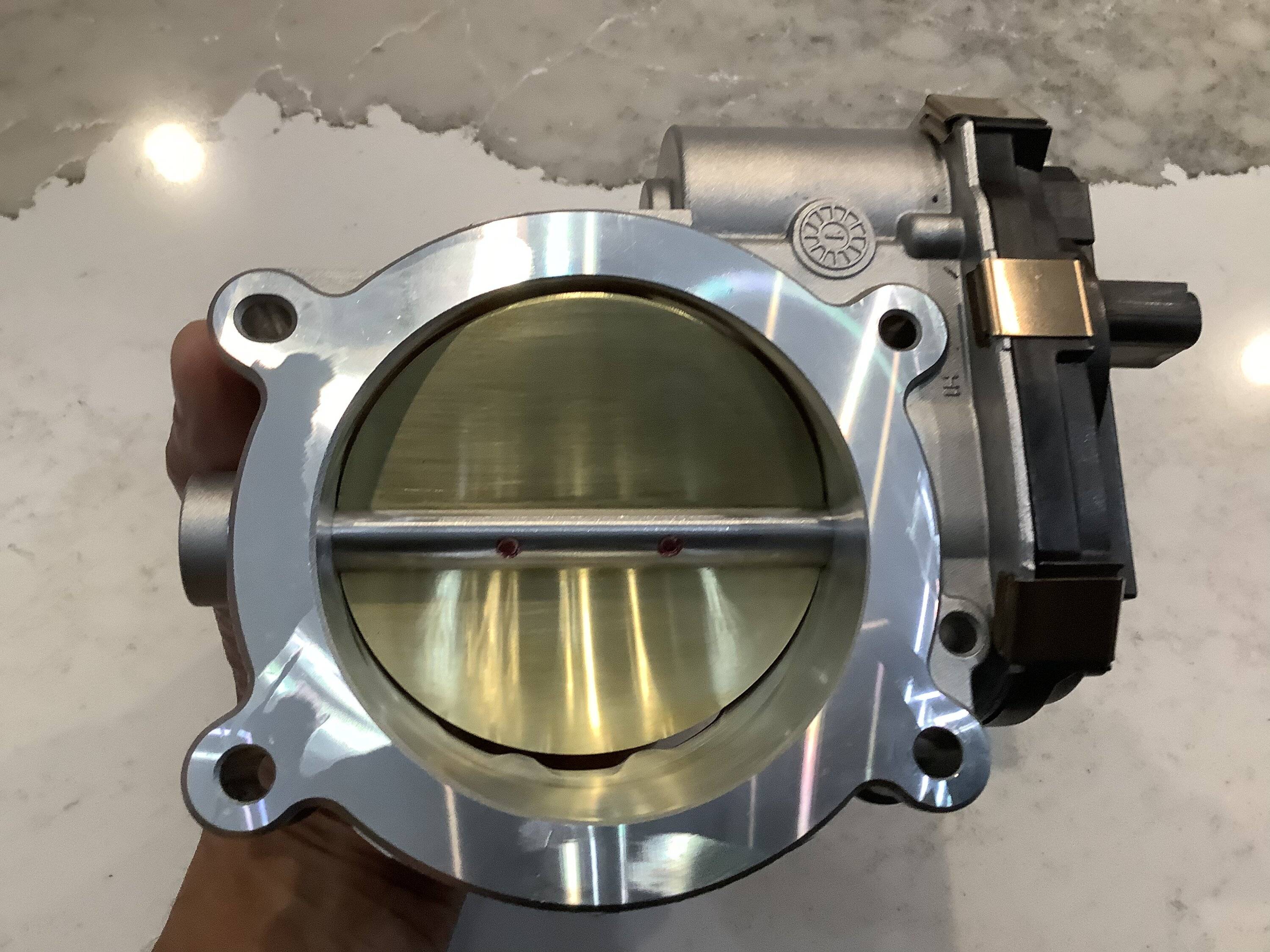

That’s one of the easiest mods you can do. Unplug the factory TB wiring harness/connector, remove the 4 bolts, install the new TB (reusing the 4 factory bolts), plug the factory wiring harness/connector back up, torque to 89 in-lbs and you’re done. I think Soler Performance may have one for sale already.

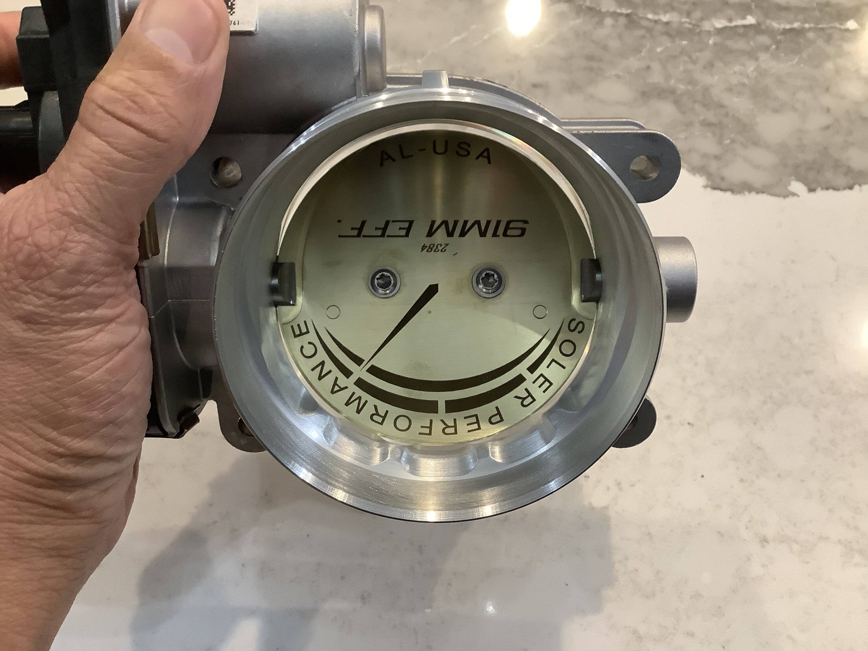

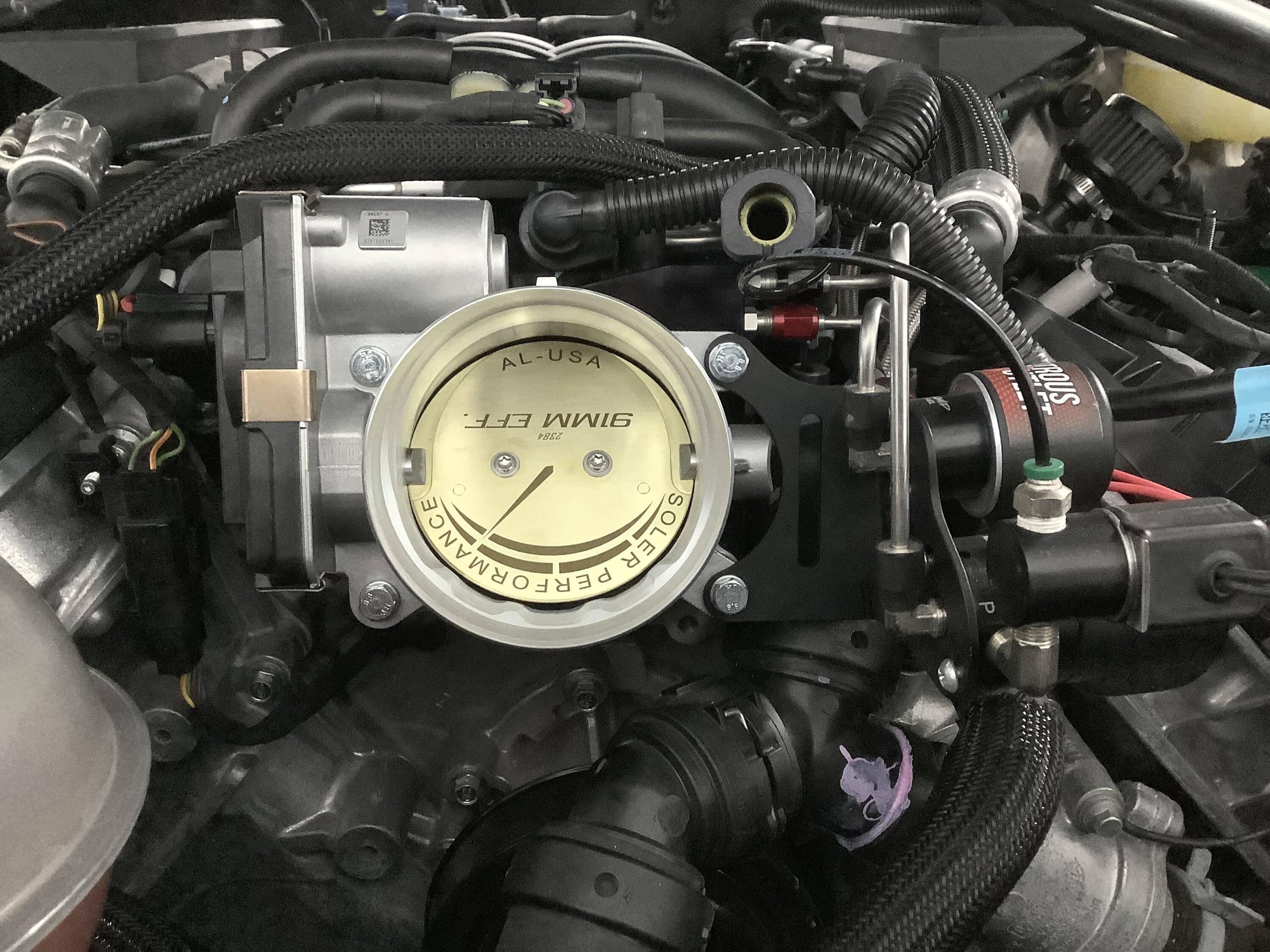

No tuning or anything. What size is recommended?
My car is a 2019 Bullitt (which has the GT350 intake manifold). I actually sent my factory TB to Soler and they ported it to 91MM and no tuning was required.

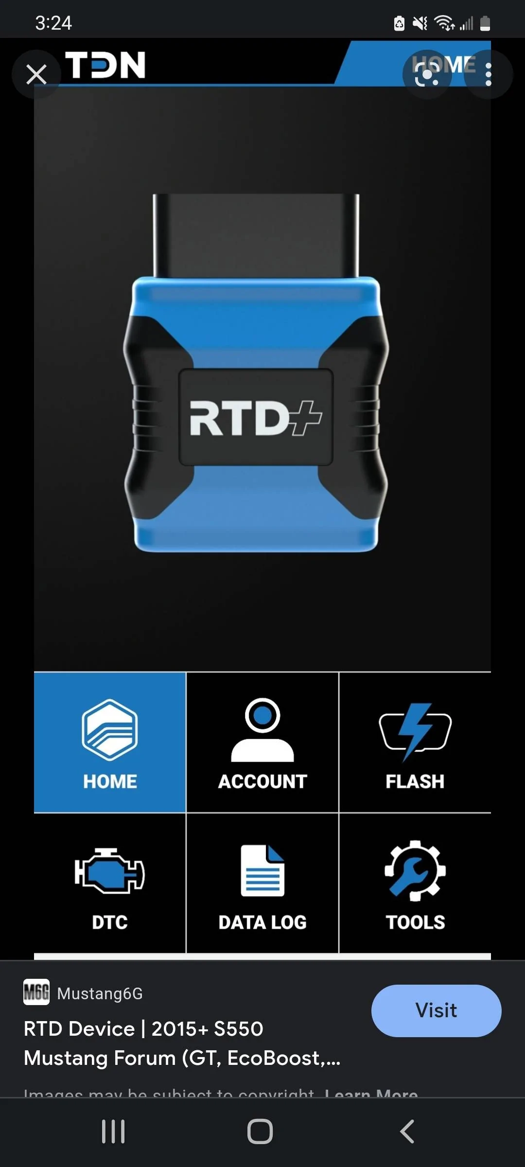

Like one of the flash tuners?
Pick a good reputable tuner and have them remotely tune your car. I recommend adding all bolt on performance mods that you want before you do, whether that’s headers, x or h pipe, axle back exhaust, cold air intake kit and throttle body or any combination of the aforementioned. That way when the tuner writes your tune, you can gain maximum benefit from all mods, especially E85 if you’re open to that.
The device is just used as a tool to upload a custom tune or to data log.
