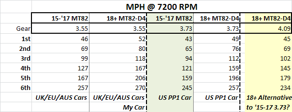

I’ve been debating if I should change my gears. I have a 19 gt and it comes with 3.55. Will I notice a difference if I install 3.73 gear? I really don’t want to go to 4.09 as it’s a manual
cib24
Jul 3, 2019
422
175
UK
1999 Mazda RX-7 Type RS
I post this all the time in various threads asking this question as I have 4.09 gears (not installed yet due to lockdown). In my view a jump to 3.73 is not worth it. 4.09 is the minimum and frankly even 4.56 would feel more perfect minus the elevated cruising RPM.
And is it worth it? Yes. I'm of the view that under 80-90 mph the 15-17 manual is actually quicker than a 2018+ manual due to the closer ratio gearing.
The revised ratios of the MT82-D4 and comparison at the 7400 RPM max revs on the stock ECU:
Another chart comparing the 2018+ cars to the 2015-17 cars up to 7200 RPM and you will clearly see the 4.09 gear swap on a 2018+ makes the gearing very similar to a 2015-17 GT that came with 3.73 gearing until 4th gear.
Marketplaza
May 18, 2020
327
111
Ks
2019 GT shadow black and 18 dodge caravan
So I should get 4.09 gears and not 3.73? I just don’t want to have it to where I gotta speed shift even when I’m not racing. Right now I’m pretty sure mine came with 3.55 gears. But I’m up in the air about which ones to get.
cib24
Jul 3, 2019
422
175
UK
Yes, 4.09.
You aren't going to need to speed shift anything. The ratios are wide enough that you will see literally zero effect on mpg or driveability around town and likely won't even see a drop on the motorway in economy.
Look at the tables. It's clear.
