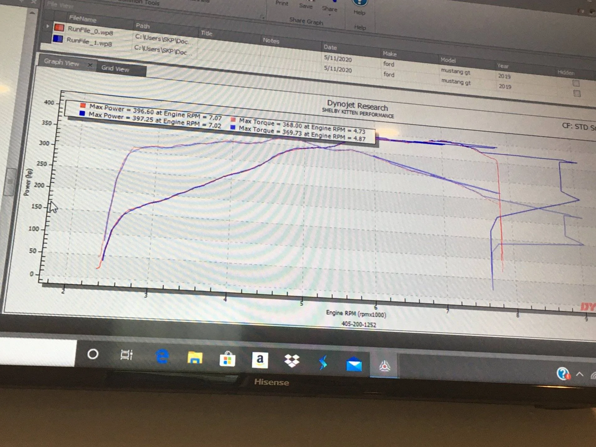

I just had a Lund e 85 tune on my 19 gt, I already had the Roush cai but when they ran the dyno my max BP was 429, is this a good rwh with this setup? I heard I was supposed to be right there with a gt 350 once I got it done. But I’m pretty sure a gt 350 has more then that.

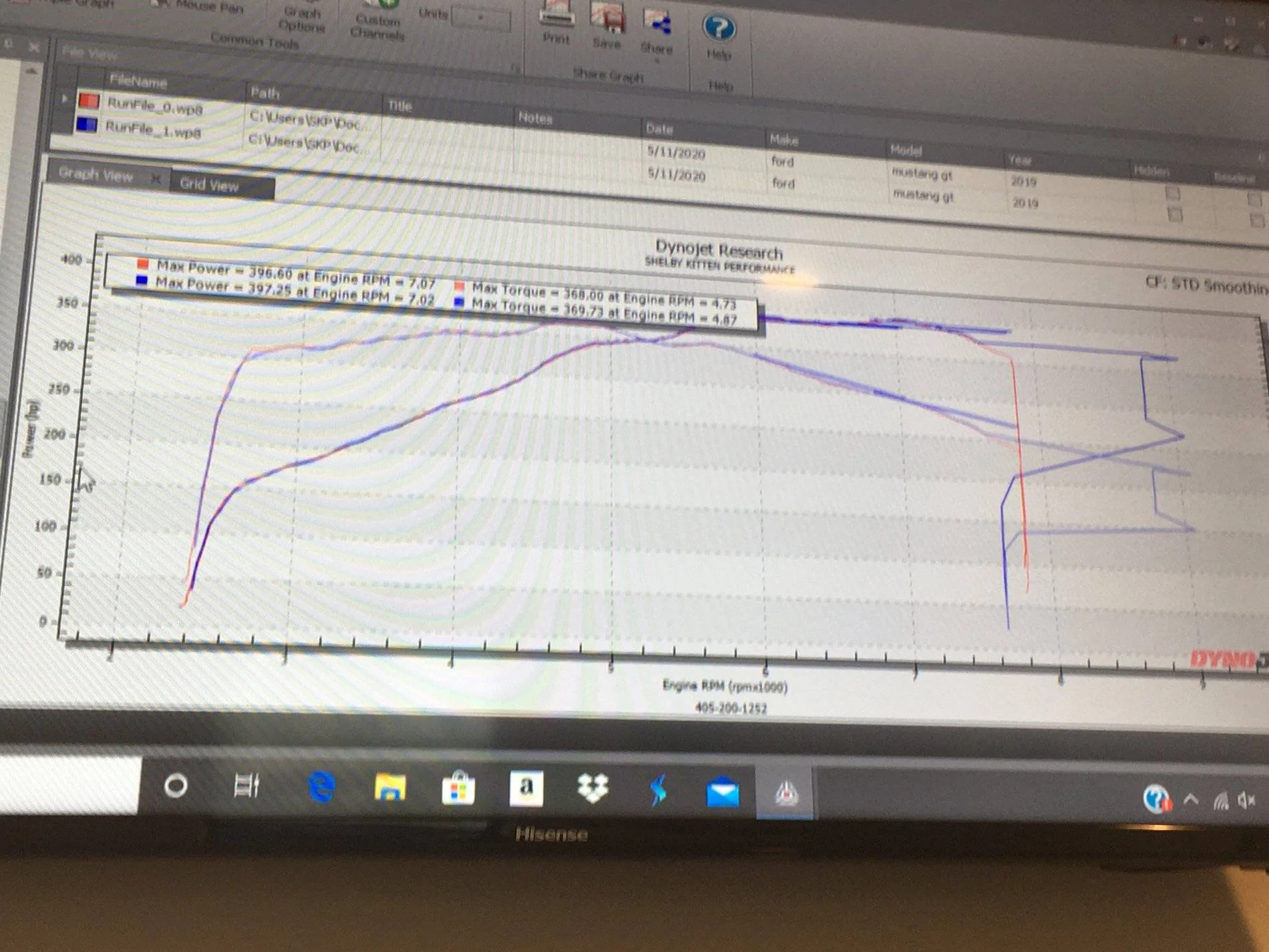

I have a 19 gt with Roush cai and a e 85 tune and x pipes. Are these good numbers?

Your other post mentioned max RWHP of 429. These graphs are below 400. The correction used is also STD which IIRC tend to show inflated numbers. Is your car auto or manual? What gear were the pulls done in? Do you have baseline stock dyno numbers? The numbers here seem low even for a stock 2019 GT much less one with an e85 tune.

Is the shop aware that '18 and up manual trans Mustang GTs are 1:1 in fourth, not 5th like the '17 and down?

they told me they did the main pulls in third gear. Does it matter what gear it’s in?

Oh man, I just noticed those are my baseline readings, I got the final printout in my car. I’ll take a pic and upload it here soon. But the 396 rwhp was with just the Roush cai. No tune was installed yet.

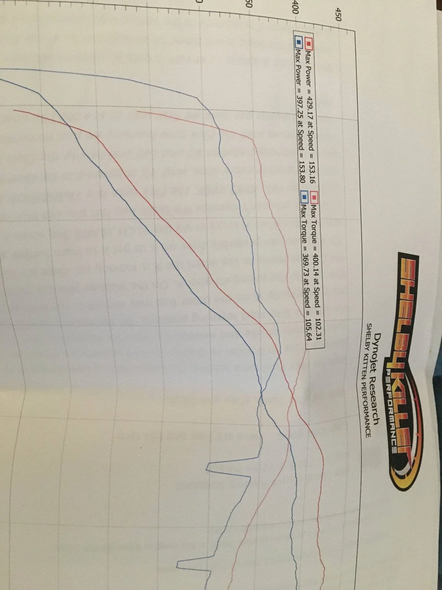

Here is the final print out, sorry for the quality
