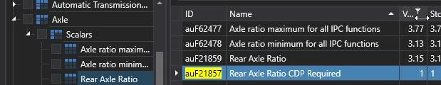

I believe you can override the axle / differential value in the tune itself via the following scalars in PCMTEC.
Set CDP requires to 0 and set the rear axle ratio manually.
This likely would only only work for a manual vehicle.

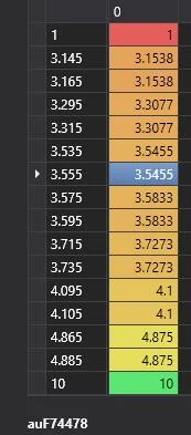

There is also a lookup table for precise ratios which are used in various parts of the code. I don't know what would happen if you changed say a 3.555 to 4.875 but that might "hack" the tune to change the ratio also.
All of these scalars are present in the 22+ calibrations in PCMTEC that I checked.
I suspect there are several other scalars present as well, a good way to find them would be to compare a PP1 and PP2 (or some cal that has a different diff ratio in the stock calibration to see what Ford has changed). You will likely find everything you need that way.
Another good hack is calibration tools > view all scalars. Ctrl + a, ctrl + c, wait a minute. Go to excel. Ctrl + V
Then search for the diff ratio and you'll find all the auFs that have that number in them.
