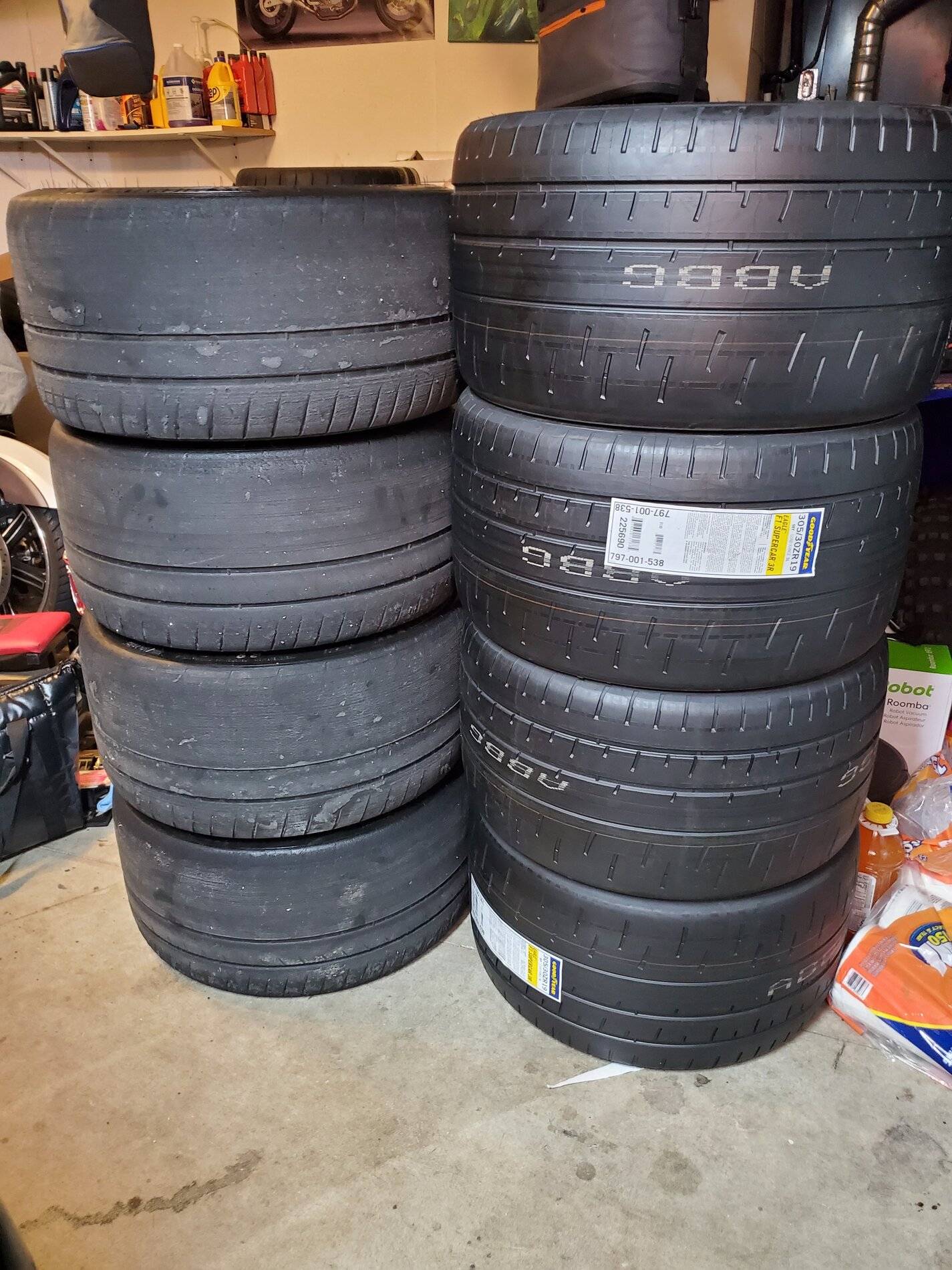

Here is 315 cup 2 next to 305 3r, I run a 305 square setup, but my buddy runs a 325 square setup on his 350r. The cup2 are on the left fyi.

Interesting pic; thanks for sharing. I am surprised that the 305 3rs appear to be wider than the 315 Cup 2s. Am I seeing that correctly, or, is that an illusion from the camera angel?
I am going to look into the Goodyear 3Rs. I'll likely run 305 fronts and 325 rears; gonna try these on the new spare rims first.

The 305 3R is wider than the 315 Cup 2. Confusing, I know. It is what it is though.
The typical setup is 305 square on rotatable 11" wheels with spacers up front.
