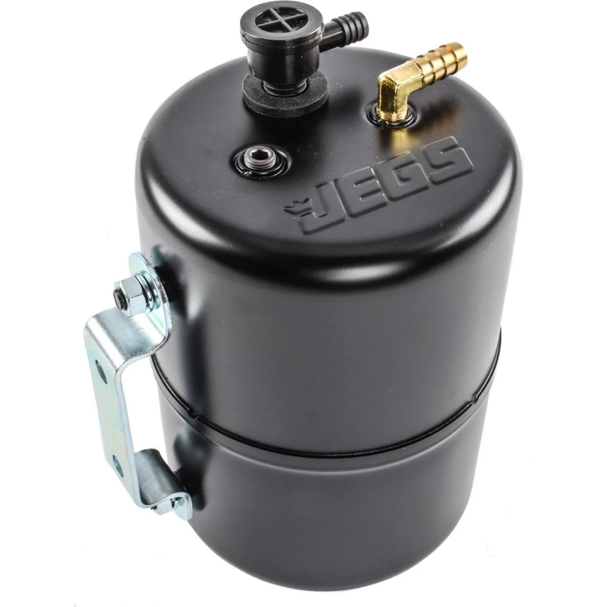

Not sure what the differences are in the boosters but I am thinking about adding a vac canister in front of the stock GT brake booster, I have had a few times that while rev matching on downshifts and hard on the brakes that I have lost servo assist of the brakes. For the few times that it has happened I think it is caused by over shooting the rev match while trail braking into a corner, then the pedal goes hard with no assist left from the brake booster.
I have a gut feeling that it is also being aggravated by the cars tendency to hang the throttle at high RPMs when the clutch is engaged. The stock tune did this a little but the Lund tune does it as well. I think the throttle is hanging open for a second and delaying the building of vac signal to the brake booster. Adding the vac canister and having a large reserve of vac signal may result in a more consistent brake feel in the long run as well. They are cheap and easy to install so it is worth a try and can not hurt. Since I have a cage and nothing under my dash I will likely add it under the dash near the brake pedal assembly.

Something like this one from Jegs or the one from Comp Cams. They include a check valve and fittings so all that is needed is some longer pieces of hose to splice the canister in between the vac source and the brake booster.
http://www.jegs.com/i/JEGS-Performance-Products/555/63010/10002/-1
