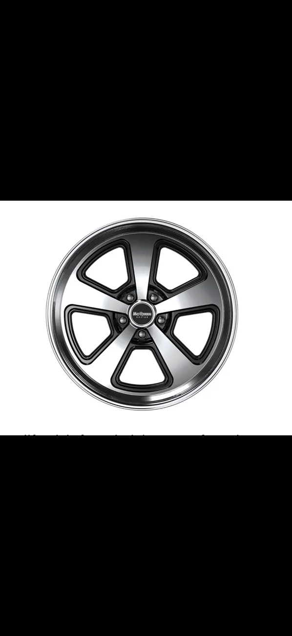

They’ll be very similar to these

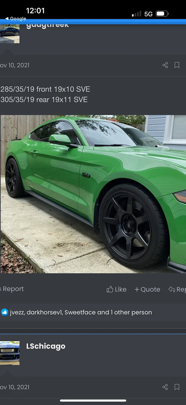

Judging from pics like this and others the 19x10 and 19x11 285/305 combo sure does look good
