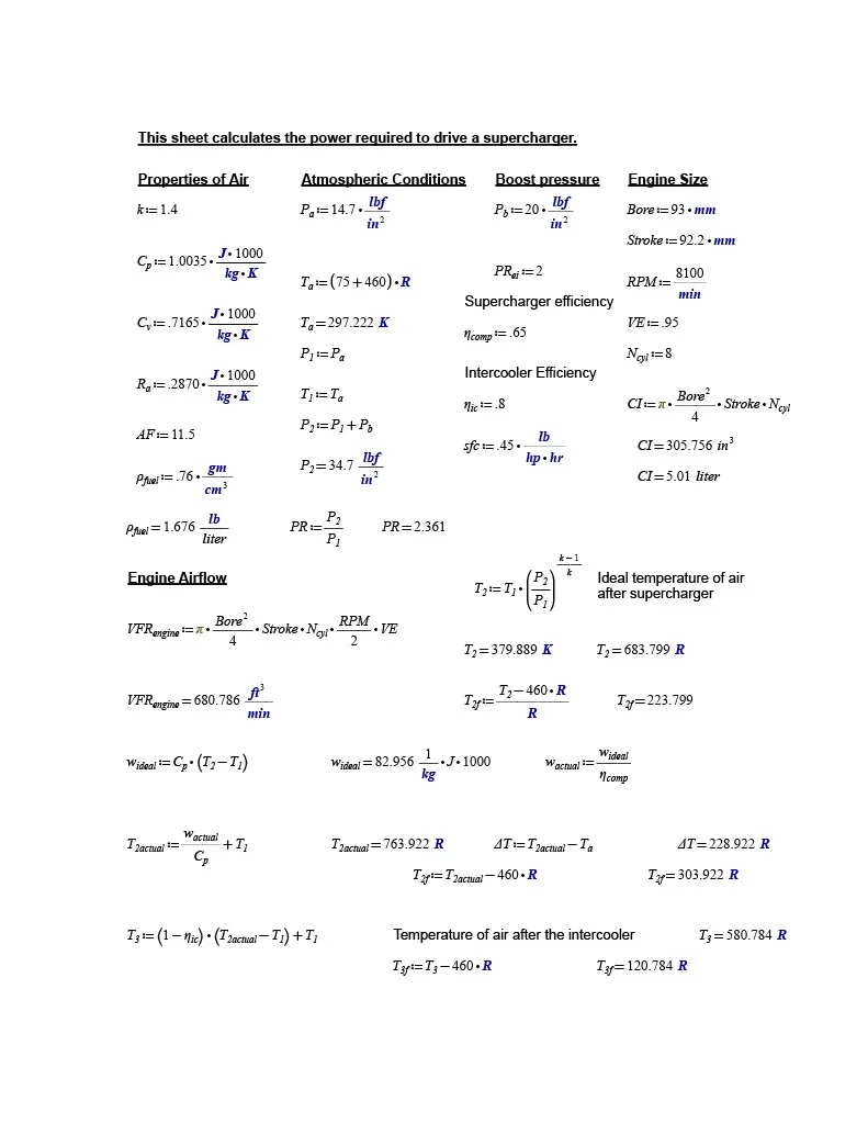

Quick and dirty math says about 100-150.
Can you show us how you determined this? I’m very interested in how you determined the parasitic loss of the supercharger.
it’s a basic air compressor calculation and the calculators are available on various websites. I estimated airflow at 3.8 x 6.5 / 3.25 x 7500 to get LPM. Actual will be a little less due to <100% ve. Efficiency is a guesstimate as well.
I calculated 142hp supercharger power for comparison using 65% compressor efficiency, 80% intercooler efficiency, 20psi boost at 8100 rpm.

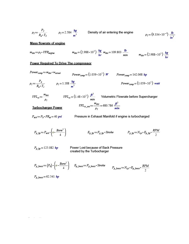

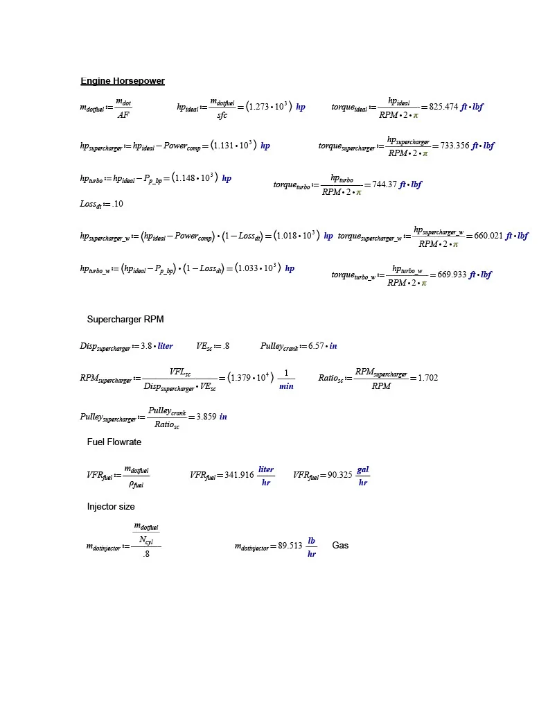

Here is a calculation sheet I have been using for years. I put in some values for OP.
