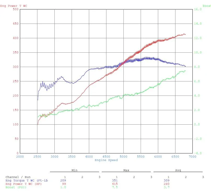

Its very realistic, MPT did it with a P1 procharger and I have the big boy D1. From what I understand from a local guy that has a very large performance shop the d1 and 10lb pulley on e85 will make that number with no problems. 10lb pulley is what I have but you could be hitting 12 13 psi depending on supporting mods.I really hope you make 550whp on only 10psi but IMO that isn't realistic. If there were E85 easily available here in Dallas I would go that route as well. I monitor knock and OAR religiously and even though my base tune is for 91 octane I still see a little knock at high boost on 93 octane winter gas.
