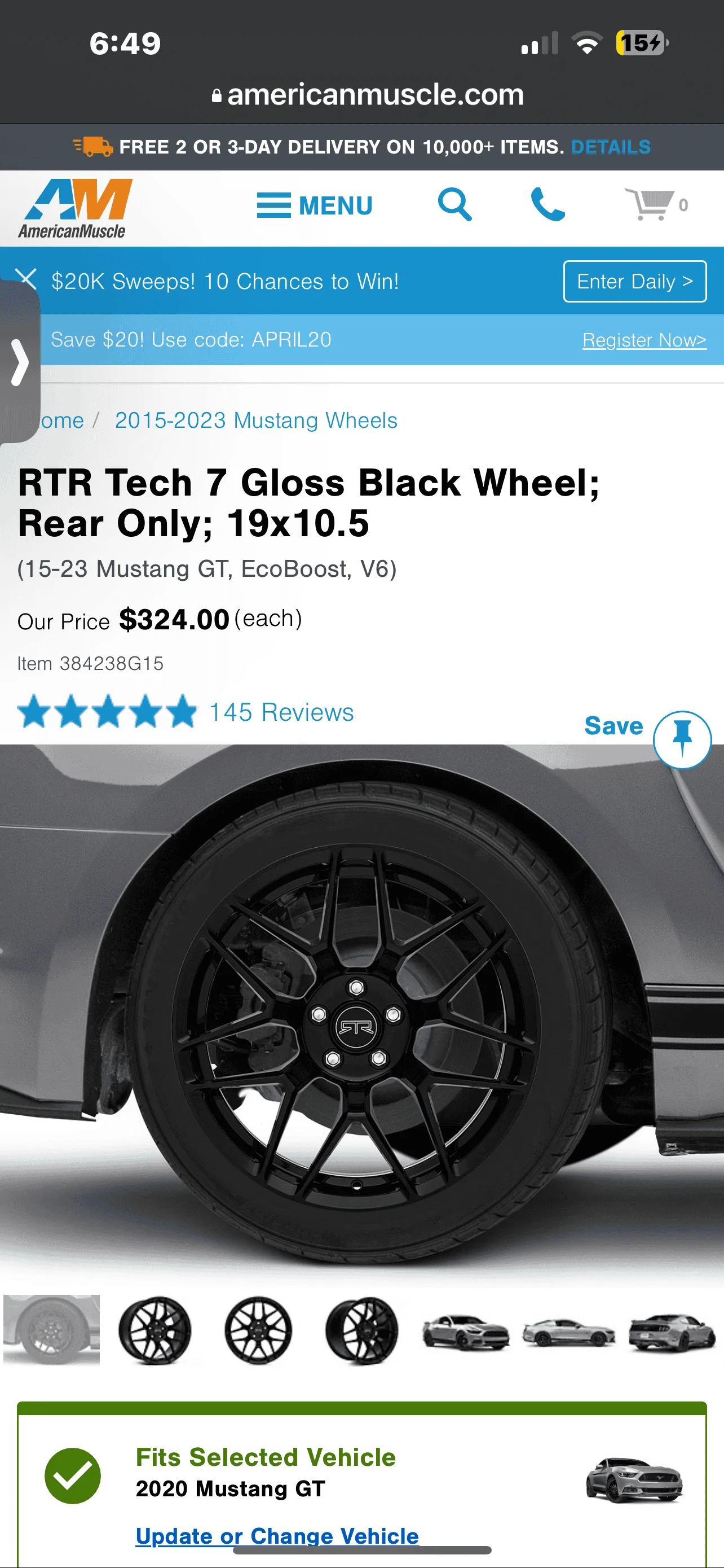

So 275/30r19 for front and 285/35r19 would be the way to go if I want those wheels correct? Or what about 295/35r19? I was checking on Discount Tires because they do carry Continental and Michelins. AM don’t carry those

OP, as ***** pointed out. Your tires and wheels are not what would normally be considered a good match. I highly suggested putting some more research into what it is you are wanting to do. If you are wanting to run 275 or 285 on the front and 305 on the rear, then look for wheels that are typically 10" wide for the fronts and 11" wide for the rears. If you want to stick with the wheels you have in your cart, then you need to look at tires that are not as wide. I personally wouldn't call a 9.5" wide wheel much of an upgrade.....but I know many people do.

so that stuff in my cart, the AM salesman did it for me, he put everything together and sent me the quote link which opened to that . We talked it out and he told me everything would fit perfect, so maybe he forgot or didn’t notice that the wheels wouldn’t fit on 305? But I just checked their site and they have the same wheels I want but 10.5 so I could go for 305
Yeah I think he made a mistake and thought he put 10.5” for the rears. As an example, Michelin says 10.5” is the narrowest wheel width for 305. If you go 305/35 in the rear on 10.5” wide wheels I’d go 265/40 in the front on the 9.5” so they aren’t taller than the rear tires. They’ll be almost the exact same diameter.

So I’ve been trying to search around and right now I have this, the front wheels 19x9.5 and the rear 19x10.5 from AM then from discount Tires I got the Michelins pilot sport 4s 275/30r19 fronts and 295/35r19 rear, would that setup go together? My total would be around 4K :,( with the nittos it was 3k but it seems that they have a bad rep, what other tire suggestions do you have?
Those front tire sizes (275/30/19) are too small in diameter and will result in a large fender gap and won’t look good. I’d go 255/40, 265/40, or 275/35/19 on the fronts.
295/35/19 on the rear should look pretty meaty.
For pricing, check out the continental, Firestones, or Goodyears that were previously recommended. PS4S isn’t the only good summer tire. But is probably the most expensive.
