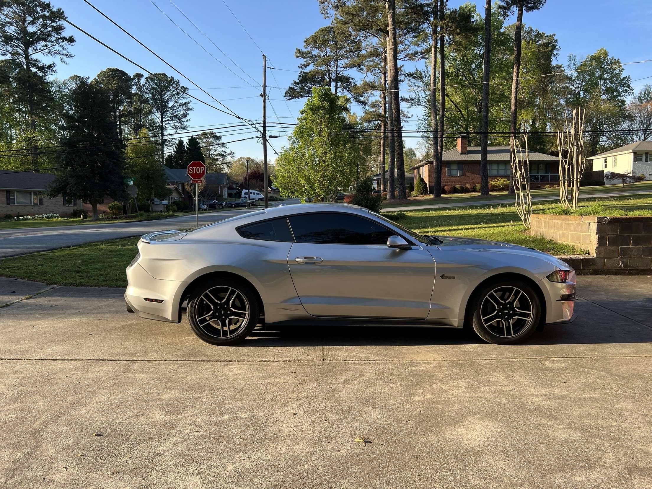

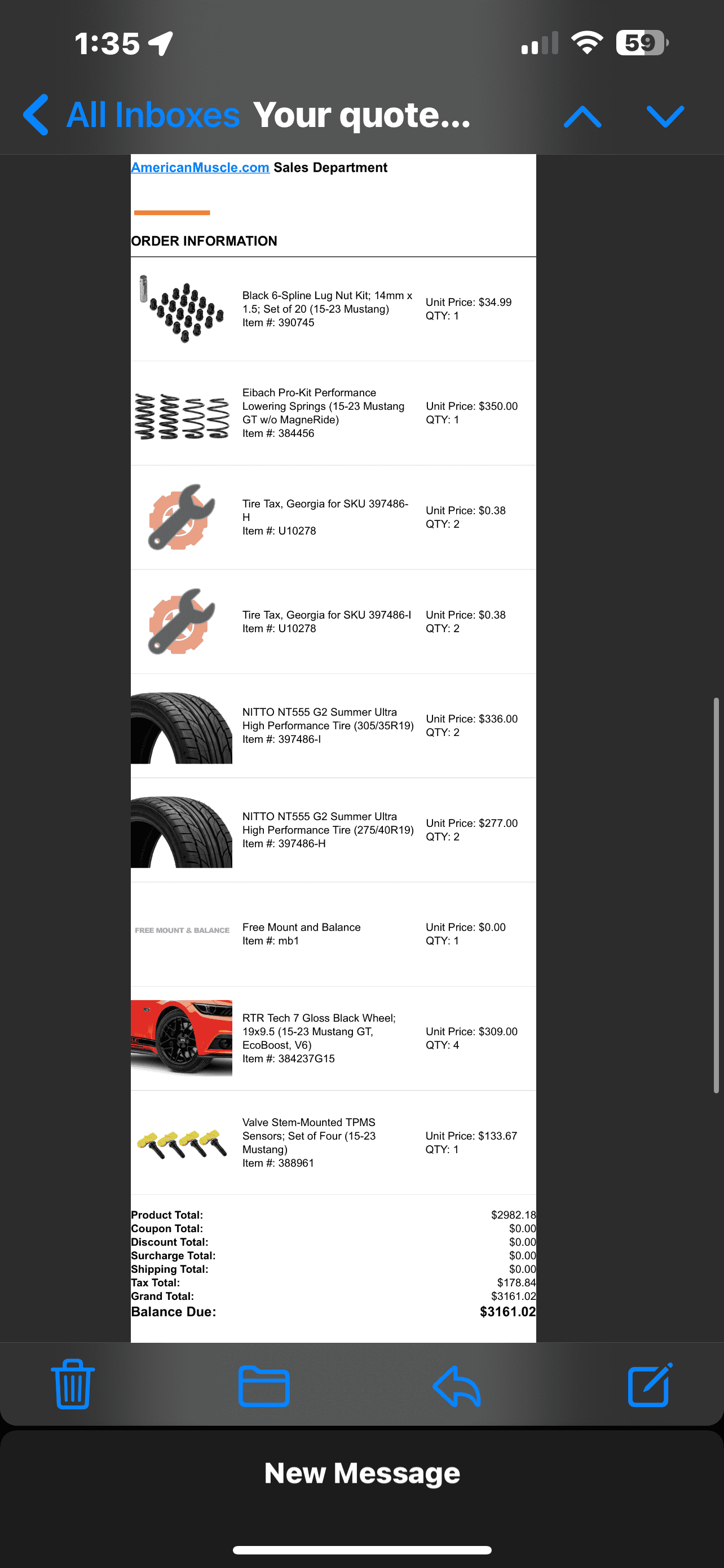

Hello everyone so I’m getting ready to upgrade my wheels and tires pretty soon. I have a 2020 Mustang GT Premium non PP full stock in iconic silver. The wheels it has rn are TRASH in my opinion. It’s sitting on 18’s and I think they’re 235s all around. So I’m upgrading to RTR Tech 7 in gloss black size 19 with Nittos 555 G2. I was thinking of doing 275 front and 285 or 305 for rear. I can’t decide between 305 and 285? I live in ATL so weather is bipolar, some days sunny some days Thunderstorms. And this is my only car so I daily it and put a lot of miles on it. It’s fully stock and planning on keeping it stock for a while. So what would fit me the most? I want that aggressive look but reliable car. Is there really a difference between those 2? Besides the width and look? Does it affect how the car drives, performance? I got a Quote from American muscle on how much it would run me with everything and I’m also getting the Eibach pro kits. Could I get some help please? I have 0 knowledge on wheels and tires

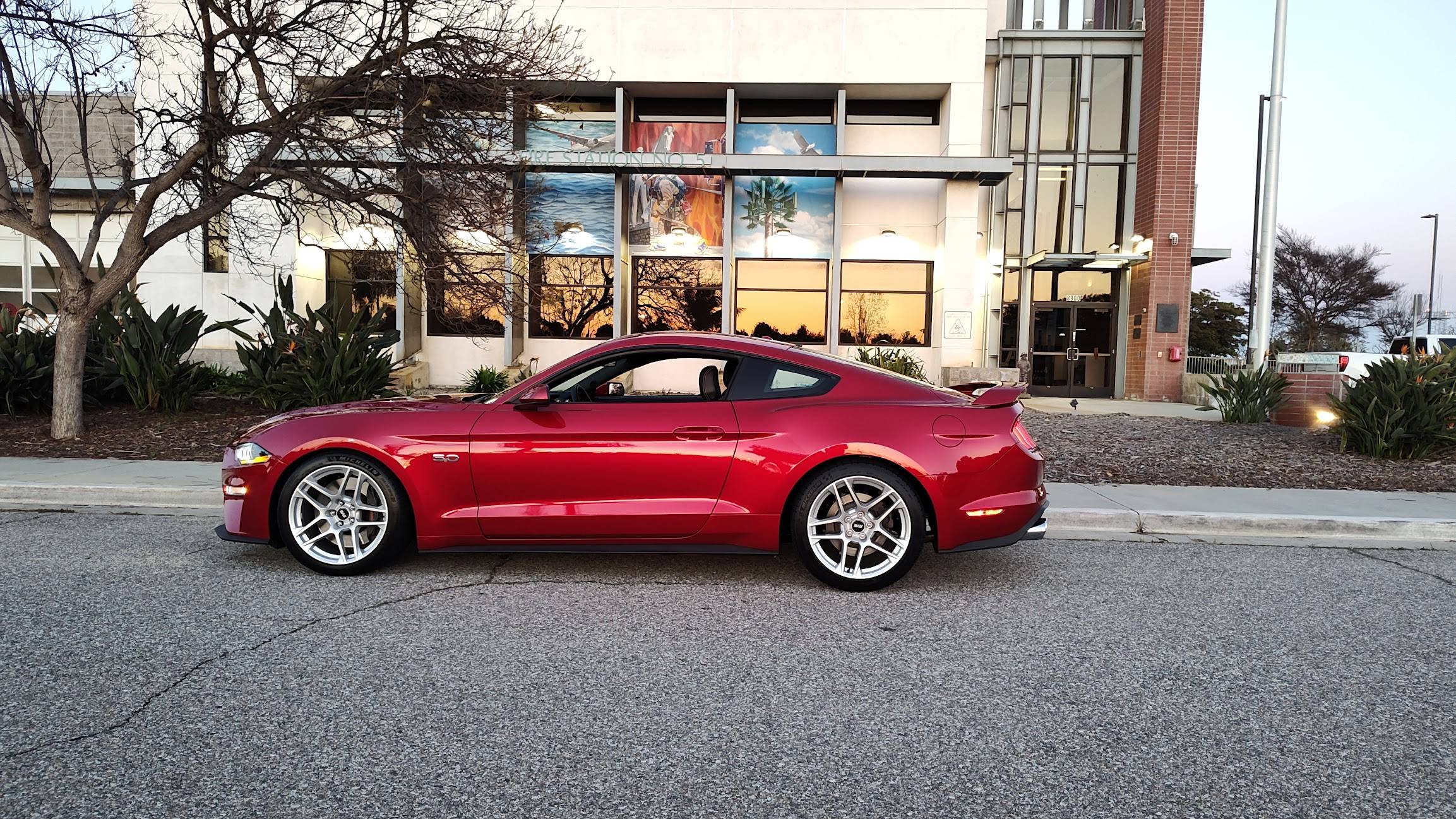

I would go 285/35/19 for the front. A 275/40/19 is taller than the 305/35/19 and they will be in front. It will give the car a negative rake. A 275/40/19 is 27.7" tall while the 305/35/19 is 27.4". Not enough to give you an issue with the StabilityTrac, but raising the front a tad more giving it a rearward facing rake. Also, you may save some money by reusing the OEM TPS sensors.
Here is my car with 285/35/19 and 305/35/19, they are Michelins but you would get the point.

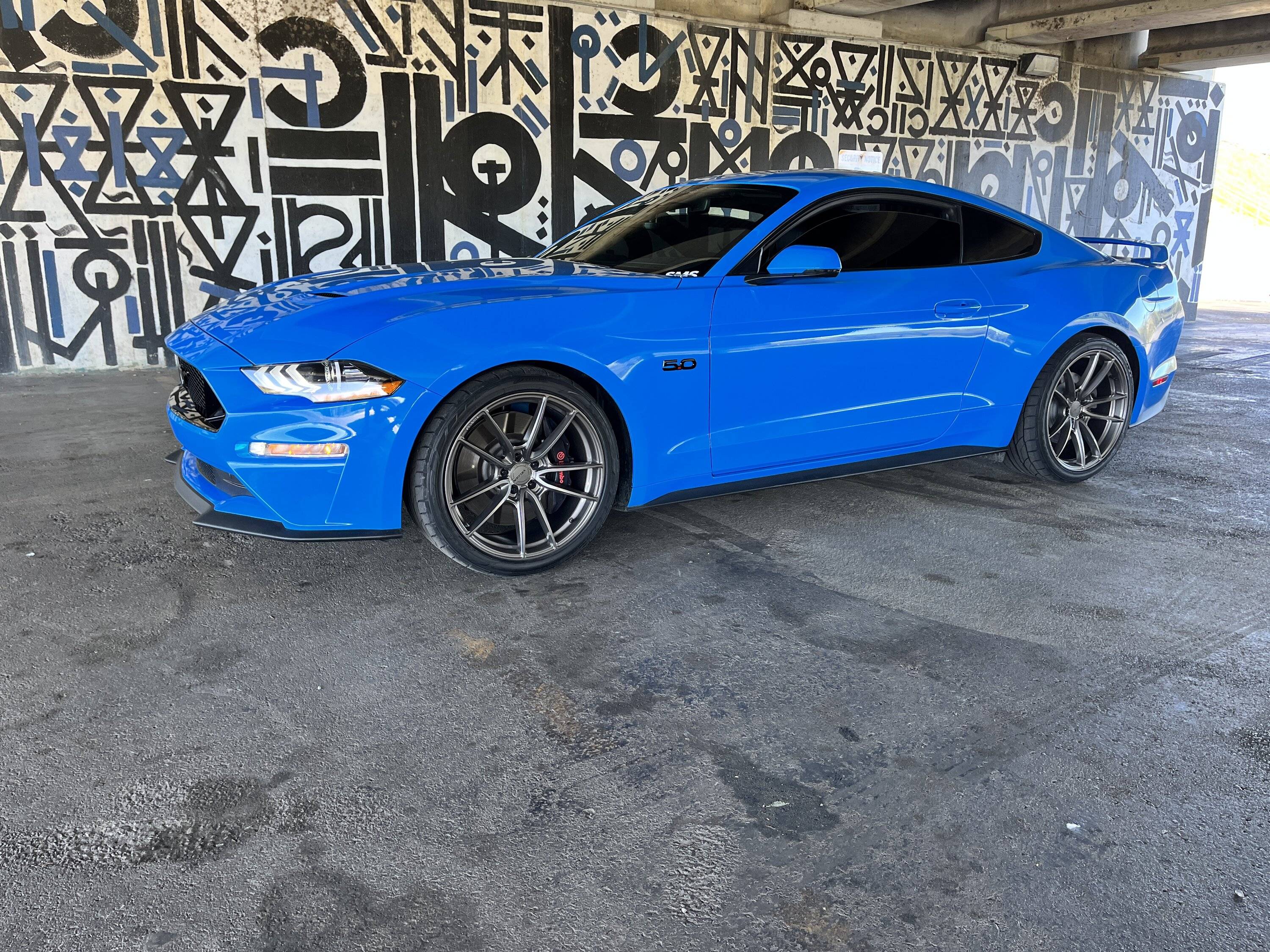

I went with 20's but I did 275 35 front and 305 30 rear. They drive really well and the offset I went with looks killer. That said, the Nitto 555 G2 I am not impressed with at all. They are really greasy (slip a lot from a launch) until they really get warmed up, If you have an option for Michelin I would get them. I got mine from LMR.com and they give the option of Nitto or the Firestone Firehawk. That said I have a set of Michelin Pilot All Season 4 on my stock PP wheels (255 front 275 rear) and they actually grip better than the 305 Nitto's, and work in cold temps. I will run those in colder weather and save these for warmer months. I'm in East TN so that's about 7 or 8 months warm and 4 or 5 months that are a little colder.
