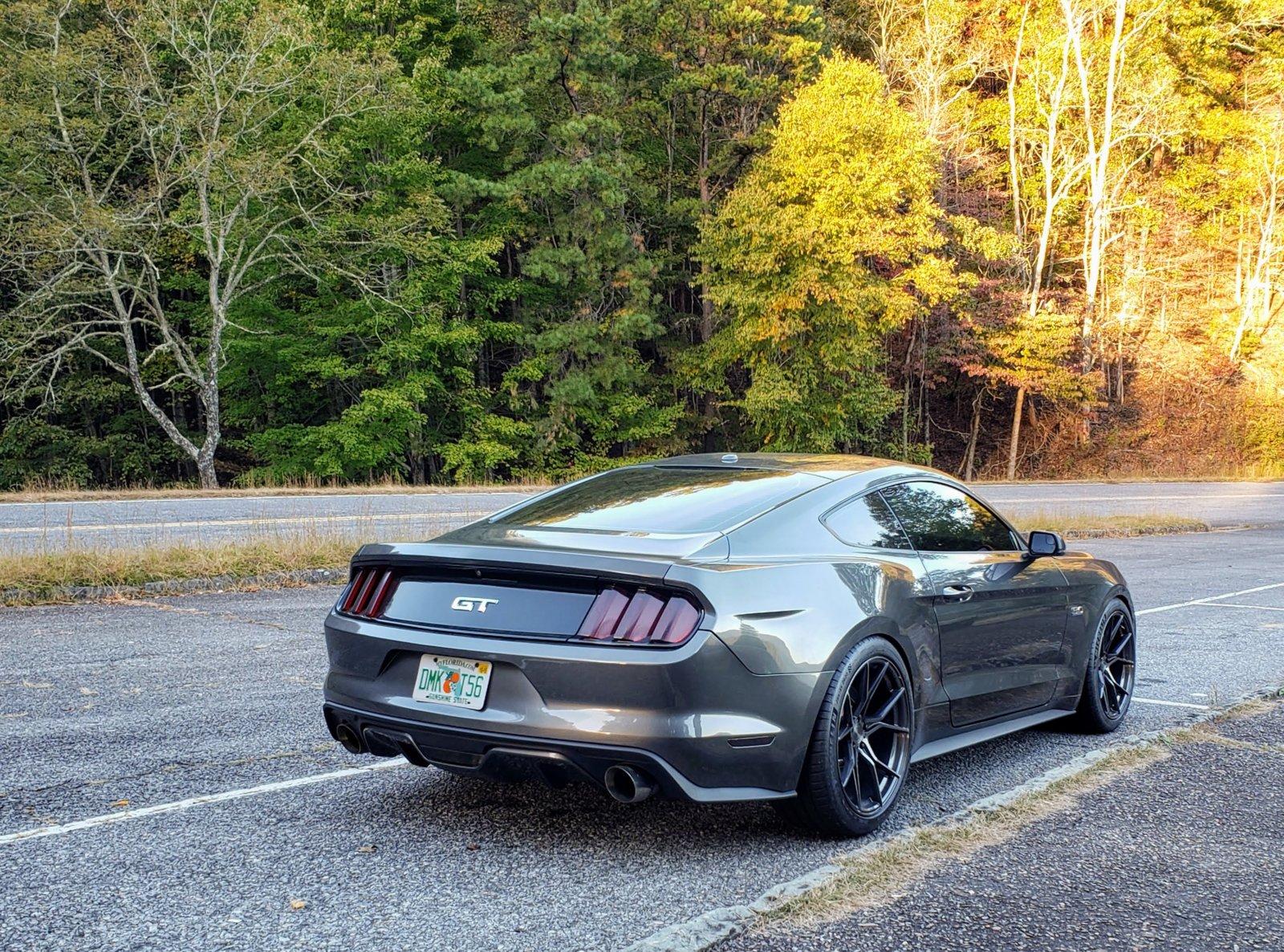

i'm also running with a 285/35/20 setup. Wheels are 20x10 ET35 Lowered on Eibach Pro springs and Michelin Pilot Sport 4S tires. No issues that i can tell.

Looks clean :)

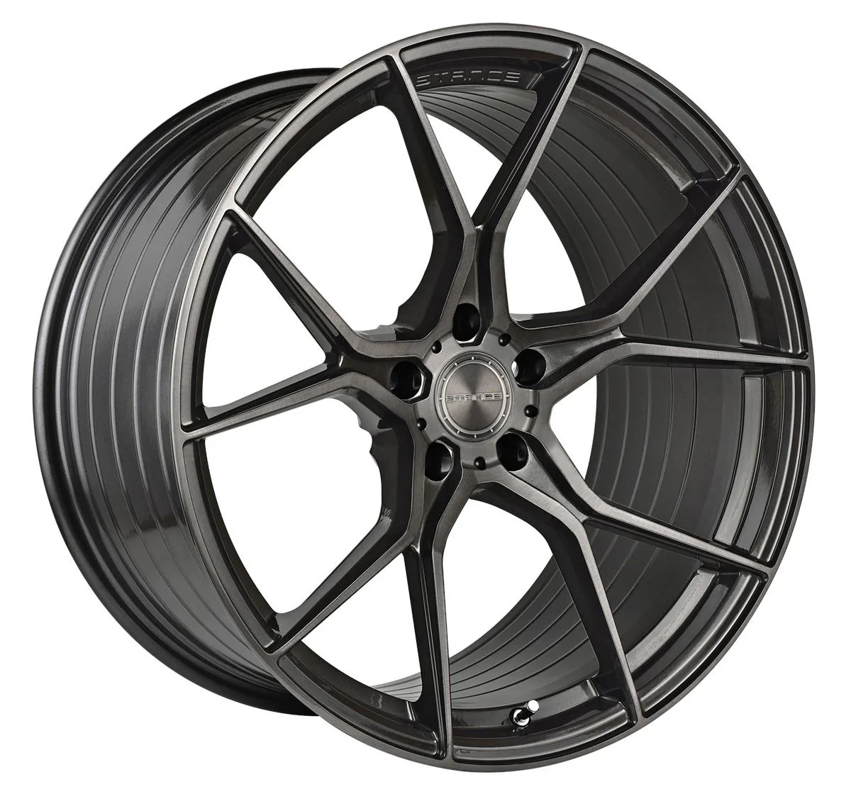

Beautiful. What Wheels are those?

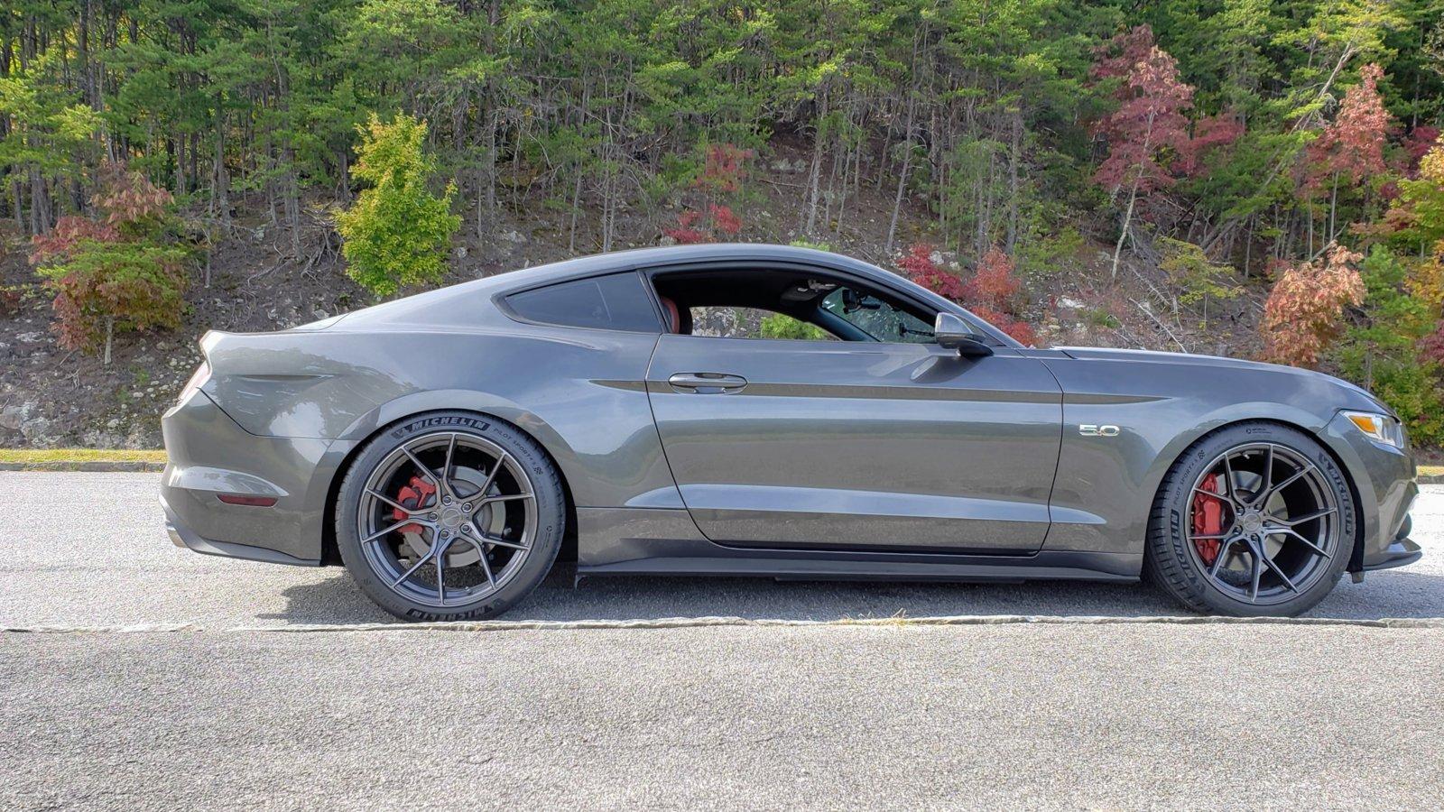

Hi. I absolutely love the look on your car!
Is the paint Magnetic and the wheels are----gray? Or green/gray?
I've got the Magnetic s550 too and have also been looking for the exact same setup, but I can only find the same wheel with ET43 for the 20x10 wheel. Do you have the same and added spacers, or is it available over in the US with ET35?
Is it ok to add a 5mm spacer to get down to ET38 without losing the stability of the hub?
I'm now running on 25mm hub centric bolt-ons that still centers the wheel properly.

Over here you're able to order them with a custom offset. One of the forum wheel guys could likely help you get what you need. Josh with getyourwheels got me hooked up and I was able to place an order for the tires through another online site and have them delivered to their warehouse where he had them mounted and balanced on the new wheels. I don't currently use any spacers and that's how they sit with the et35 offset. I was contemplating a 5mm spacer for the front wheels just to get it a hair more flush, however I haven't gotten around to it as am still very happy with the look . Be prepared to have a lot of debris kicked up along the sides of your car with how much more the wheels stick out. I went ahead and bought some rokblokz rock guards and haven't looked back. Helps with the debris and adds to the aggressive look. The wheels are the dual brushed gunmetal finish straight from stance. They happen to match the car very very well.
