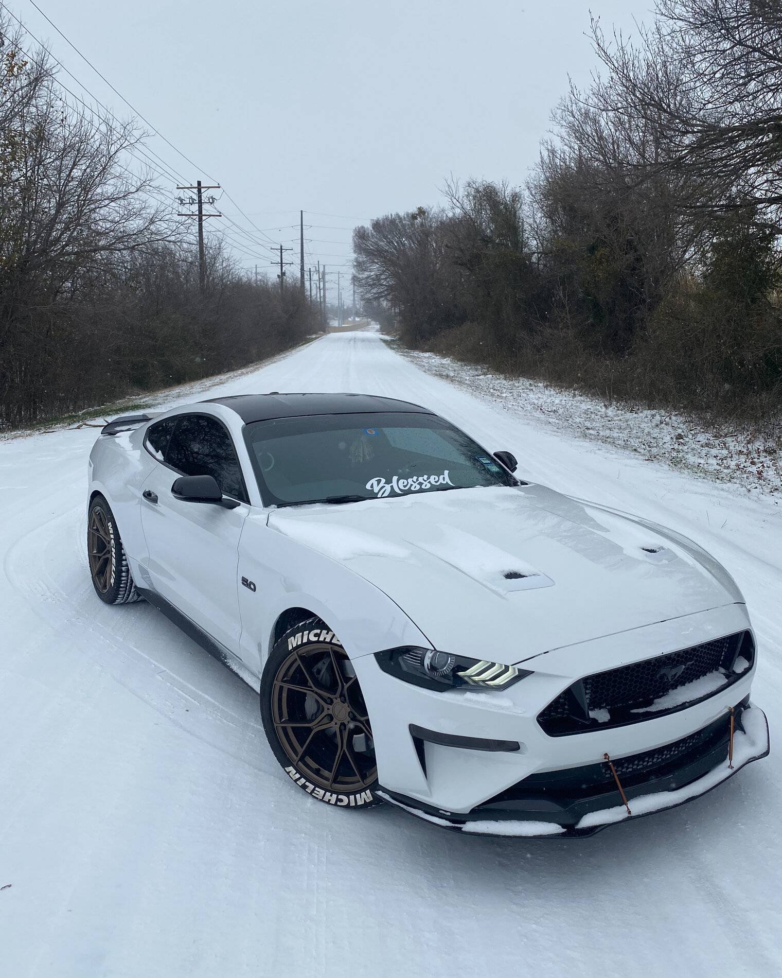

Did you need spacers for the front?i'm also running with a 285/35/20 setup. Wheels are 20x10 ET35 Lowered on Eibach Pro springs and Michelin Pilot Sport 4S tires. No issues that i can tell.![]()

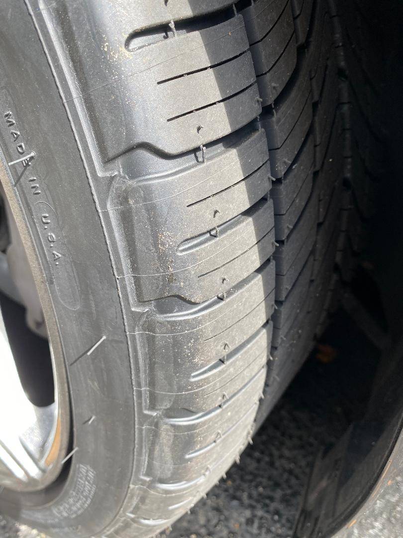

). Few marks on fender liner. All other tires are clean. Removing spacer to check how close we are to the strut.

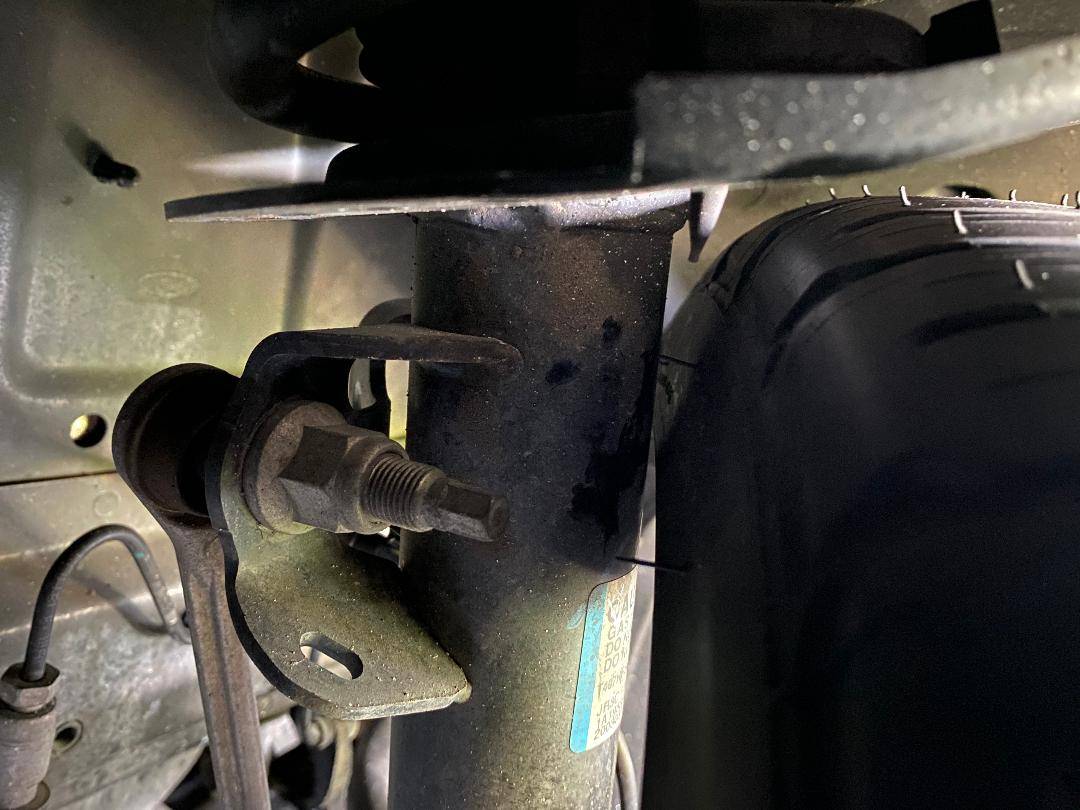

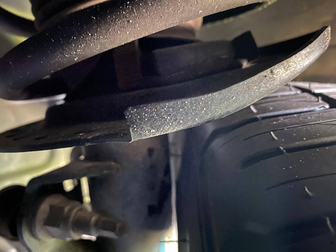

Spacer removed, as someone mentioned on another thread it IS tight!! So far seems to be okay, see pics below, angles might be a little deceptive however you may be able to slide a nickel or quarter in between? ... maybe.Running 285/35R20 (20x10") w/ 40mm offset, squared. BFGOODRICH G-FORCE COMP-2 A/S PLUS

UPDATE: Seeing minor rub front driver's side (guess I need to lose weight). Few marks on fender liner. All other tires are clean. Removing spacer to check how close we are to the strut.
