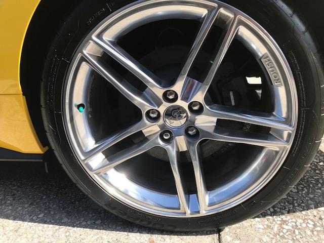

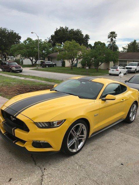

My 17 GT came with 20x9.5 275/35/R20 in a square setup. I had absolutely no issues. I went to the original black PP rims because i wanted that look. I think 285/35/20 should be fine
Here is a pic of my car with the 285/35/20's

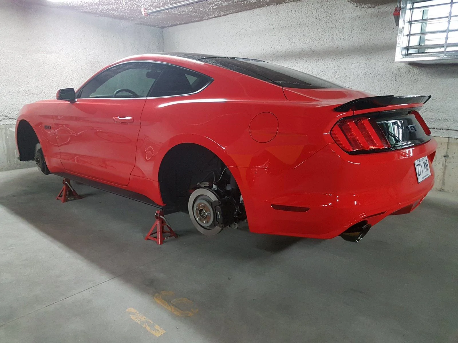

I definitely will!! I am very excited to get my mags because....this is what my baby looks like right now:

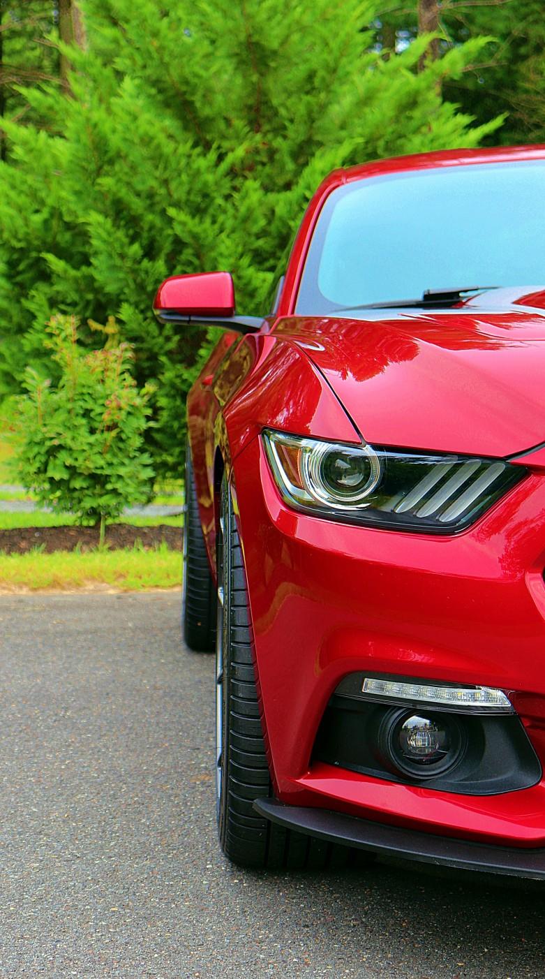

Ive been running 285/35 square on a 20x10 ET35 for a few months now. I dont get any rub when turning. The only rub i get is on big bumps, the tire will rub the inside of the fender. I could tweak the camber a bit more and probably fix it completely.
