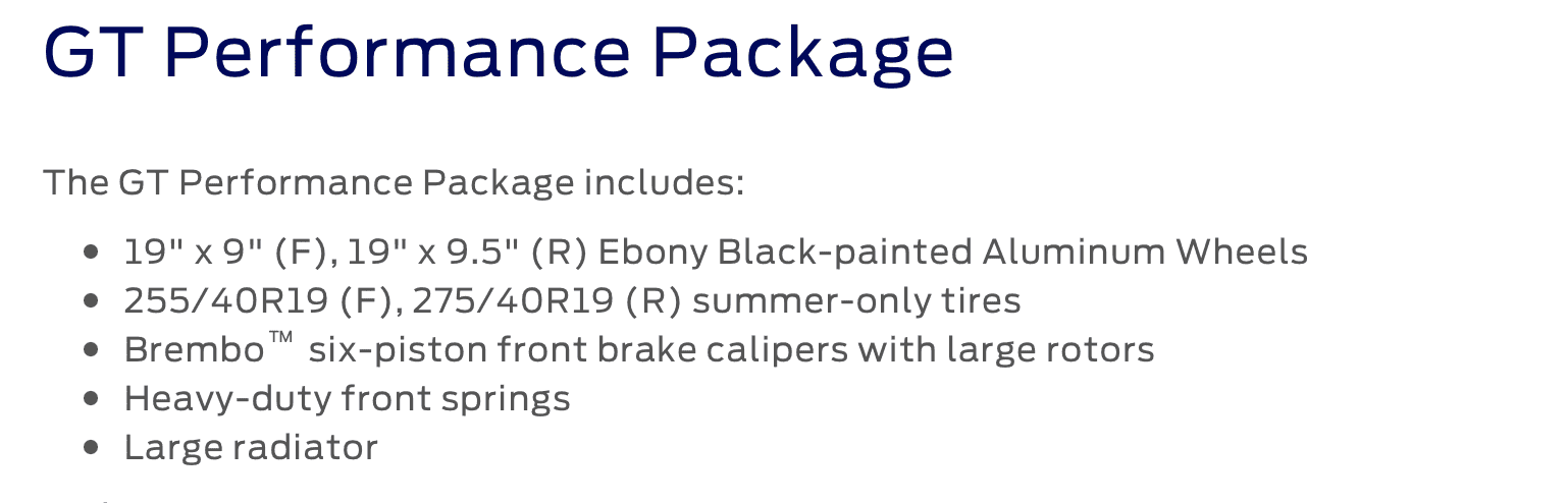

Also!!
To my knowledge, the performance pack optional upgrade is "not" available for the 2023 model. What I mean by this is its a very limited package. Only coming with the 6 piston brembos, front springs only, larger radiator, and the 19 inch wheels and tires. So, maybe the control arms and sway bars are stock on the '23 model??

Also!!
I can't understand what point you're making here, or what question you have.
2023 production is long over at this point.
