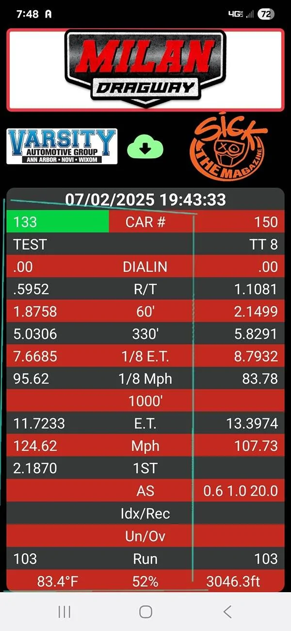

Any plans to run it down the drag strip? I’d like to see what kind of ET and MPH it pulls.
This was from my first time at the drag strip. I only got to make 3 passes. This was leaving with LC at 4300, medium boost setting. I switched to high boost in 2nd gear. Stock tire pressure, PS4 tires:
Manual trans? What kind of boost are you seeing at your different settings?

Not bad at all for a first time run on factory tires. The sixty foot is even decent. Did you encounter any spin during the runs? What gear did you trap in?
On my 3rd run, I tried leaving on the high boost setting at the same launch RPM: I spun as soon as I hit about 5,000 rpm. If I could have ran again that night, I was going to try lowering the tire pressure a bit.
I was trapping in 4th gear. I'm going to a roll race event at another track this weekend: I'm sure that will be in 5th (1:1).

I’m not sure what the M1’s tranny gearing is, but if you can on the next outing, try and trap in 3rd to see if that helps. I can trap in 3rd with my D4 tranny, but I have shifted into 4th several times. When I do, it always hurts my ET and MPH.
The gearing is very different in the Tremec, it is road racing focused. I was very close to the top of 4th going through the traps. As I mentioned before, 5th gear is the 1:1 on the Tremec, where I believe 4th is on the D4.
