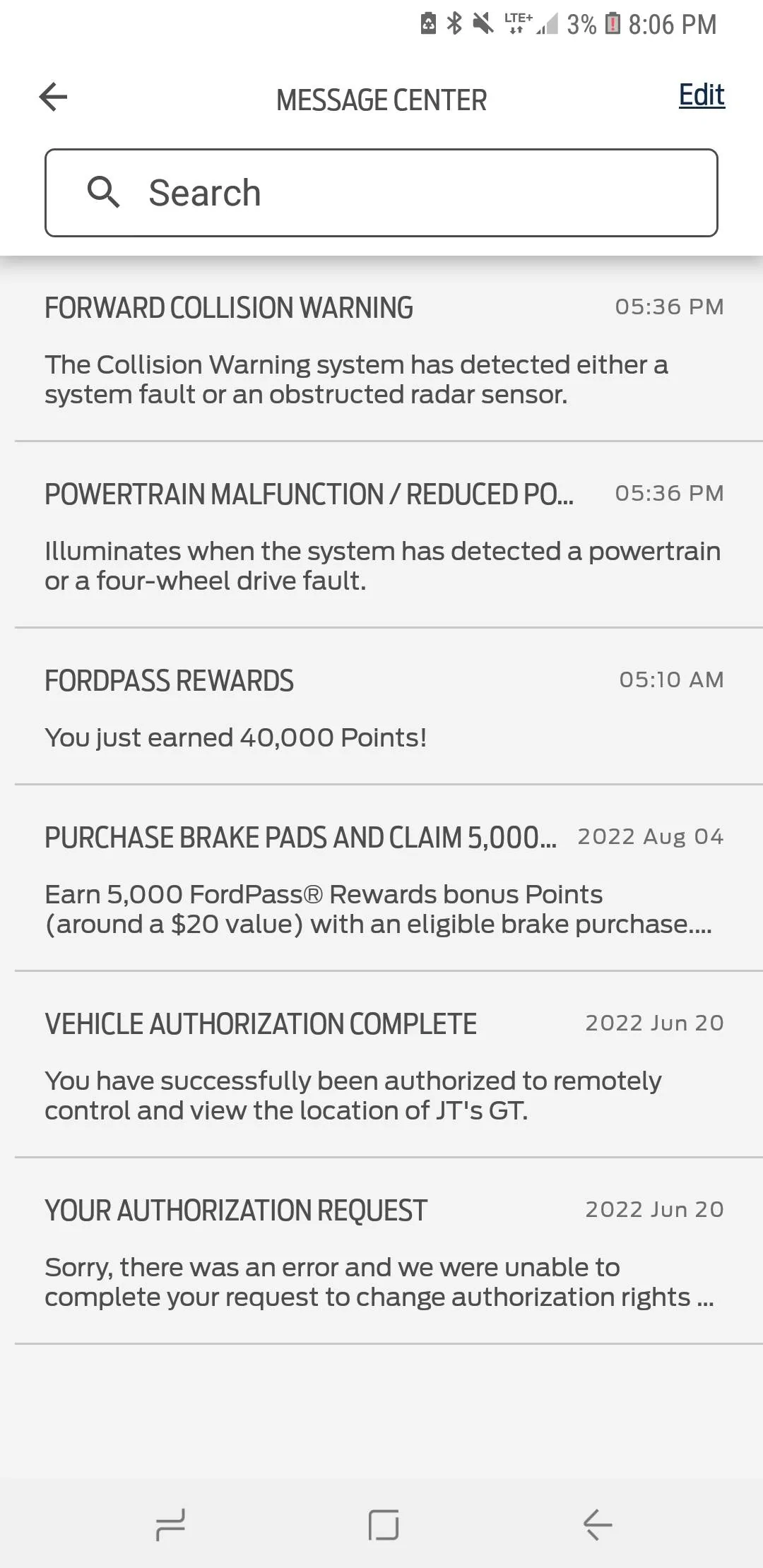

POWERTRAIN MALFUNCTION, FORWARD COLLISION WARNING
This is 2nd post concerning same issues. I had a Rousch air intake, JTL catch can and throttle body spacer added as 3 simple mods on my new 2022 mustang. After the mods, approximately 3 weeks owning her, were fitted I had these issues arise with the yellow spanner showing on the dash and the car going into limp mode. 3 times it went to fords, took spacer out, reset codes, then did a factory reset. The issue still happened usually at 70-90 Kph when changing from 2nd to 3rd gear. The air intake was checked by installer and it happened again. The car drives with a flat spot after the issue arises and Fords now have it for the 4th time. Anyone else had this issue and know the fix? I was and have not track raced it. Pics are of my ford app, Thanks for reading posted on other site

I ended up taking the roush air intake out and putting the old unit back in. Thetechnician at fords said he could force the codes to come up with the roush intake but not when the original air box was back on. I’ve not had any issues since. Upset that such a simple mod can cause so many issues. Good luck with yours
