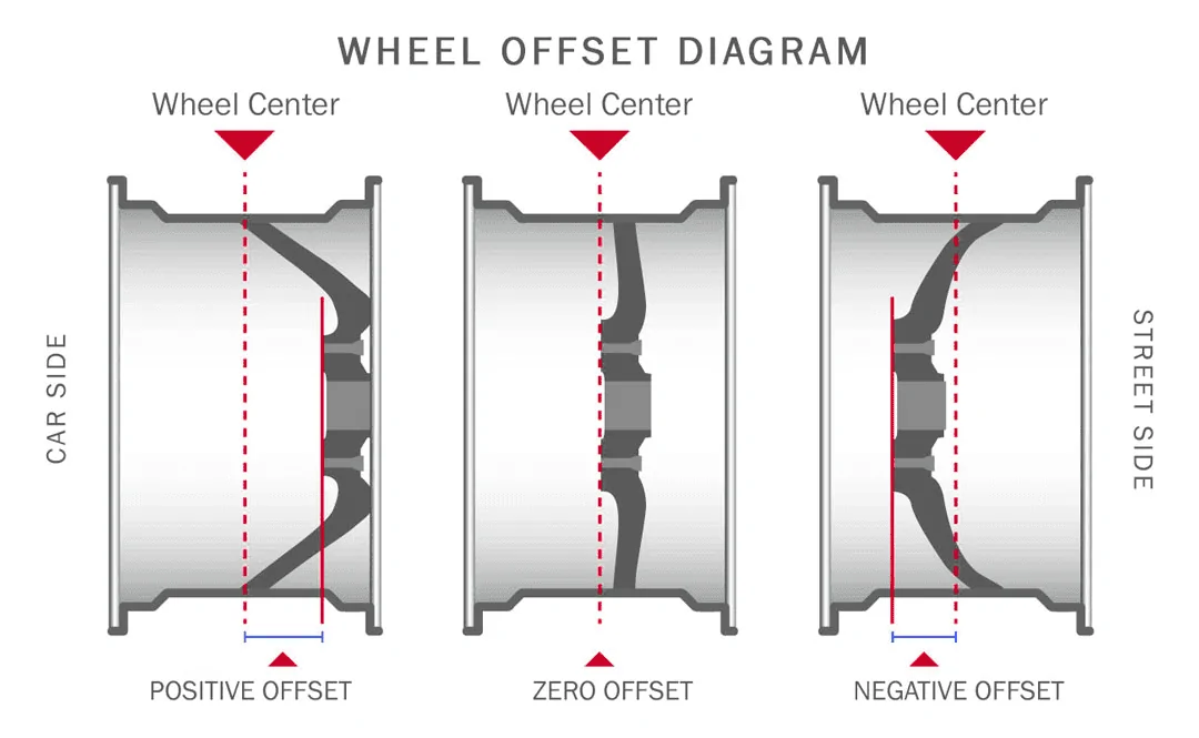

Exactly which one has the correct offset, I dont see any.
Help me out, I'm a mechanical weenie... the offset is the distance between the spokes and the calipers of the brakes?Exactly which one has the correct offset, I dont see any.
Is that w shaped structure, the brake caliper?Offset is the distance between the actual mounting surface of the wheel - think back side of the wheel behind the holes for the wheel studs - and the mid-point of the wheel width as measured between the bead seats.
Norm
Okay. So there is an offset for the non hp wheels to consider when shopping for new wheels ? What is the range for that?No. This is a section view of the wheel alone. That 'W' shape (most apparent in the positive offset image) is the wheel's center and spoke contour.
The caliper would be on the car side of the 'W', located further inboard due to rotor and rotor hat dimensioning. The spoke shapes obviously still have to clear it.
