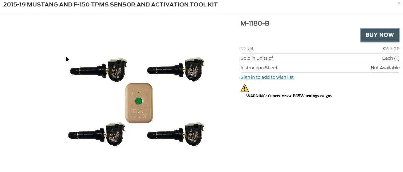

Also, if you get other wheels you have to consider the TPMS for them. I think this is the part you need too.
