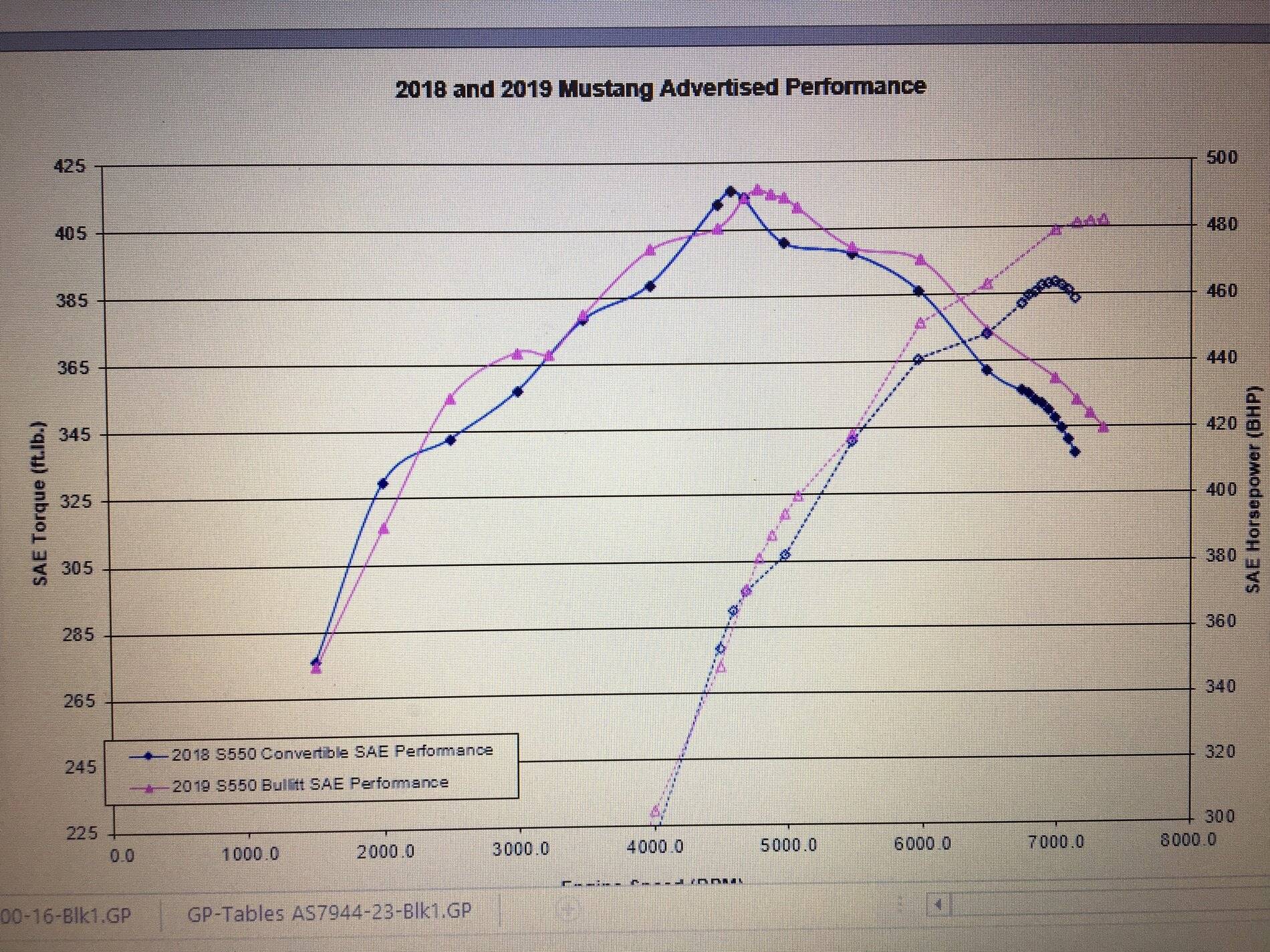

This is the only head to head I’ve seen and it’s one of those generated graphs
Reminds of the Ducati V4 vs V4R graph that got a lot of shit a few months ago lmfao

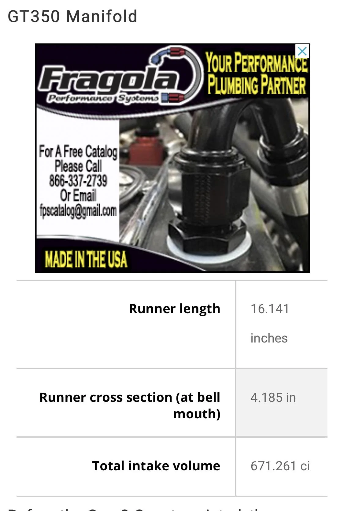

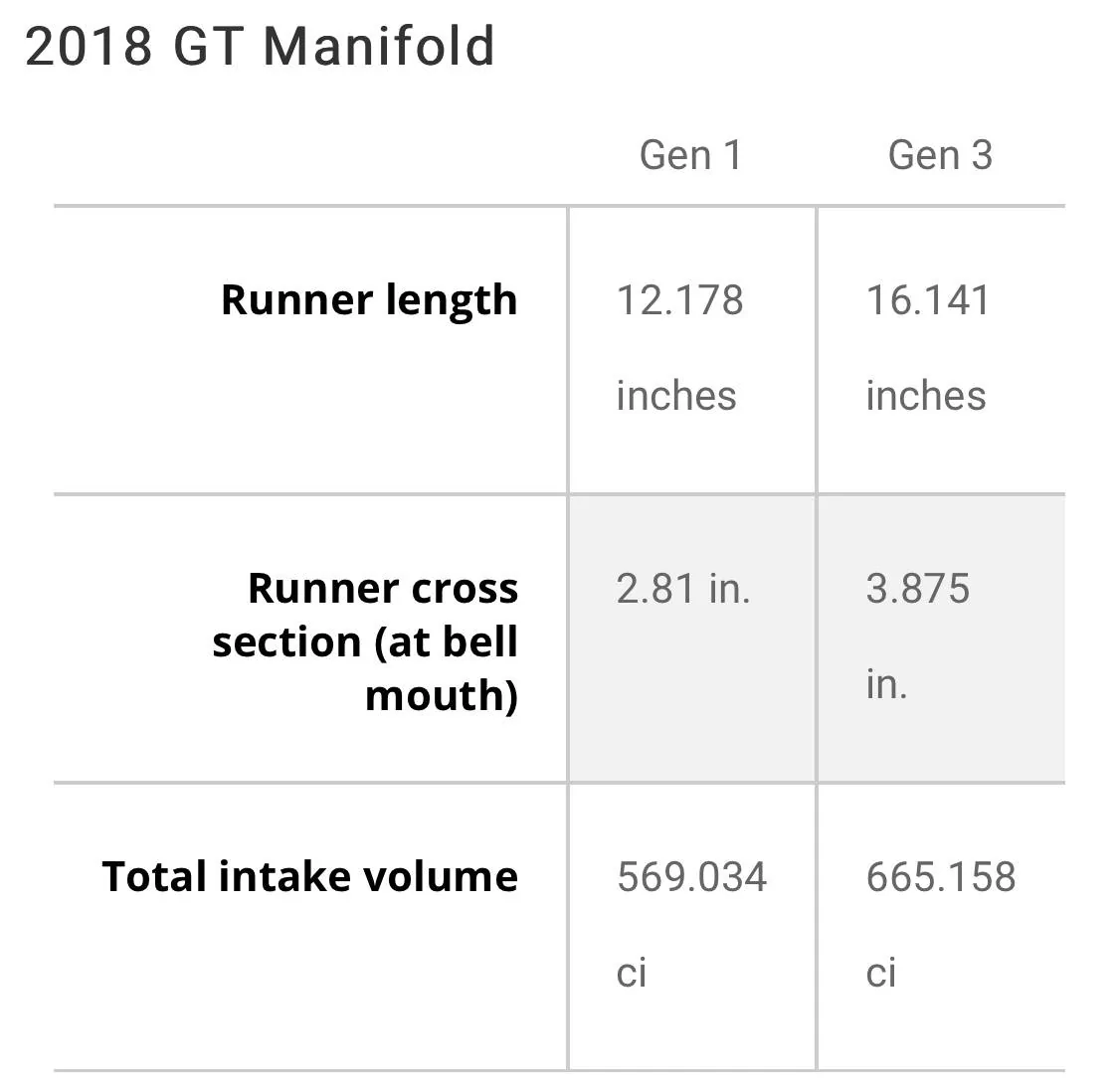

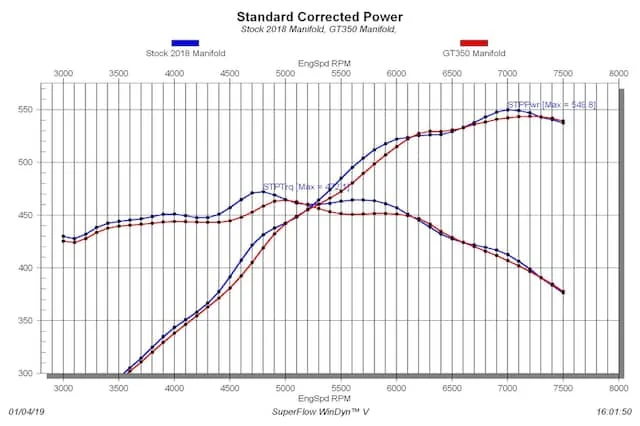

GEN 3 crate engine
Stock gEN 3 intake vs gt350 intake
It’s an apples to apples comparison but as far as i know they didn’t do any tuning changes for the manifold testing just put it on there and see what happens

Just for comparison sake here is more data for y’all
with how good the gen 3 intake really is most of the gains are going to come from extra tuning, the 87MM, and the gt350 cold air package. It’s all a cumulative affect, which is why in the dyno above the results don’t look very good for the older gt350 intake manifold

It's also that on a stock engine nothing is really being done to make it need more air flow then the Gen 3 intake offers. Taking the RPM out to 8k may show a bit of a gain for the GT350 IM at the top end. It also depends on if it's the same tune for both, or if the tune is changed to take advantage of each IM in any way. I suspect that on a FI engine, or one with higher-comp and redline the GT350 will shine more as it has more flow. At that point it will turn into more of a Ported Gen 3 vs GT350/ported GT350. Anyone doing that would likely just have what ever stock intake they have ported to save money, or use a CJ intake at that point and call it a day instead of spending the added testing/money time though.
The problem is that there are a lot of variable and many places dont mention in much detail what they did to account for them, or aren't very clear what FULLY was in the testing (ie any potential retuning).
IMO the line goes Gen 3(better low end) = GT350(better high end) -> Ported Gen3 -> Ported GT350 -> CJ.
Unless you are doing a purpose built engine there is likely no reason to spend money on the CJ, and for a generally daily driven car with light weekend fun there isn't much reason to spend $ changing your IM or porting it. Now if I was going to have a daily driven car that I often road raced, and staying Naturally aspired then I may got to a ported Gen3 or GT350 for the better top end/higher RPM flow.
