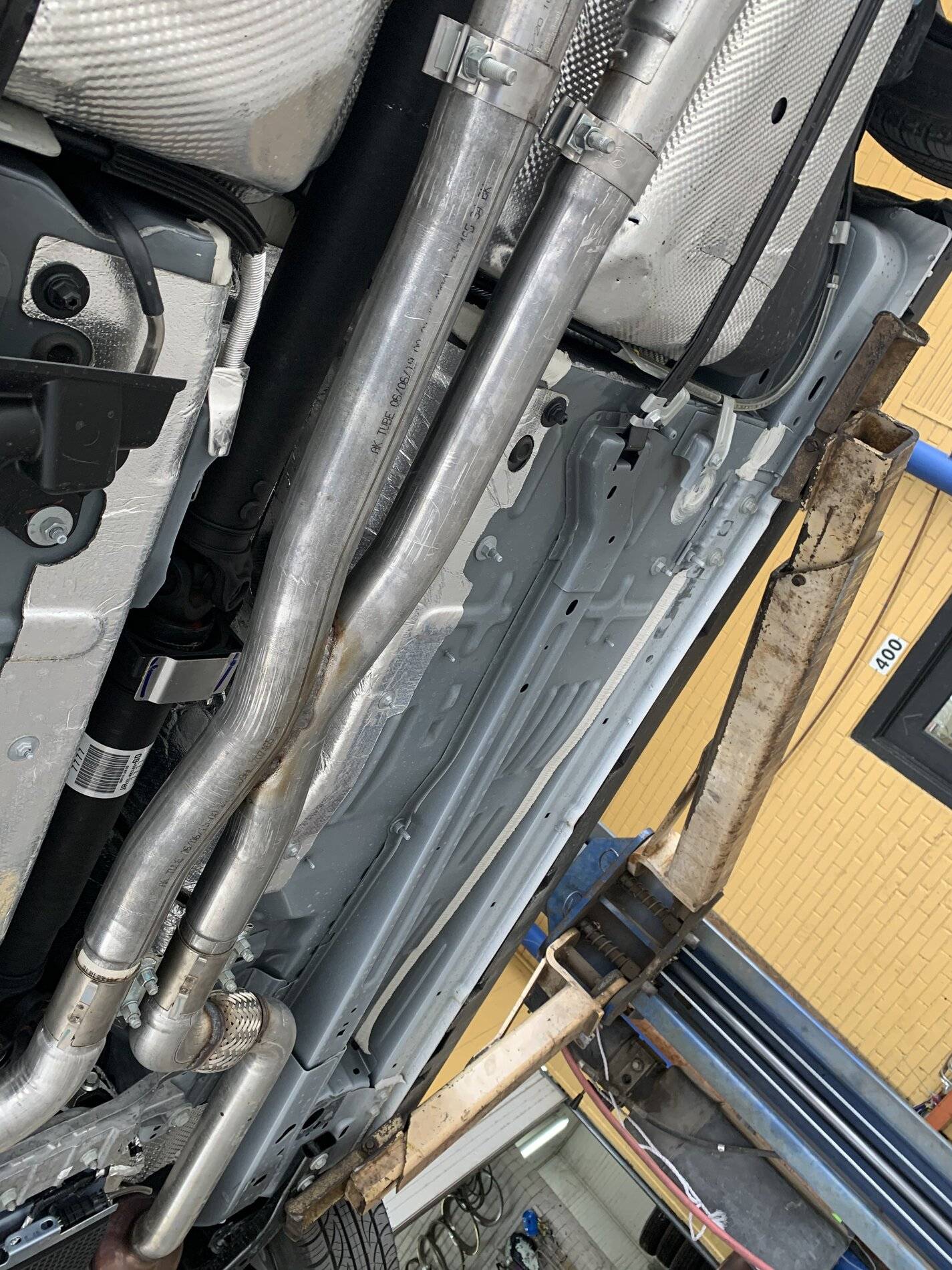

Hello all, I have a stock 2021 and ordered a roush h pipe. I read online and watched installs and thought that it was just a cut and clamp up install which I was going to buy the tools and do myself but I had a shop quote me a lot cheaper than just the cost of the tools but after taking the car there they were saying I need a couple of inches of piping fabbed to make the roush h pipe fit? Is 2021 any different that 18-20? Or are they just trying to hustle a few more bucks lol

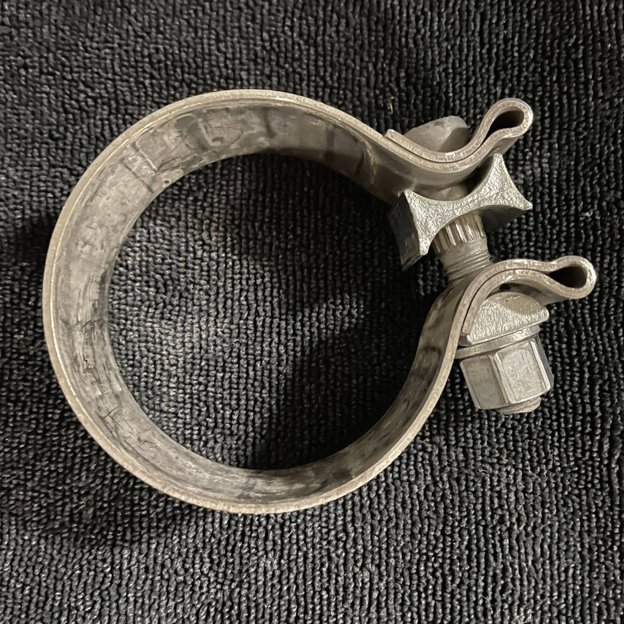

Oh no, two completely opposed opinions, and we're not even out of the first page!
Sounds like Roush might have put together a better kit.
Egads! I hope we can disagree and remain civil :)
Here's a pic of a clamp that came with the Roush H-pipe. As I said, I didn't have any problems with them, YMMV

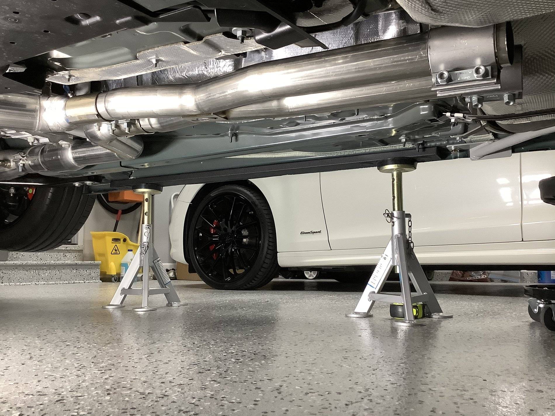

br_an
Jun 28, 2019
1,314
1,750
Boise, Idaho
Bran
2016 Shelby GT350, 2020 Ford F150
Here, you can see the HD clamps are on the rear of the x-pipe which is now ready to be mated to to the rest of the exhaust.
That's the "Belt AND Suspenders" equivalent of heavy duty clamps right there :crackup: I'm sure they work great :like:

I would hazard a guess that the roush is the ‘older’ length of H pipe (a bit longer) so when the later cars came along with the heat shields welded to the pipes, the cut area is through the heat shield.
Garage moves cut due to heat shield = H pipe a bit short ?
I know Steeda did a ‘newer’ H pipe (a bit shorter) so you can cut before the heat shield therefore leaving them in place.
