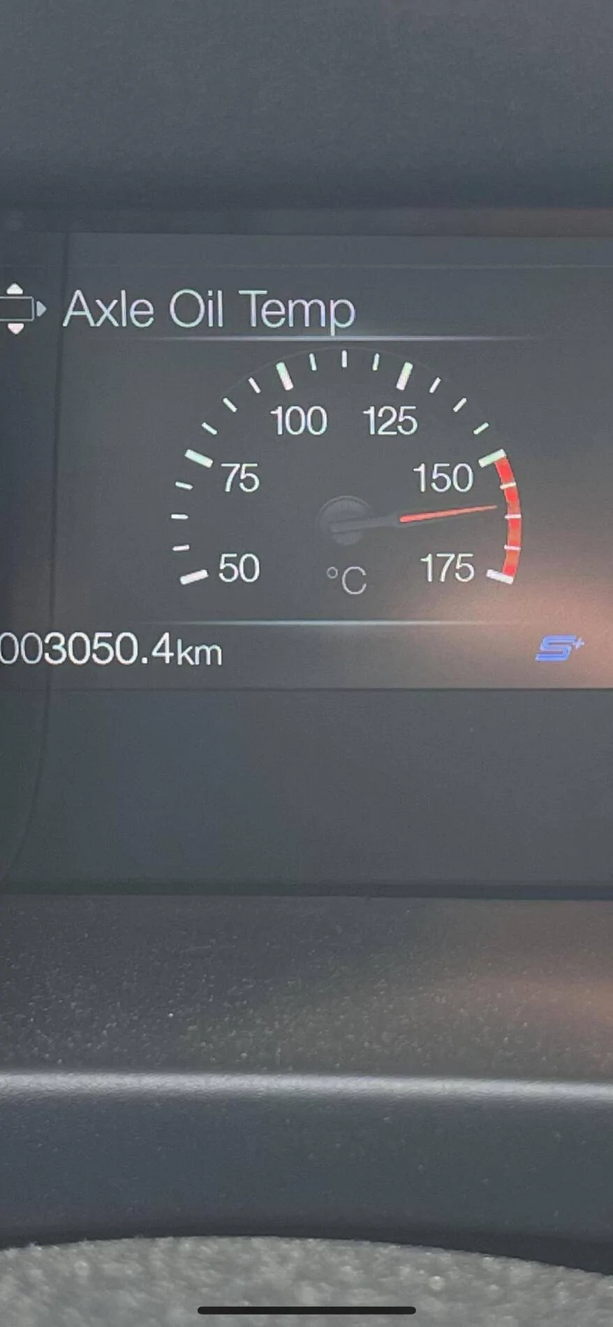

The stock PP pads survived, but they were inadequate. After 5 hard laps they would really start to go downhill. Boiled the RBF600 after a 30 min session chasing a much faster car (Mclaren 570S) so that was the end of my day. Rear diff overheated numerous times, and engine oil overheated multiple times as well. Pretty bad showing for what ford claims the car offers...
I will say the pads did dramatically better than expected. I'm going to pull them wednesday and see how they look.

Noob question but; how did you know the oil and diff overheated?

How will you rectify this for the next outing?

The solution is a $2500 cooler that adds 4 failure points, huge complexity, and weight.
I'm going to try a higher capacity finned cover, and better fluid and see. If anyone has suggestions for a good finned cover, i'm all ears.
