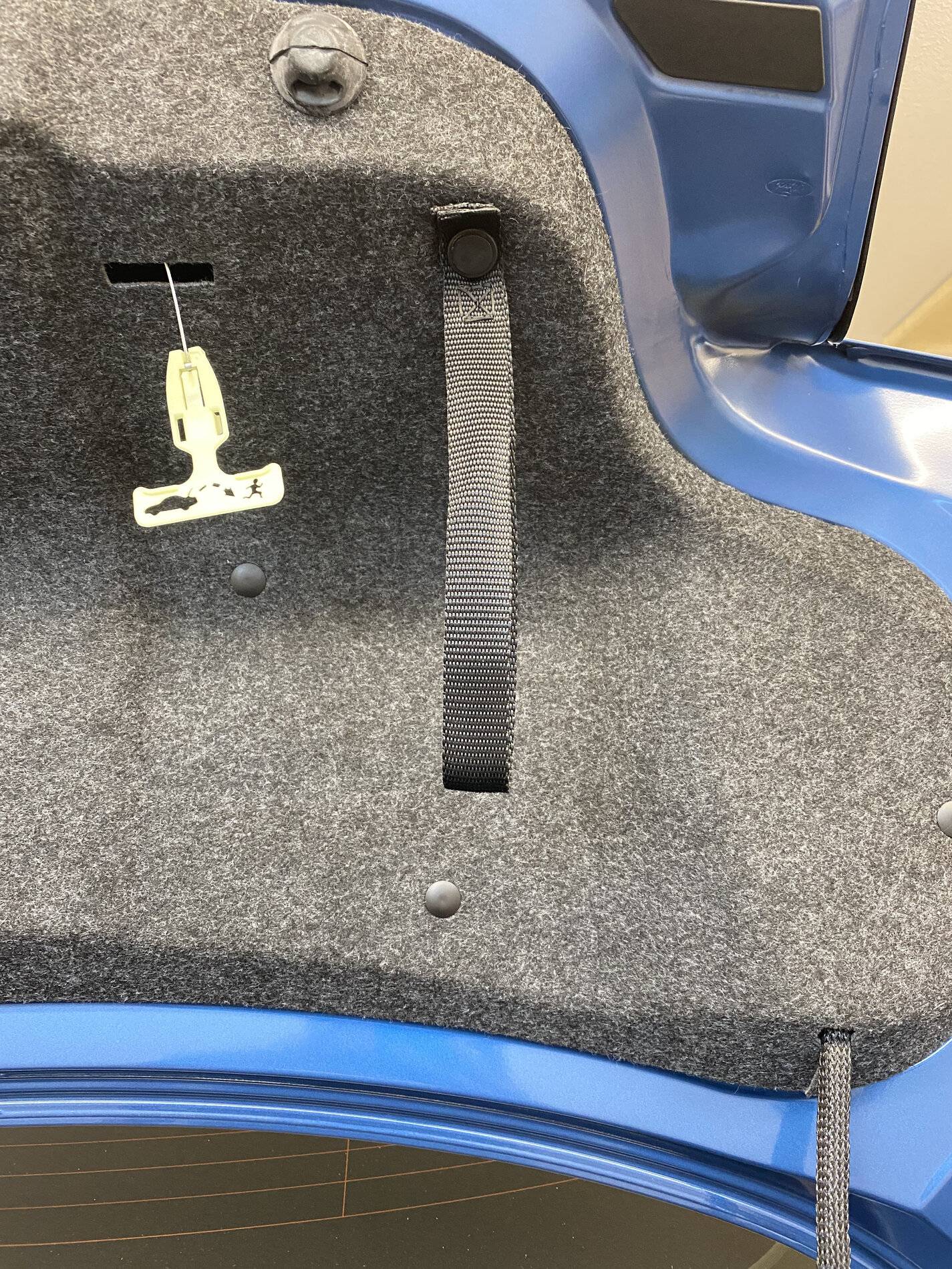

About the pull strap for your car take a look at this thread. I went with the Hyundai strap and a really snug pushpin from eBay - works like a charm and I love it so I don't have to touch the decklit panel. it is strong enough to just yank it down

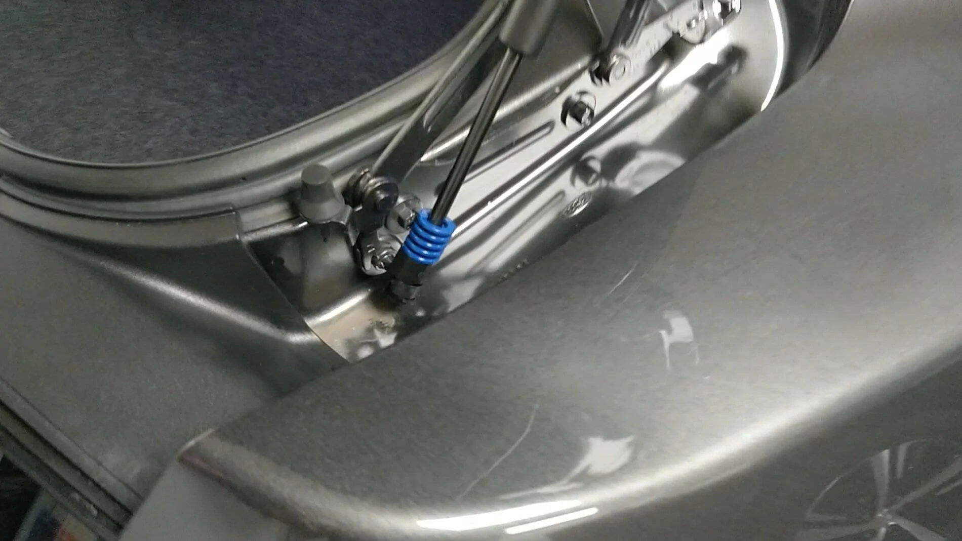

I bought a set of Compression die mould springs that fitted on the struts on the car. In that way when opening the trunk it pops up an inch or so. Just enough to get your fingers under it without touching paint on the decklit panel or on the bumper.
I hope it helps you in your mod :like:

Where did you get the strap?
I got the strap from a friend who said it was from a Subaru and used a tight push pin as Ras did above in his post. The strap is a little long but it works, however I am thinking to change it to a shorter TRS pull strap like the one below. They are available in several colors too, not just black in case you want to go that route.

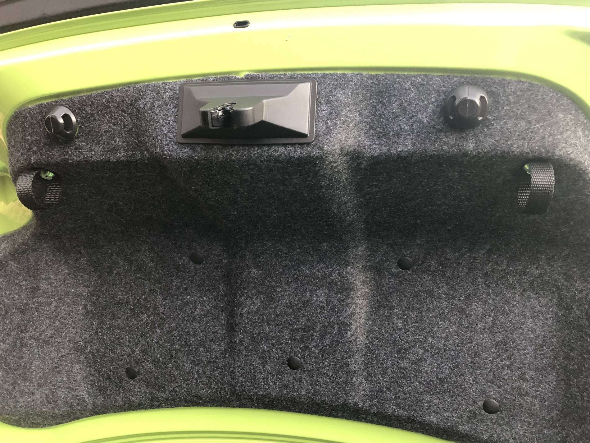

On another note and to give you yet another option, here are my colour coded trunk pulls :

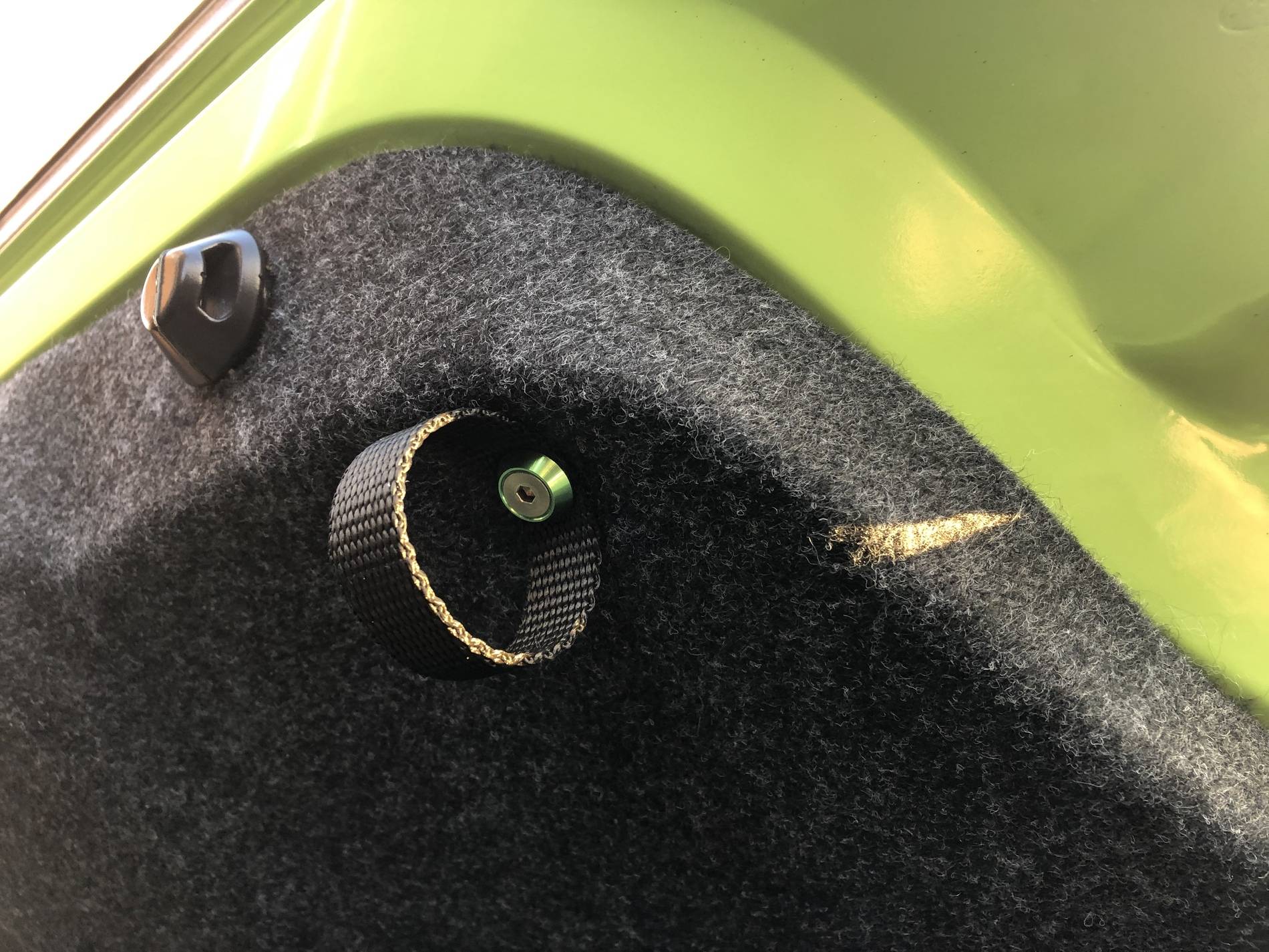

One on each side mounted in the push pin holes :

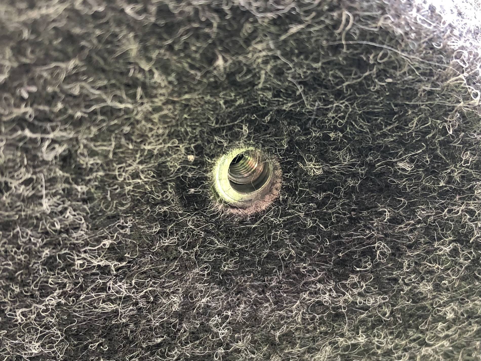

M5 rivnuts are a perfect fit for those holes and I used a stainless penny washer on the back of the panel to spread the load :

I really like those trunk pulls you have. Much cleaner and classier than the pull strap. Not sure if they would work well enough with the added stiffer struts as I might need a little more leverage. I frequently close my trunk with just one hand as I sometimes have something in the other so I would only install one of those pulls. I think it just may work. Thanks for the heads up on the rivnut size too.

If you are going to use the rivnut / penny washer, use a M5 x 25 penny washer and drill the hole out to 8mm to suit the rivnut perfectly (rather than using an M8 washer with a poor fit on the rivnut).
Bit tricky getting and holding the washer in place on the back of the rivnut whilst it's set, but a piece of string helps along with a partner with slim hands ... lol
There are a few more photos in my build thread if the above isn't clear :like:
