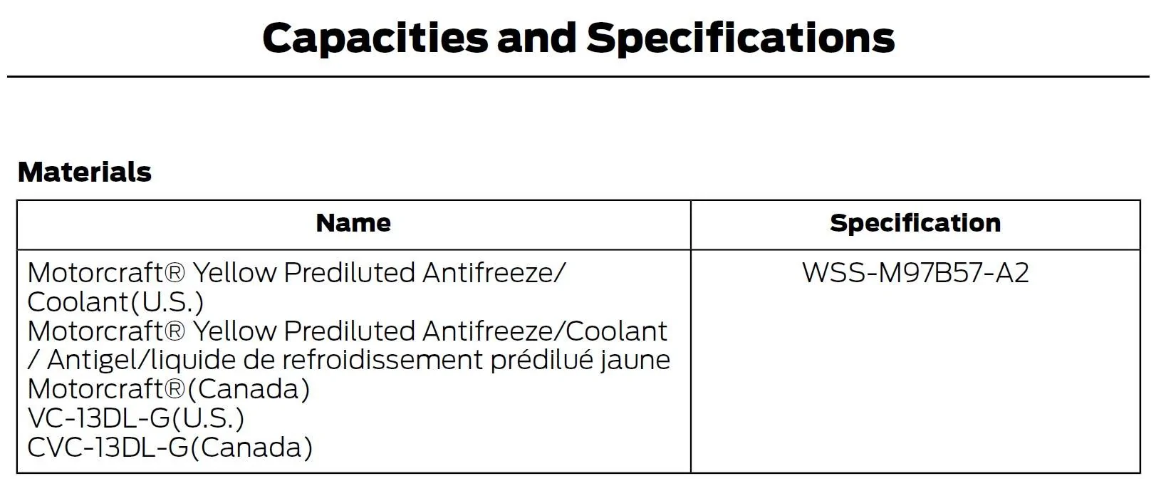

I was looking at the details in the Shelby GT350 Owners Supplement and it states the 2020 MY GT350s should use Motorcraft Orange Prediluted Antifreeze VC-3DIL-B for the US, and CVC-3DIL-B for Canada. My 2020 GT350R came delivered with green colored coolant. ??
Was the change to green colored coolant a 2020 MY change, and the manual was not updated? What is the Motorcraft PN for the correct green coolant?

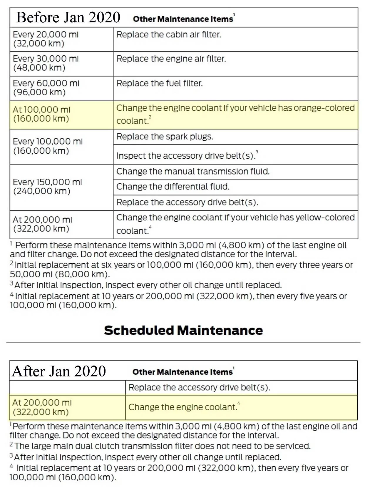

For some reason it doesn't show up in the latest GT350 manual, but it does in the latest GT500 manual. They changed over to the Yellow (Green) antifreeze this year and it started with the Job #2 cars.

I was questioning this because I purchased an extra gallon of coolant from my dealer when I bought my car. They sold me 1 gallon of "yellow" coolant. When I was looking at the coolant reservoir tank, the installed coolant looked green. So based on the information above, it sounds like they sold me the correct coolant and in this case, "yellow" is in fact "green" looking.
Is the part number for the gallon VC-13DL-G? Also, what do you mean by "Job #2"? I've heard of "Job #1" before. Not sure how this applies to this coolant change.

Another change with the Job 2 (after Jan 2020) the bubble bump antenna on the roof was replaced by the Shark Fin antenna.
Advantage of using the Yellow Antifreeze.

I guess it is better to have the yellow (green) coolant...it lasts longer. Although it's going to take me 10 lifetimes to get 200,000 miles on this car!
