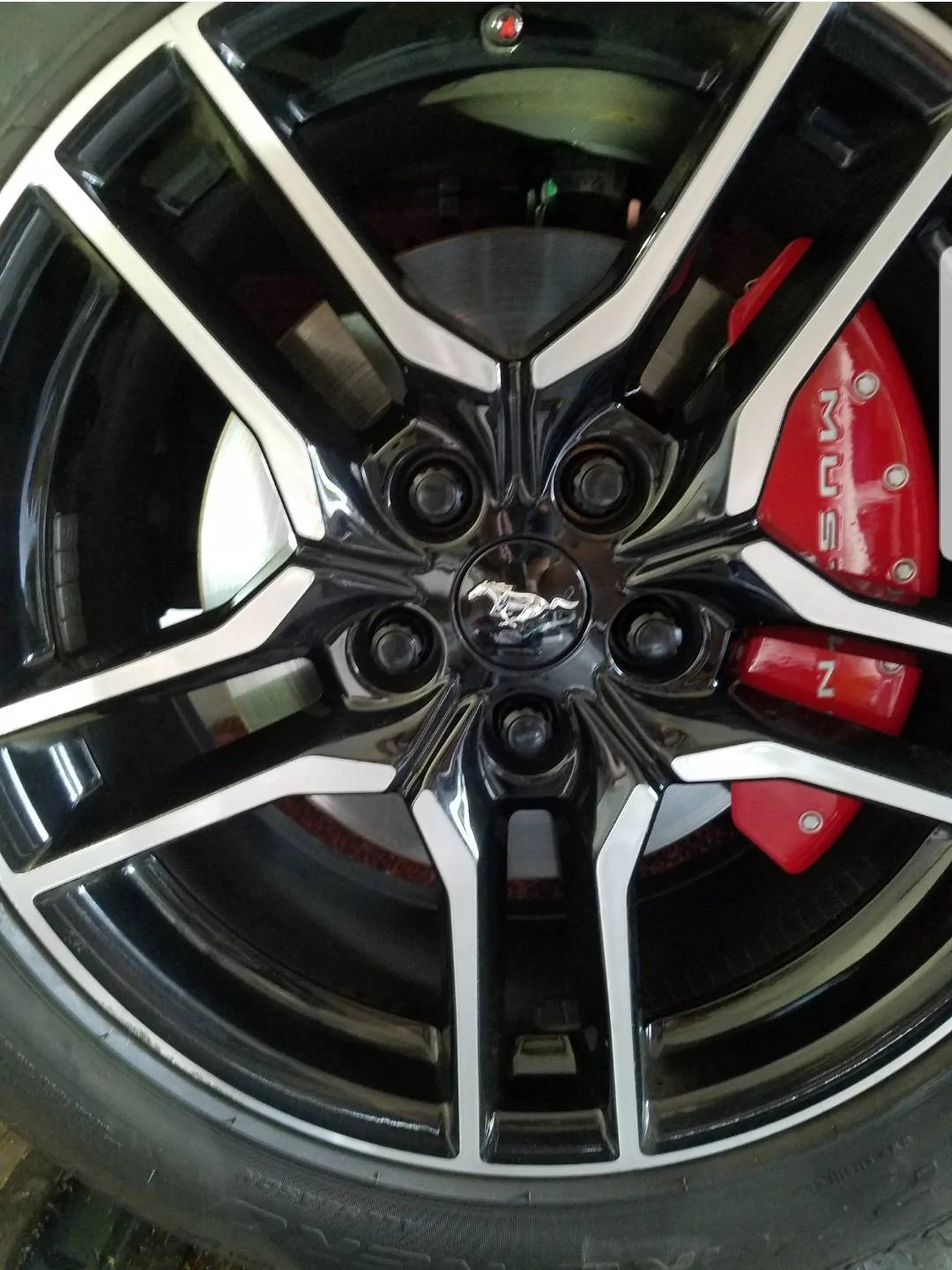

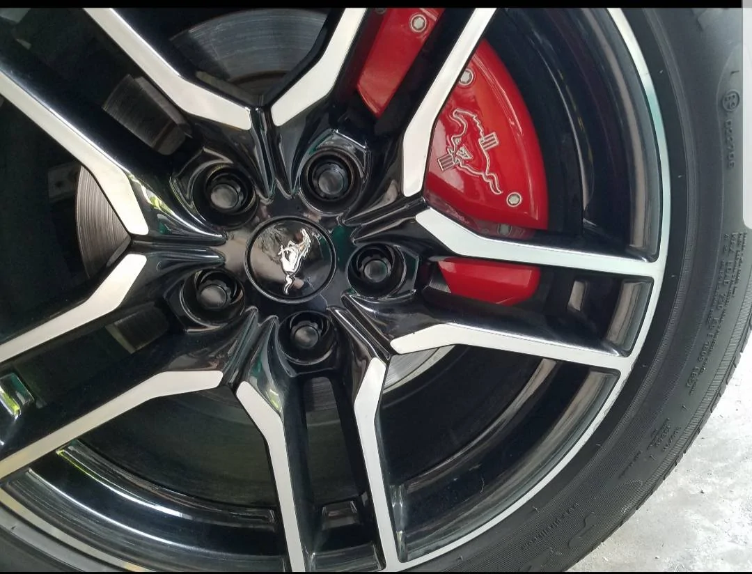

You say you have the right covers. But are you sure? The EB Premium has two different front brake possibilities. The standard Premium has 2 piston front brake calipers. Tha Performance Pack version has the 4 piston version up front. They are not interchangeable. The rears are the same on both.
Mine went on ok. There was a learning curve for installing the brackets but each wheel got easier and they all installed fine with no interference with my 18" factory wheels.
2018 non pp car but I don't think anything changed brake wise to the 2020 car.
This is the kit I bought with them installed.
