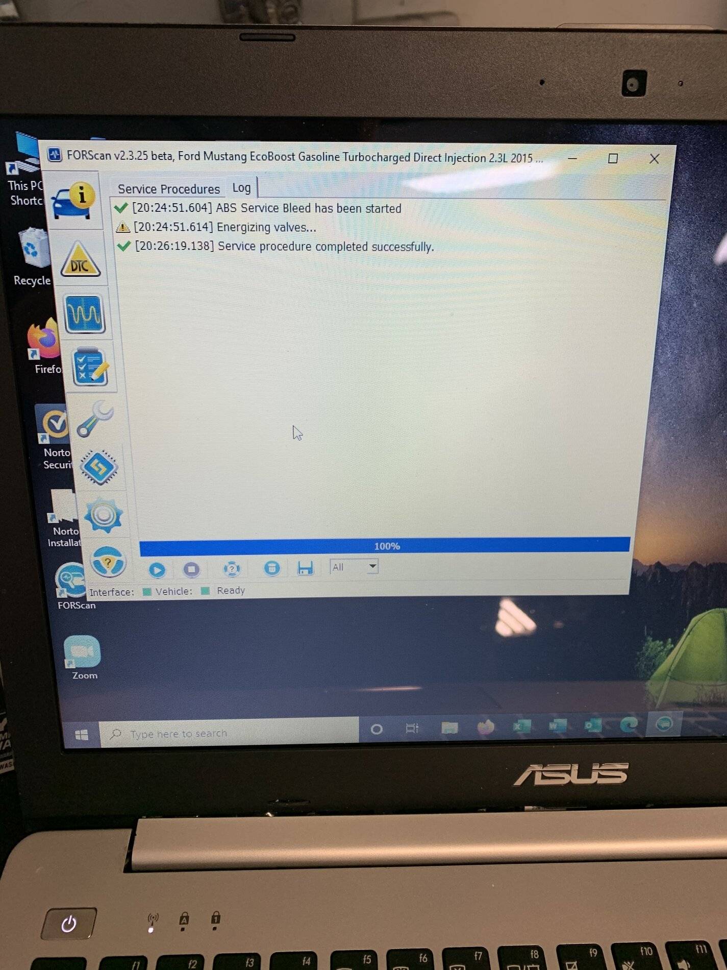

Yeah it actuates each abs line one at a time with someone in the car to push any air out of the abs module into the lines going to the calipers. Perform the abs service then bleed with a pressure bleeder like usual. Passenger rear, driver rear, passenger front inner then outer bleeder, driver front same procedure.
I know you probably already know the sequence just posting it up for those that don’t.

does having two bleed screws per caliper complicate the forscan process? watched a tutorial for a caliper with a single bleed and i was uncertain whether it purges for a certain amount of time, or until it senses no air. can this procedure be used to replace fluid with a higher boiling point fluid? Seems like a good tutorial for someone with a youtube channel :wink:

When I changed my calipers I also swapped in new Motul RBF600 fluid. All the ABS bleed does is push any air in each channel into the lines. From there you do a pressure bleed following the normal procedure removing any air from the system. Caliper position or bleeder doesn’t affect the process.

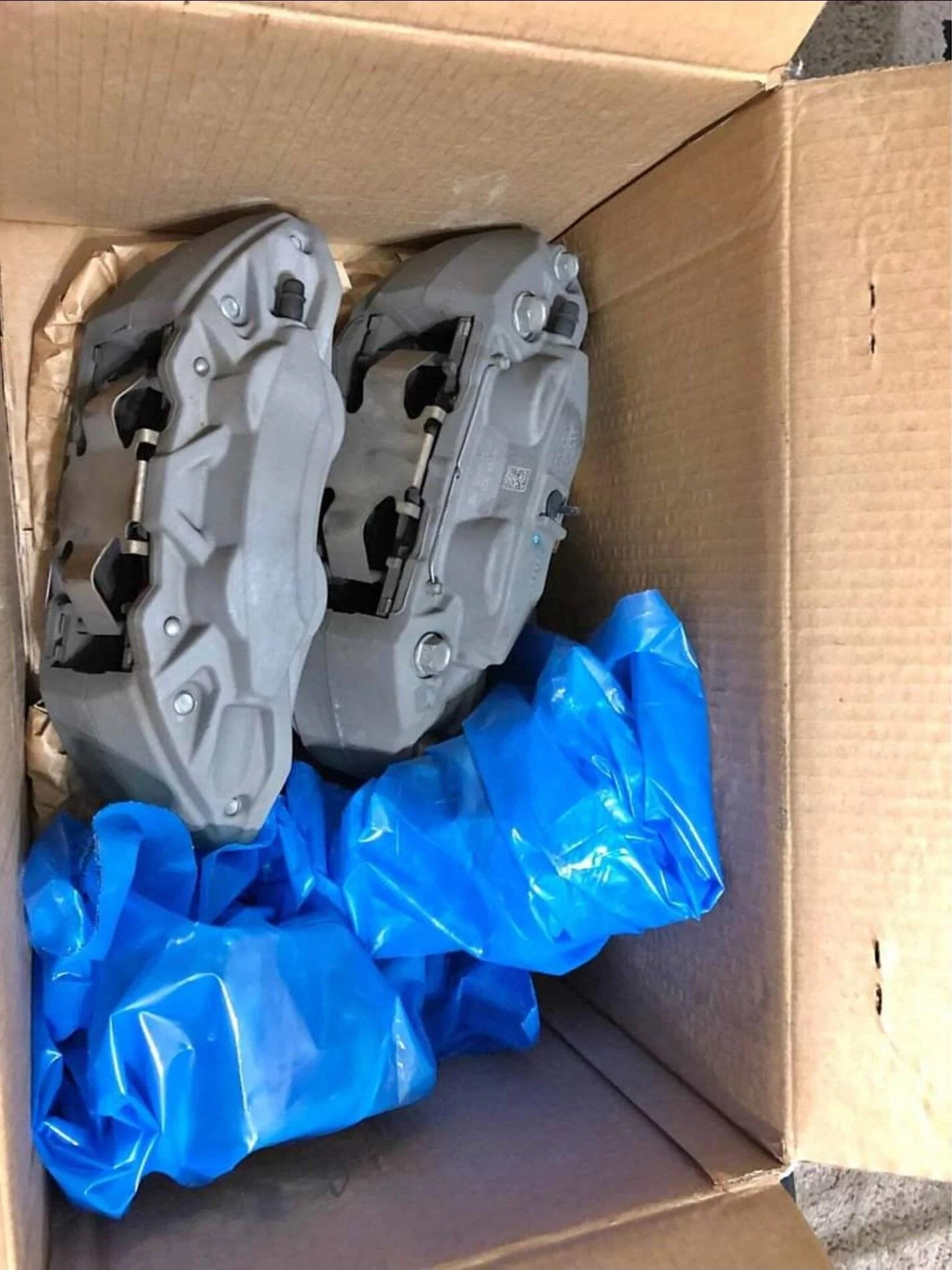

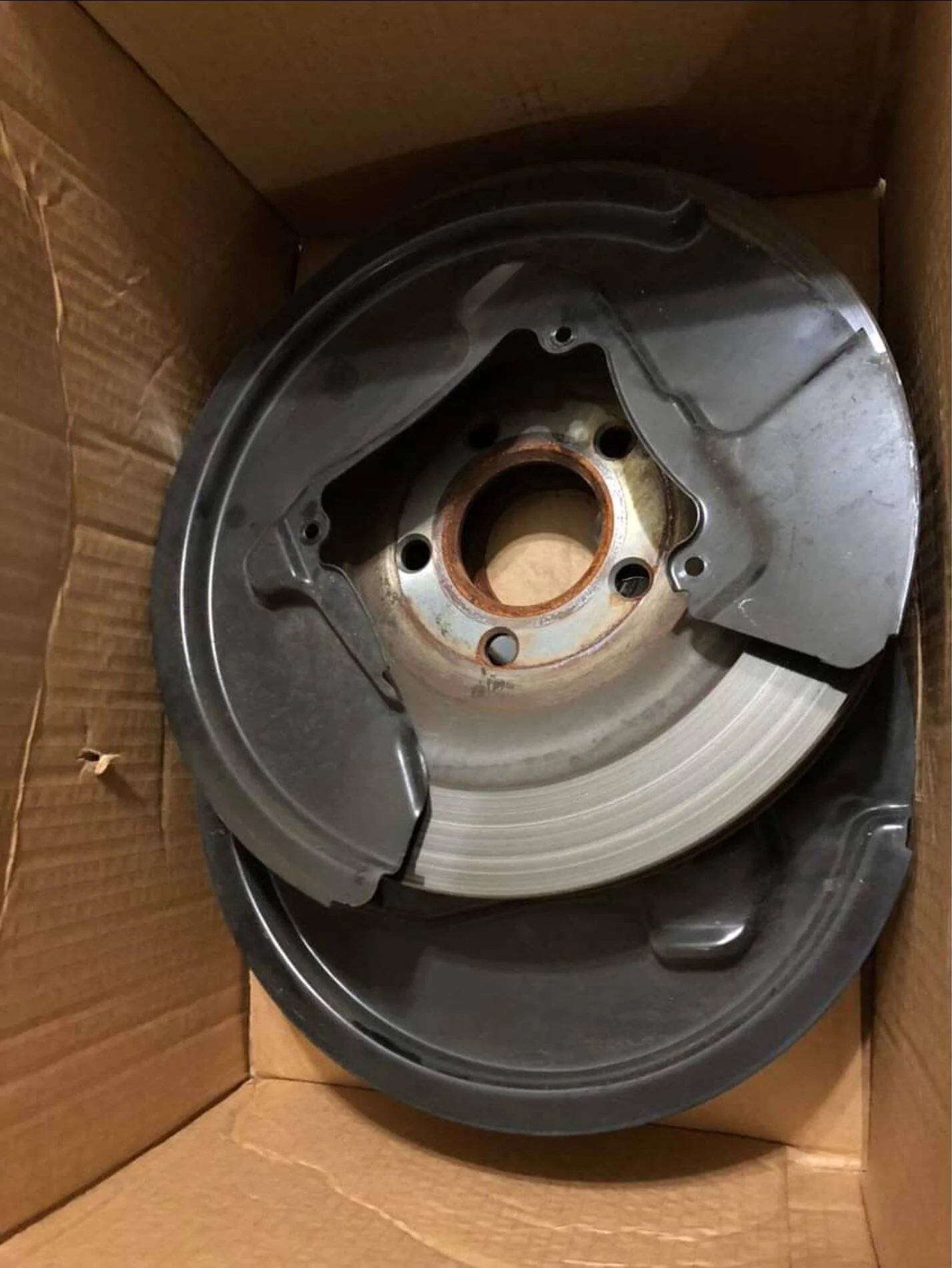

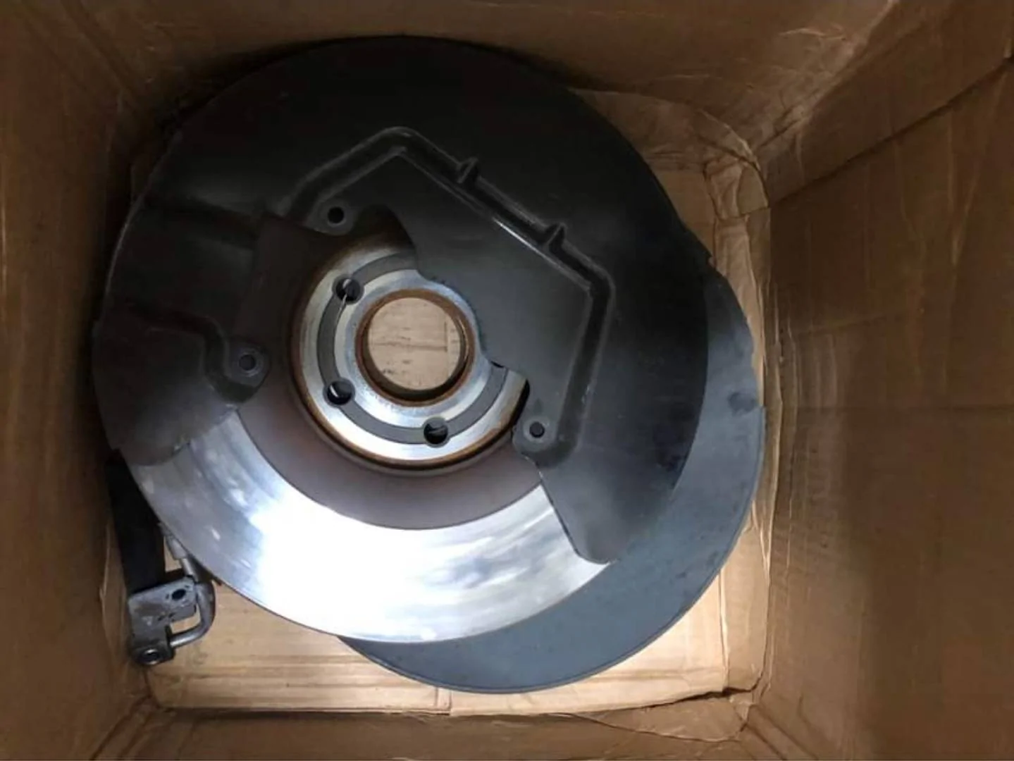

Hey guys, so I wasn't able to get the brakes I was looking at before they sold. My brakes are making the squel from low pads now, so I need to do this install, especially with driving 200-300 miles a day. I found these brakes, front and rear, from a guy in San Jose (see photos), with as busy as work has been recently I was thinking about paying to have them sent to LA and getting a shop to knock them out in a day. Though as far as youncan tell from the photos they look fine? He said everything is included, calipers, rotors, dust shields, brake lines.

I did the swap on my car to the 4 pot fronts from a GT. I haven't done the rear yet. Ill let my rear brakes pad wear out then change them to GT. Either way. All you have to do is swap the calipers themselves. Maybe change the lines from the stock 2 piston brakes. Then put on the rotors that fit with them. You do not have to change the dust shield. I didn't swap mine and there is no issues plus I believe it is the same part anyways. Other then that its really just swap, bleed the brakes, done. Rears should be the same too.

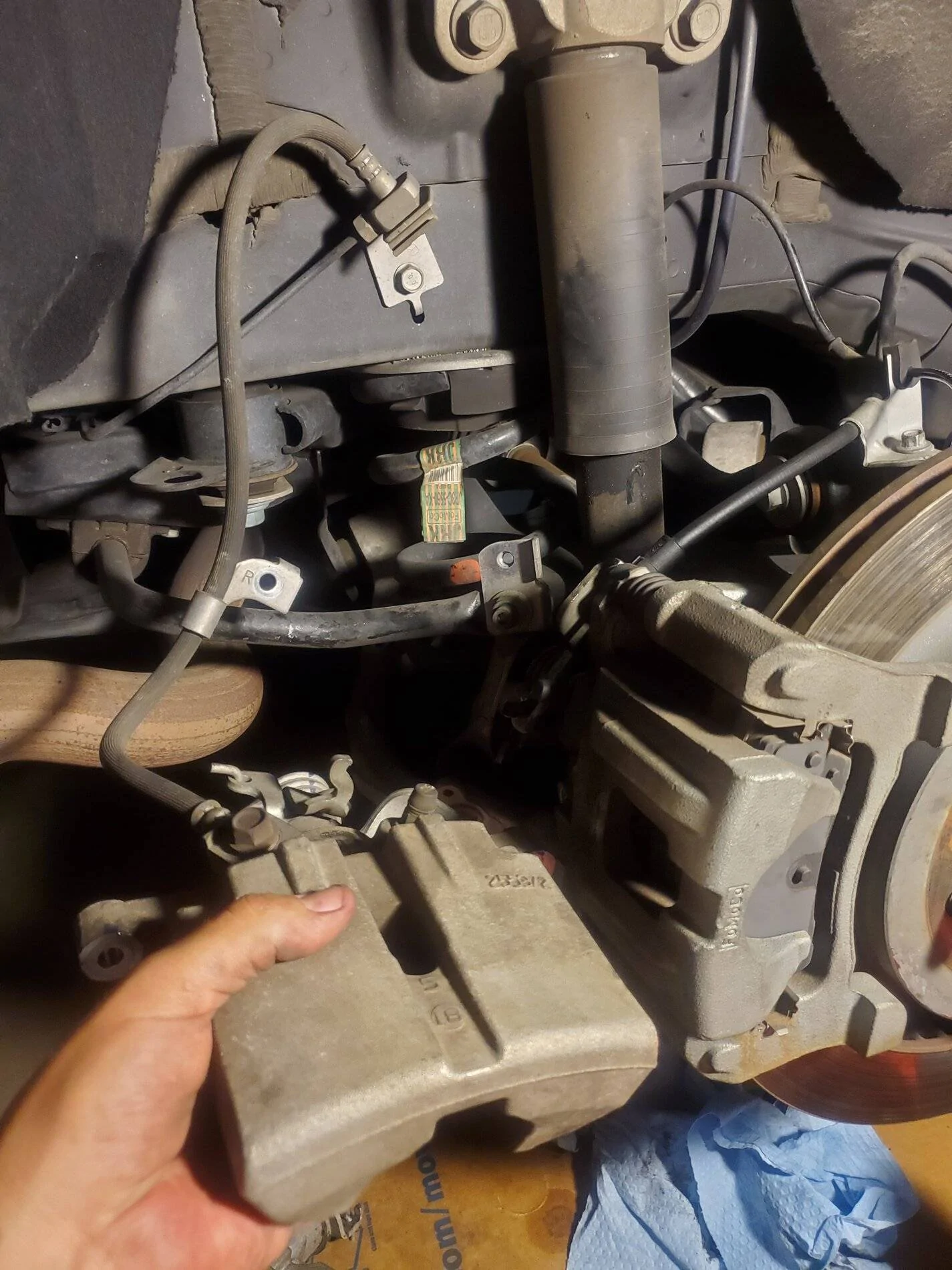

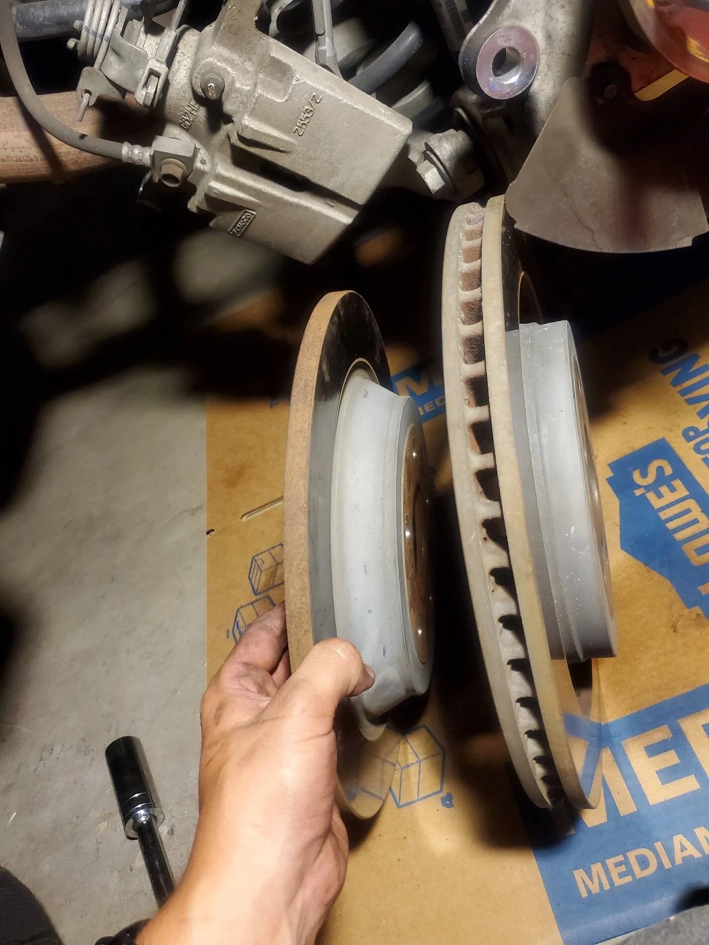

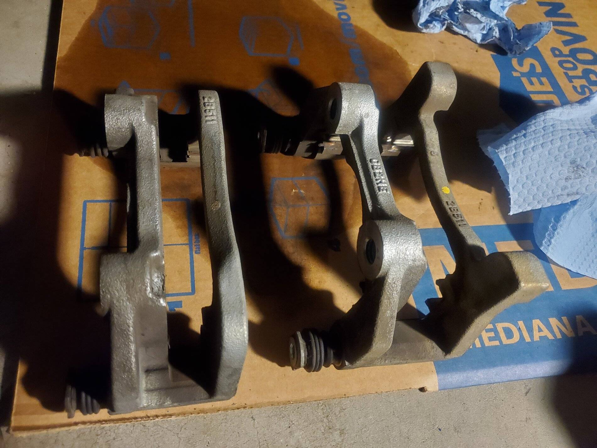

So I got the brakes and got started tonight, I only worked on the passenger rear side, I expected to just swap the original rotor for the new vented rotor from the GT. I noticed the calipers looked a little different
Upon installing the caliper back on I realized the original one wasn't wide enough for the new vented rotor, so I had to install the GT rear rotor instead.
Where I'm currently at and called it a rest for the night is at taking the brake fluid line off, can I mess this up? Will I send air into the line and cause problems? I plan to flush the system using the two person bleeder method once I'm done with all the brakes.

One thing you may want to invest in is a motive pressure bleeder. It makes bleeding the brakes a one person job. If you do end up with air in the lines you can get out or a low brake pedal you can use FORSCAN to do the ABS bleed service that helps get any air in the ABS module out and into the actual brake lines where you can then bleed the brakes like normal. I did my entire bleed back to front in less than an hour.
