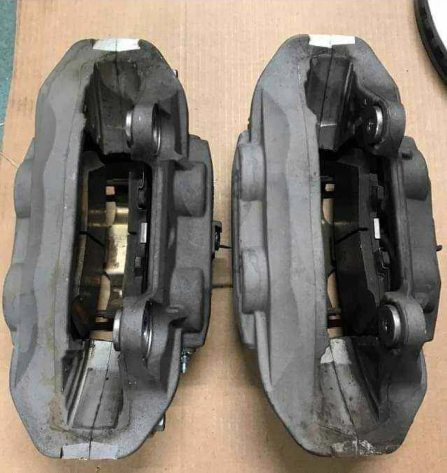

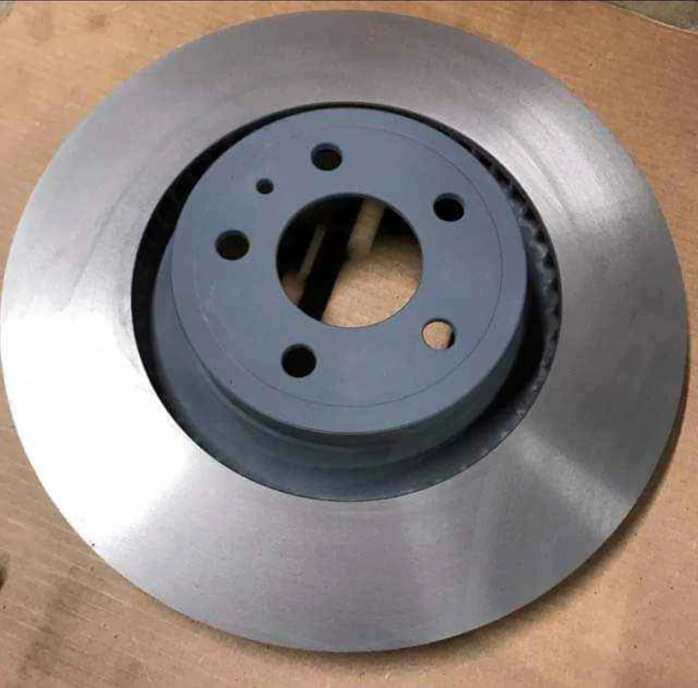

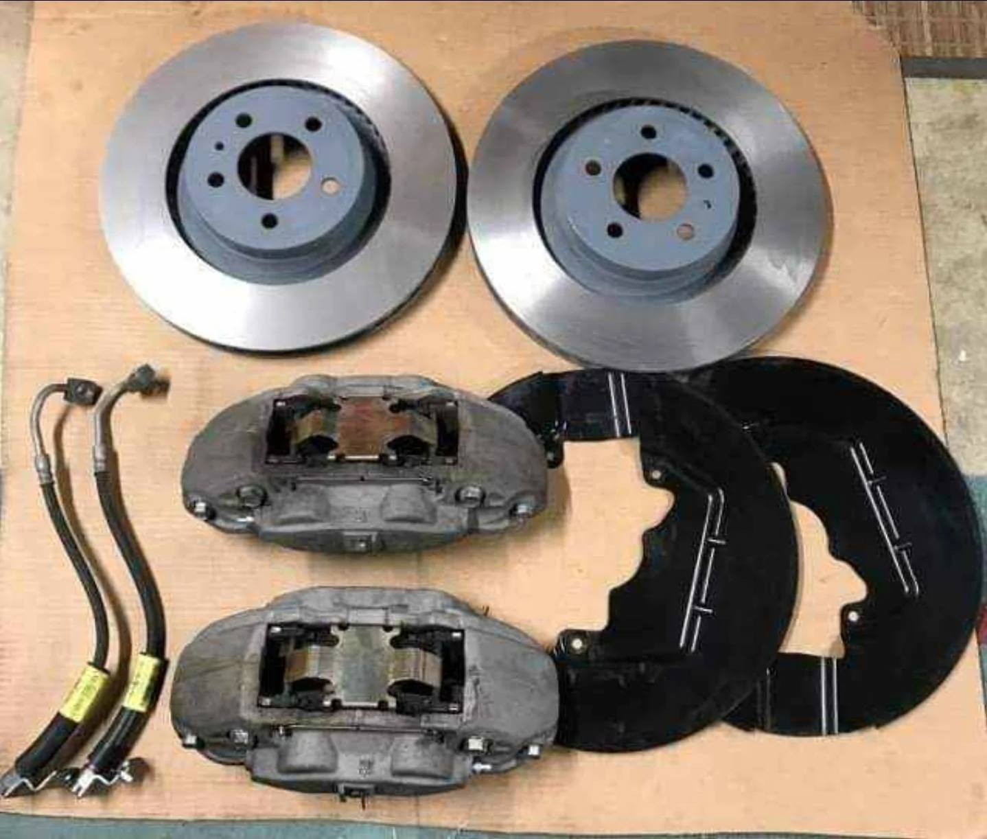

Hey guys, I have a 2018 Ecoboost premium, I need to replace my brake pads and flush the brake fluid. Figured while I'm at it I'd swap out the front calipers and rotors for the GT 4 piston. I found the front setup for $150, I attached some photos, is this all the hardware I'd need? Also what are some good brake pads? I'm keeping the rear calipers and disc's the same. The shop that's installing the calipers, disc's, pads and flusing the fluid is asking $350 for labor, dealer wanted $1,200

Yeah total joke, it was for like 5hrs labor with me providing the Calipers and parts. They said something like $189/hr. Left real quick, I just do warranty work there and everything else myself except the transmission (and brakes I guess, lol).
Ima grab those brakes I showed in the photos, are any parts missing?

Yeah
You need
gt brake lines
Gt dust shields
Gt brake pads
Gt calipers
make sure you buy those new crush washers/banjo washer or whatever they are called. Don’t buy from dealership
assuming the crush washers are a single time use? Where is a good place to buy them?

I bought mine aurozone or whatever. Ford wanted like 30 bucks for all of em. I forget, bought them all for 6 or 8 bucks aurozone

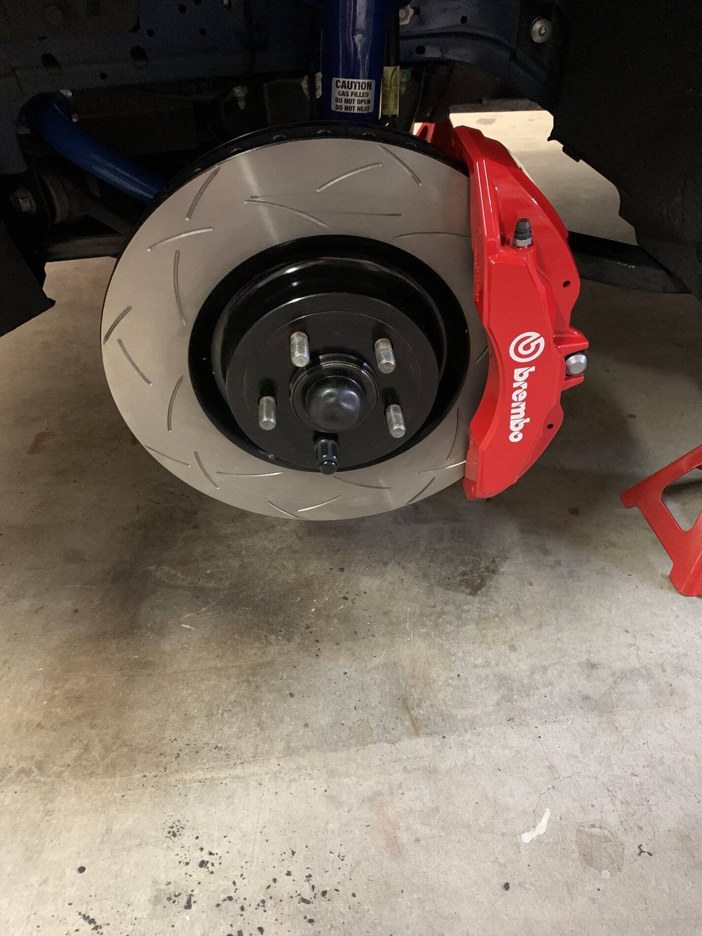

If you’re even remotely handy with wrenching on the car this is. DIY job. I just swapped from the stock GT brakes to the Brembo 6 piston calipers. Literally it’s 2 bolts that hold the caliper to the knuckle. Rotors are floating.
To do it yourself I’d recommend a motive pressure bleeder (opmustang.com), $75, dead blow hammer $10 on Amazon to knock the rotors loose off the hub, brake bleeder bottle ($25). Those 3 tools you can swap and bleed the brakes yourself. A fraction of the price and you have tools to do it yourself the next time you bleed the brakes.
