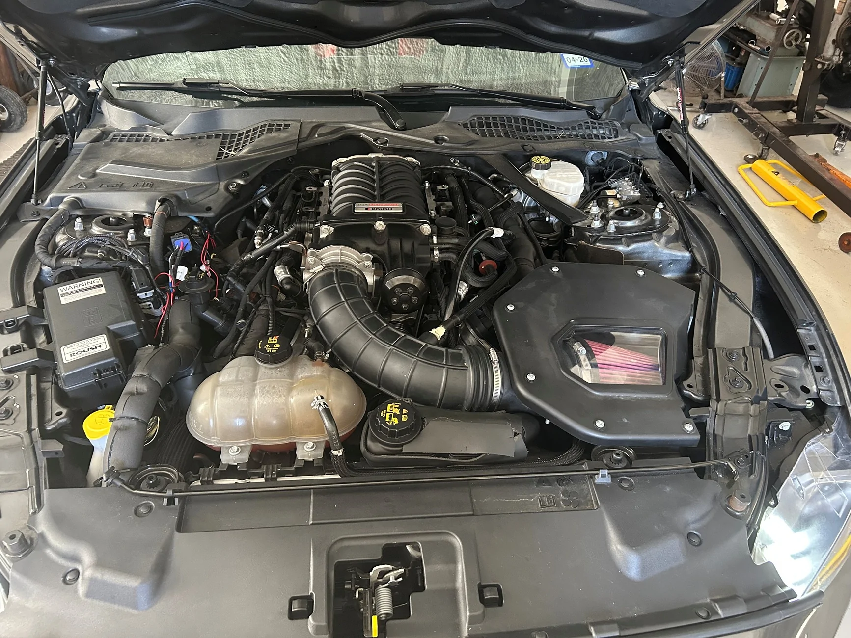

I am in need of parts to remove a Roush phase 2 supercharger kit on my 2019 mustang gt. I was T boned at an intersection and my car is a total loss so id like to get an intake to put car back stock. I bought with supercharger already installed. I have factory parts for everything else. Anyone got any parts or advice? I have the installation instructions i can figure out the removal i just need parts to keep it a running car.

If you have the instruction/installation manual it should tell you everything you need. Everything it says to remove/modify to install/replace with the Roush parts, you will need.
Basically go through the install manual in reverse to be able to identify and list all the parts you need to return, so you can source them before tearing it down.
You'll also need a way to flash the stock tune back.

You will have to figure out flashing a stock tune, if you dont have a tuning device you may have to get one unfortunately. For the intake manifold I would look for a used intake manifold try here, ebay, or parts farm they have tons of used stuff cheap. Then just take your time with everything. Again sorry this happened best of luck

I’ll have the car 4-5 weeks while disputing their appraisal. I bought the car with the Roush kit installed so I do not have the stock parts. I’m in need of I’m guessing a stock intake with injectors and airbox.
