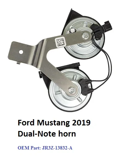

I recently purchased a 2019 Mustang GT. The first time I locked the car, the beep from the horn sounded like a cheap econo box from the 90's. Having previously owned a 16 EB it did not sound correct. My EB had one of the 2 horns go out during warranty which was the sound the 19 made. Thinking i got a bad horn from the factory I did some research to find that 2019 mustangs (Built after 5/18) come with a single tone horn. This is frustrating for a $50,000 car!
Ford announced a "service replacement" part to change out your single tone for the correct dual tone horn.
Part # KR3Z-13832A (wrong part) I ordered one (begrudgingly) from Ford for around $25. It arrived today, it’s the incorrect part, still a single tone despite being labeled a dual tone.
The CORRECT PART is JR3Z-13832-A
This is an unfortunate cost save that really takes away from the car.
If your horn on your 19 mustang is weak, you may have the single tone. This has been noted on Bullet cars as well on this forum, but did not pop up easily when searched in google.

As far as I know, you have to order the dual-horn assembly, not just a single, additional horn.
Pero
Sep 30, 2018
259
183
Slovenia, EU
Pero
2019 Mustang GT Fastback Ingot Silver MT82 MagneRide B&O
JR3Z-13832-A is supposed to be the whole assembly.
Can someone confirm this?
