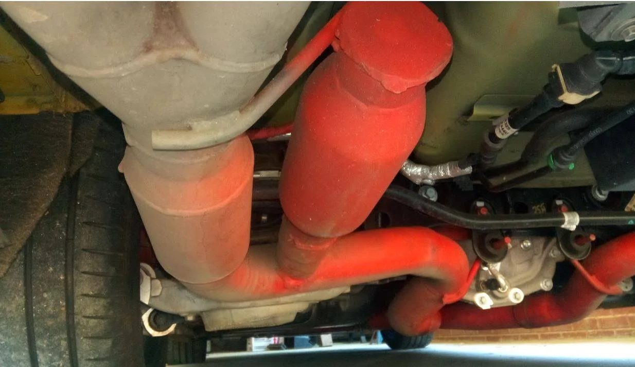

Adding a Helmholtz resonator is the only way to kill drone, and the cheapest ... I used a pair of old Vibrant resonators to my Outlaws and it killed 95% of the drone ...
The ones I added are 22" overall which was just enough to weld to the hanger bracket for support .. You could use just plain pipe instead of a resonator ...

Those are the ones I used actually,, To kill the drone they have to be added like I showed,, or some other facsimile of a Helmholtz resonator ... That was the simplest way and MBRP does the same with their race exhaust ..
Adding them like I did is fairly simple,, I used a 2.5" hole saw, welded a cap on one end ... stuck the other end in the hole and welded it up ... Believe me the drone dropped from ear/nose bleed level to near zero. The only real drone in cruising in 10th gear under load like climbing a steep grade.
If this didn't work I would've put the stock exhaust back on also as I can't stand droning exhaust either ... And they deepened the tone tad bit, but these Outlaws are still raspy and L-as-F ..

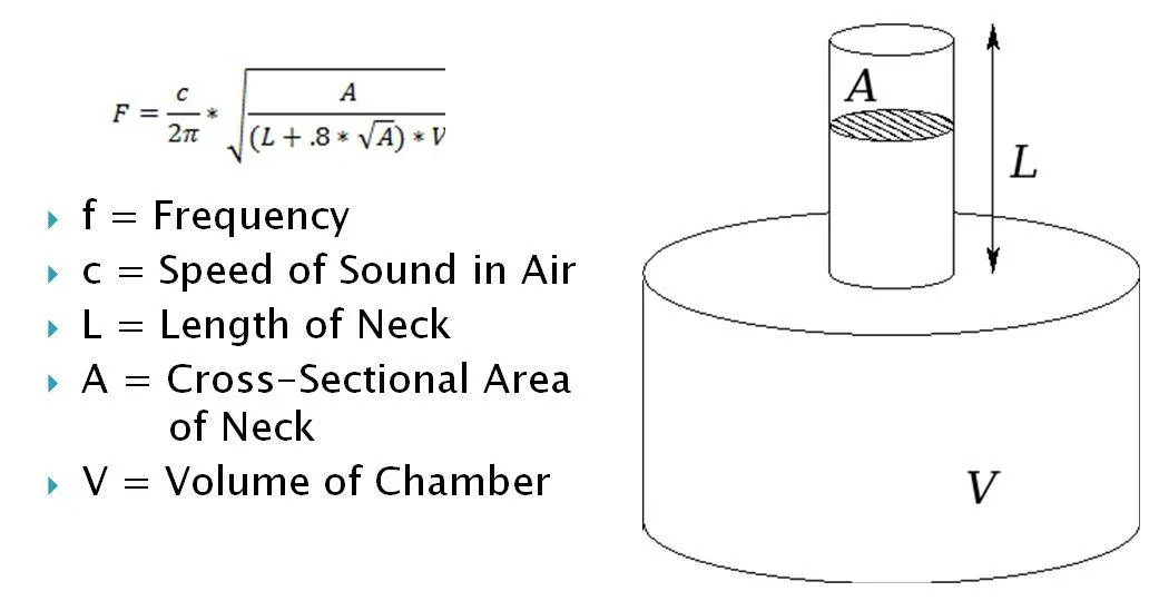

This forum needs more info like this on here. Really if you want a loud, non-muffler exhaust that isn't frequency tuned, without drone then Helmholtz resonators are the way to go. The only cons to them is slight increase in weight, a small reduction in volume under the drone frequency, and size of packaging. If you are a DIY then find out the RPM and frequency that it is droning at and then use the attached formula. I would only recommend that you try to locate the resonators as far upstream as possible.
These do work packaging is always a problem. People use them in the rear because there's a lot of space there and sometimes it's really only needed at the muffler. I agree it would be optimal further upstream but LTH, Thermal, Solo, and MBRP all have them in the rear and I'm sure it isn't a coincidence.
