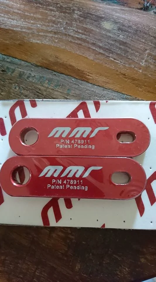

MMR Lockouts arrived. Getting more and more ready for custom tune.
Tracking down boost issues on Sunday.

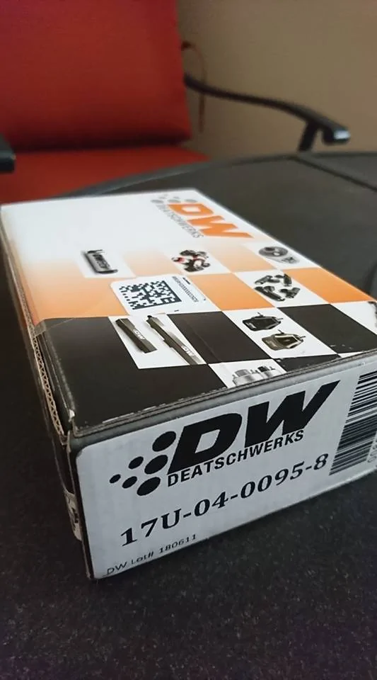

Placed an order for some DW 95lb injectors. Another shout out to Team Beefcake for always serving up the support!
Ticking off the checklist.

Injectors are here, Thanks Beefcake!

Out of curiosity, why the need for the larger injectors on the 2018? I was told by Procharger that even with my Stage 2 setup making 8.5lbs of boost, the stock port injectors are only at like 25% duty cycle because the DI is doing the heavy lifting. Not sure if you are turning the boost way up beyond the capabilities of stock port injectors? Thanks much!
Yes, upping the boost. Play it safe and make long term fuel decisions.
