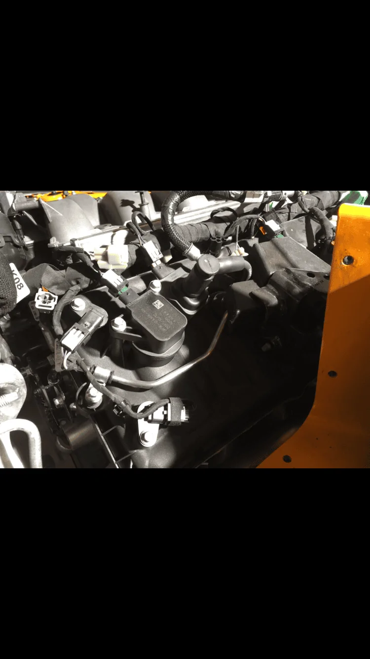

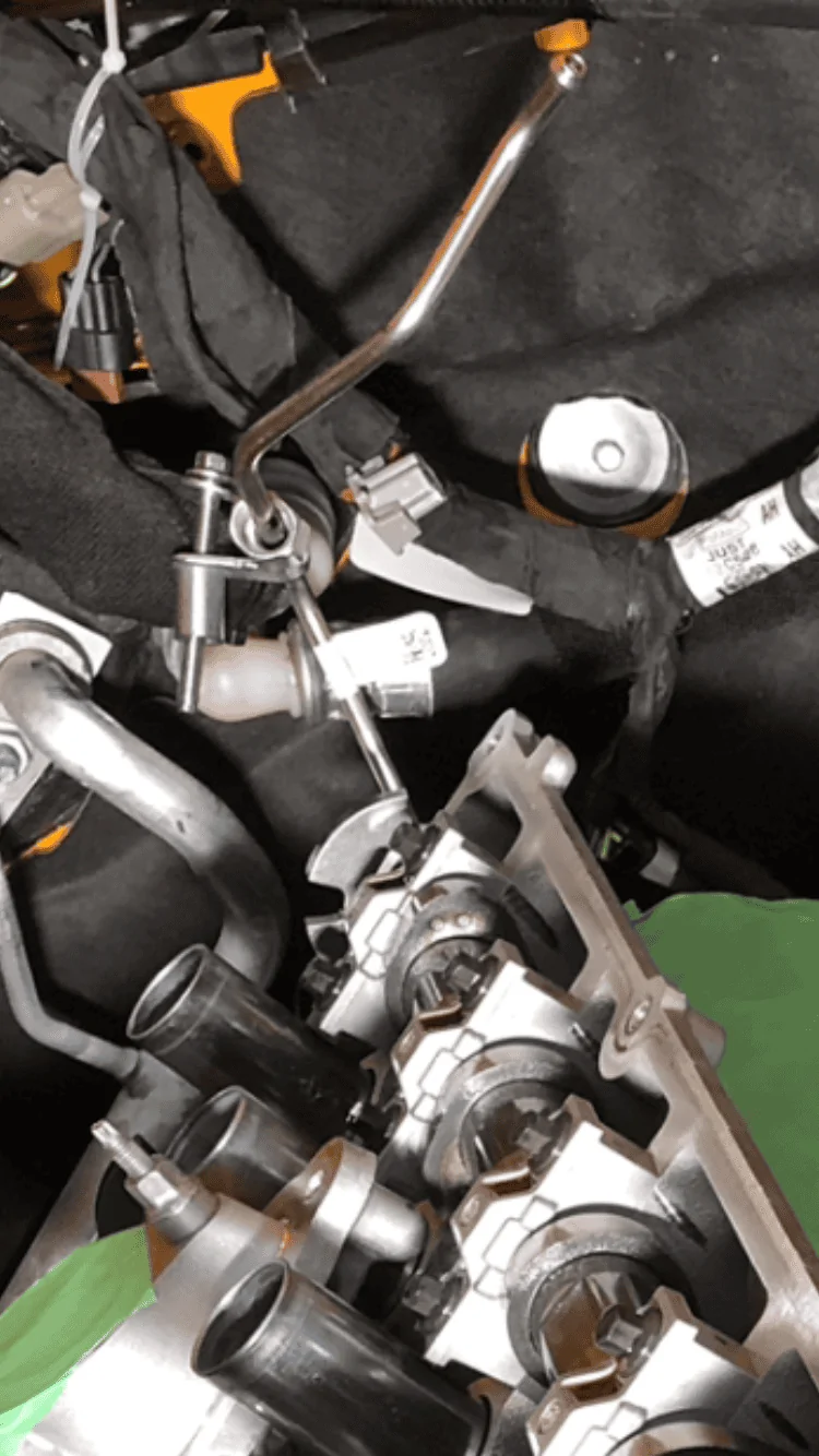

After just removing my manifold and doing OPG’s and CS I would say that yes you will have to remove the manifold to get at the supply line fitting to the injectors. I didn’t fully take off the supply line and the bracket that holds it behind the cylinder head since I do have intentions of reusing it. I simply loosened it from the DI pump and the Fitting under the manifold and rotated it back towards the firewall hanging in the bracket it rests in. Was more than enough room to take off the valve covers without it being in the way. I can however place the manifold back on to confirm tomorrow for sure if you need to take the manifold off to get the line loose. Here is a pic from battery tray location and another of how I left it hanging.

Perfect!
Thanks for the pictures and the PM about the balancer removal!
