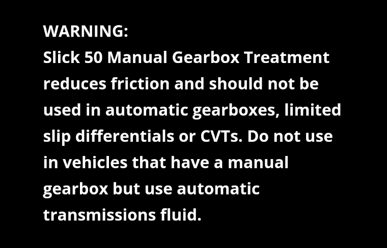

it would be interesting to pour a can of slick 50 into the diff to see if that decreases temps
Not at all sure how the differential's limited slip properties would be affected, no matter which kind of diff we're thinking about.

one time i poured some slick fifty thoughtlessly into a motorcycle crankcase forgetting it had a wet clutch. the clutch would slip under hard acceleration. had to drain it and put in new oil. so the stuff is pretty slippery. i suspect if you used it on a clutch pack lsd it would cause problems. but a torsen/quaif is gear operated and no clutch
plates so it might work.

yes i saw that
but it also says it can be used in an open diff
the only way it could cause a torsen to malfunction is if it dropped the friction so low that the spur gear could turn the worm gear which i think is unlikely. in any case its a quick and easy experiment with little downside. i would do it myself except i have clutch pack lsd. here is a link to a video explaining the torsen.

I'm pretty sure that the bias ratio would be affected. But I don't know by how much or even which way.
It may be possible to infer something if you can find information regarding the use vs non-use of normal limited slip additive in a Torsen. I suspect this would be easier to find than information regarding the use of Slick 50 in a Torsen directly.

it looks like from the video it would be an all or none phenomenon. either the spur gear could turn the worm gear or not. if it could not then we should be good.
as an aside, the torsen is really a beautiful piece of engineering. after i saw the video i wanted one.
it's impossible.
Bias ratio isn't the same thing as slip or the ability of the spur gear to turn the worm gear.
